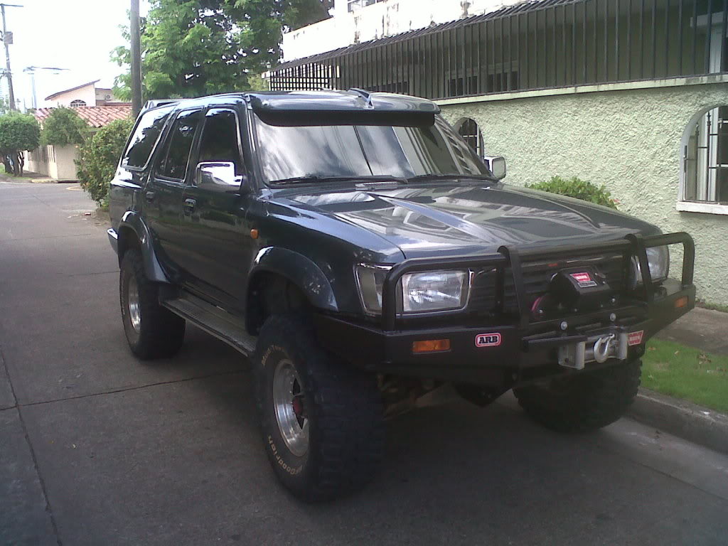

    here is my rig with ironman suspension 1.5 of lift
    Old Jan 11, 2012 | 01:17 PM
      #532
    abecedarian's Avatar
    Joined: Mar 2008
    Posts: 12,723
    Likes: 6
    From: Temecula Valley, CA
    You're supposed to lift the truck, not your pants.
