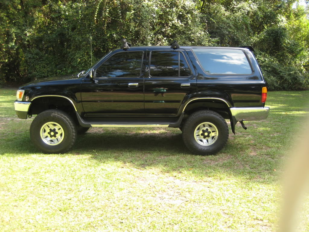

    my 92 4runner
    rough country 5'' suspension lift with 32'' falken wild peaks

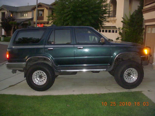

    Nice rides, here is mine , got it just stock with 31 bfg, I put a 3 inch bodylift and used air shocks to get rid of the butt sag, will do coils when I find them, I scored on some 315/16 bfg, they are huge, no cutting , no rubbing either with these monsters. I love it
