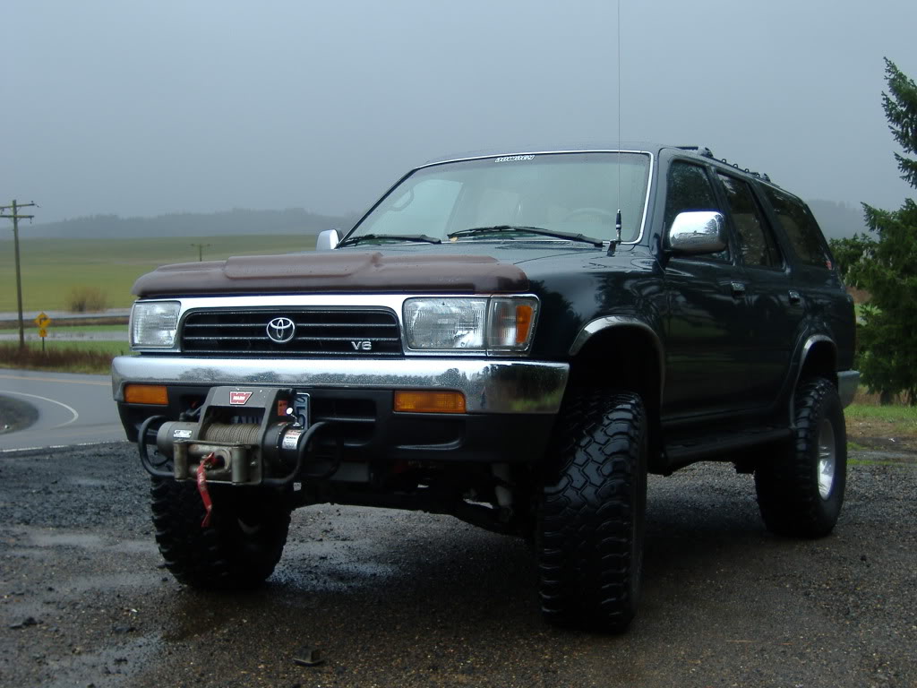

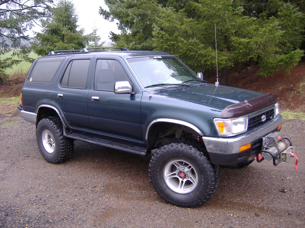

    Here is my 1994 4Runner. I bought New Downey HD 1.5" rear coils, 4Crawler Pan bar drop bracket, Sky Jacker Nitro shocks. For the front I used 4Crawler 1.5" Ball Joint Spacers with Downey Mega Travel Ball Joints, Diff Drop kit, Sway bar drop kit, Downey Torsion bars, Sky Jacker shocks and Sky Jacker Steering stabilizer. I run 33x12.5x15 BFG Mud Terrains on 15x8 wheels. I bought a Downey IFS bracket to tie in the rear side of the A arms, but it won't fit with the Diff drop kit so I am custom building a bracket to clear with the diff drop kit and adding a skid plate that will tie into the custom front receiver, so the skid will protect everything from the rear a arm to the valance. If anybody is interested I can take photos of the build and I could fab up some brackets and skid plates as well. Just Pm me if your interested.
