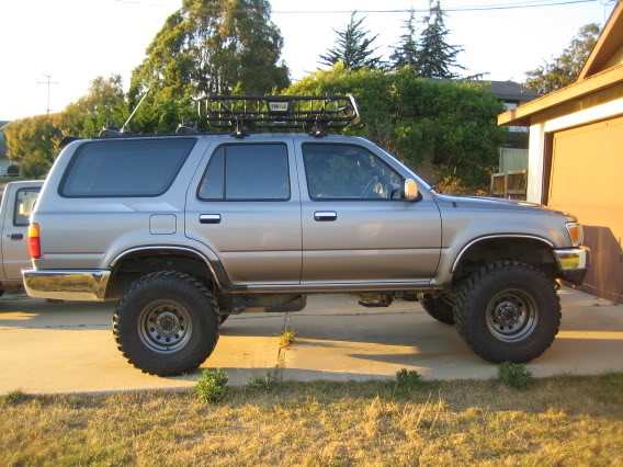

    OK. So tell me if I've got this right. This is pretty much the setup/height/tire/etc combo that I'm after. This is a daily driver for me, so I'm not going after anything more extreme than this
    I need:
    FJ80 rear coils
    1.5" ball joint spacers
    ProComp ES9000 shocks (part #: Front 917514 and Rear 922506 )
    I'm open to suggestions on this, of course But this will be mostly for occasional trips up north and some muddy/rutted trails. No rock crawling or anything hardcore. Just looking to fit 33x12.5s and get a bit more ground clearance. I'm thinking about a small 1" bodylift as well.
    Also, I see people mentioning that if you get a "set" of FJ80 coils, that one side is 1/4" shorter. Can you just order two left or two right side coils from the dealer? Or do they only come as sets?
