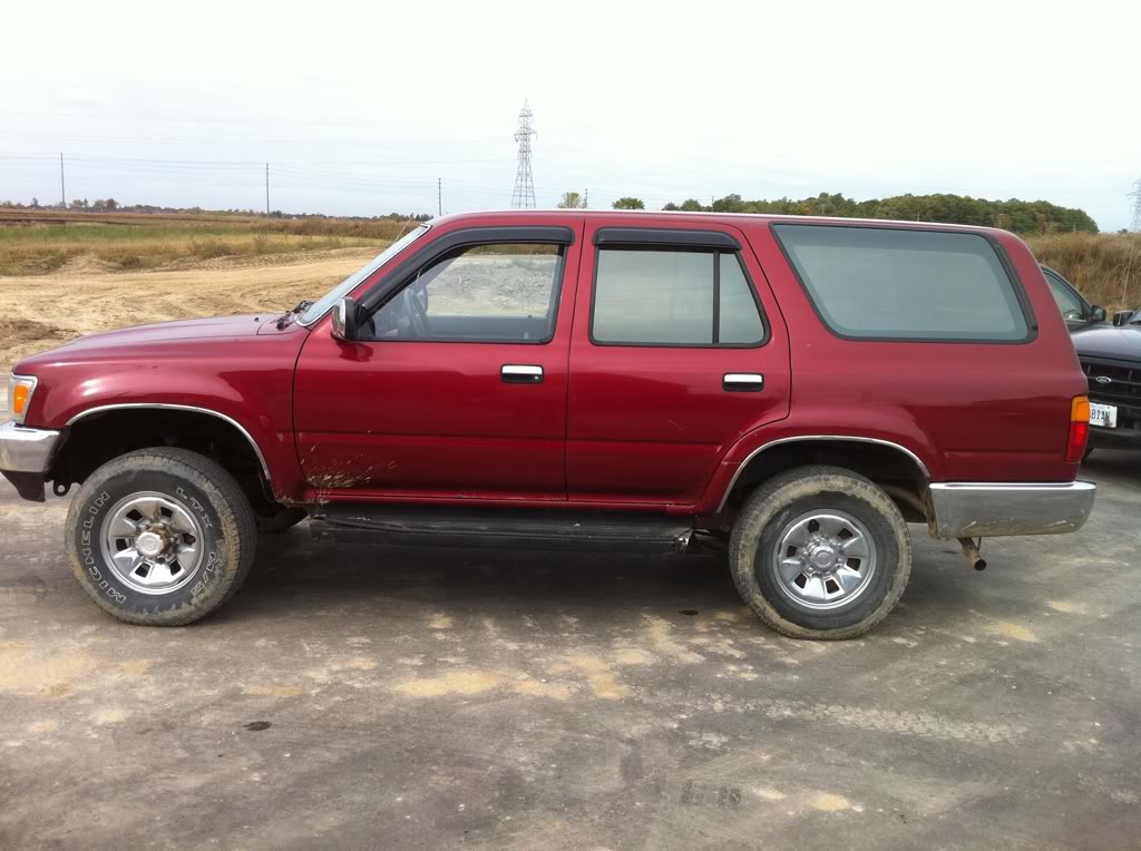

    That was a factory option back in the day, 31" tire option, so it'll look pretty much stock. I think this 2nd gen has maybe 31" or 32" tires:

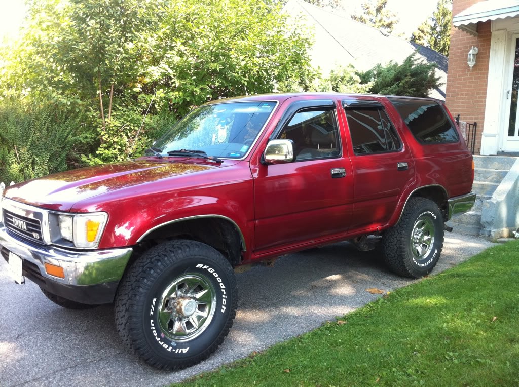

    OK, got my truck bak Thursday here are before and after pics.
    BEFORE:Name:  8769f568.jpg
    AFTER:Name:  1a0707ee.jpg
    So I wanna do shocks and coils for the back, but I don't wanna waste my time looking for the coils everyone talks about off an old land crusier . What are my other options ? For shocks and coils for rear

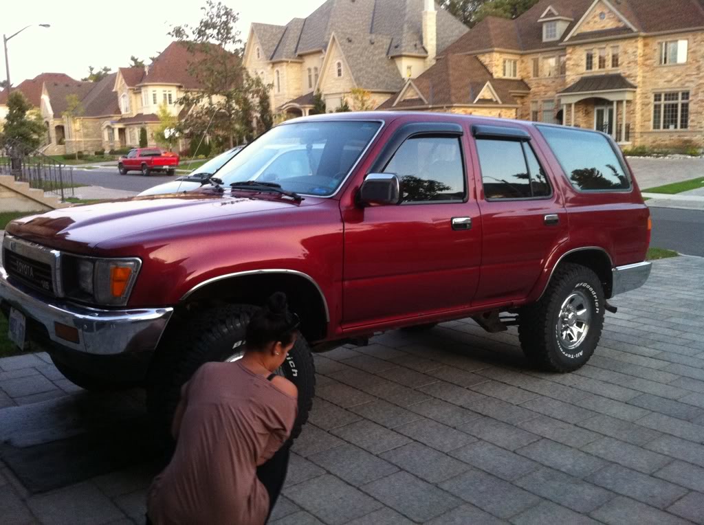

    AFTER:
    Sorry posted. Wrong link in previous post
