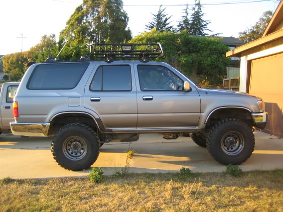

    1.5 inch ball joint spacers with land cruiser coils, with 33x10.50 tires

    thanks. with the "option 3" you were talkin about, would i need to do anything to the leaf springs?
    if you have a 95 4runner, you should not have leaf springs, i think you ment shocks, and yes you should get some procomp ES9000s
