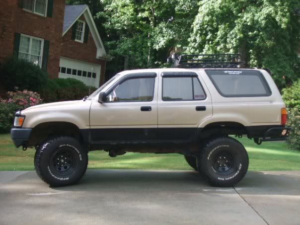

    Originally Posted by 934rnr
    Thought I would add my old 4 runner
    This how it sat on 33's with cruiser coils 1.5" ball joint spacers and a 1.5" Body-lift.
    It was a fairly good combo and rubbing became a non issue with the body-lift
    flex in the front wasn't too bad or down travel with ball spacers.
    My old site for ref: http://www.cardomain.com/id/934rnr
    Very informational thread!
    This is the exact look I am going for Herculiner and all...now I know whose set up to copy

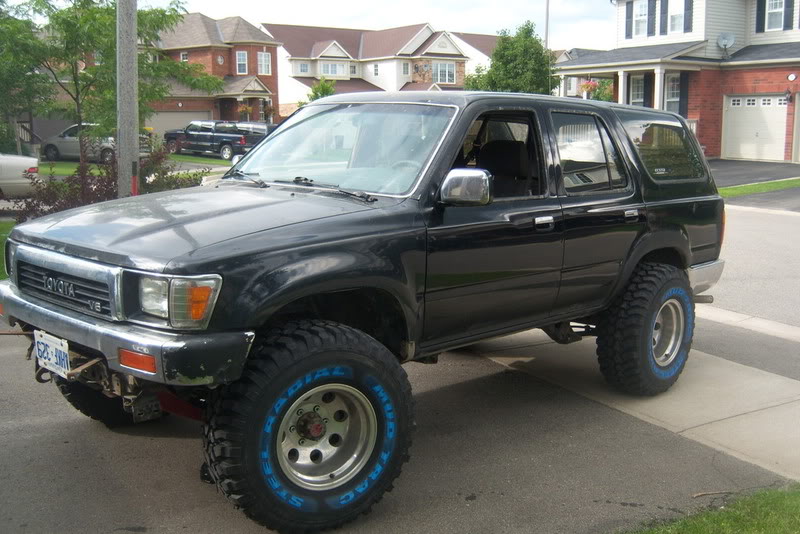

    First off let me explain that you do not need a lift kit to fit 33x10.50 or 33x12.50. the 10.50 will fit with no rub at all, while the 12.50 will fit with some rub, backspacing will help take care of that rub
    example:
    ]So is this picture of a 4runner with no lift and 33x12.50's. how much rubbing is there? do you notice it with just daily driving or just when you're doing really tight turns?
    thanks

    Originally Posted by SR5
    ^^thanx..
    and the painted bottom is comon a few other guys on here have it, not sure who, but im sure you can find them
    Rig looks good man, always liked the look of the red 4runners and I've got herculiner on the rockers, i've thought about doing the lips of the fenders like you did too.
    1" BL, bj spacers and Old Man Emu Coils with 33x12.50 BFGs. Minor rub on the pinch weld before bj spacers, I just ended up pounding the pinch weld and hitting it with some duplicolor bedliner paint to cover it up and protect it from rust. No rub now.

    is it possible to get the specs on the rims of the very first pic in this thread? If anyone happens to know.
    ..this one for you lazy people.
    thanks[/QUOTE]
    This one has no lift and 33x12.50's. When i did my cruiser coil/ BJ spacer lift, with just the BJ spacers and no torsion bar lift it rubbed when turing fully. Instead of adjusting the torsion bars i beat and cut the pinch and eliminated rubbing. When I drive on the streets it does not rub, but when I start flexing and what not offroad it occasionally rubs but I don't find it to be much of a problem.

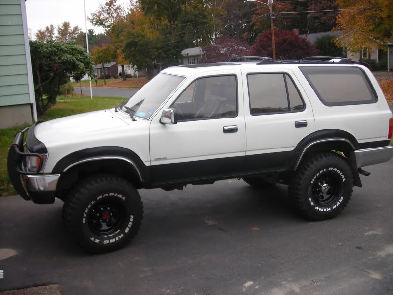

    Here is my 1995 4runner with BJ Spacers and cruiser coils
    Old Nov 18, 2008 | 04:45 PM
    Ever thought about taking the chrome trim off of the fenders, I think it would make the black on white look really good, either way i like your truck.
    Old Nov 18, 2008 | 04:52 PM
      #95
    tman12345's Avatar
    Joined: Feb 2008
    Posts: 212
    From: Western, MA
    yea, the chrome is actually only on that side, i put it back on because when i grinded off the rust and bondoed that side, it came out a little rough on the fender edges. so i put the chrome on, but i plan on getting fender flares in the near future so...
