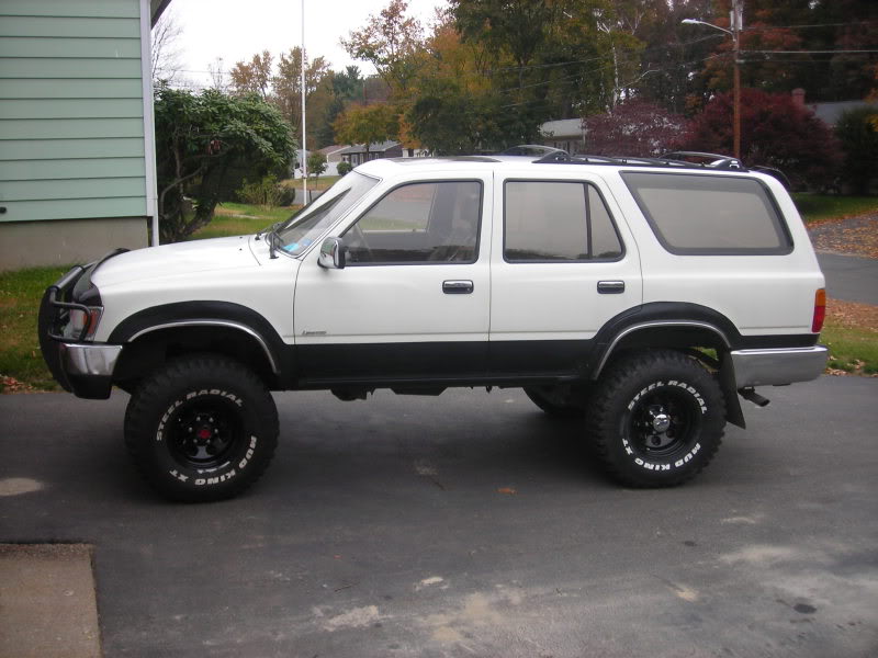

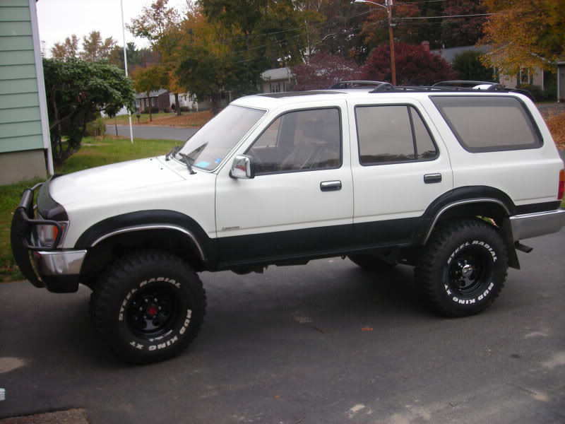

    i guess with the spacers it would probably be like that depending on how much yours sag. The cruiser coils i'm pretty sure all give around the same amount of lift. the 1 inch difference is pretty much unnoticable unless you point it out. this is what mine looks like.

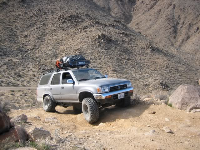

    i don't know why but that one it looks like its lower in the back, but it's not
    another one
