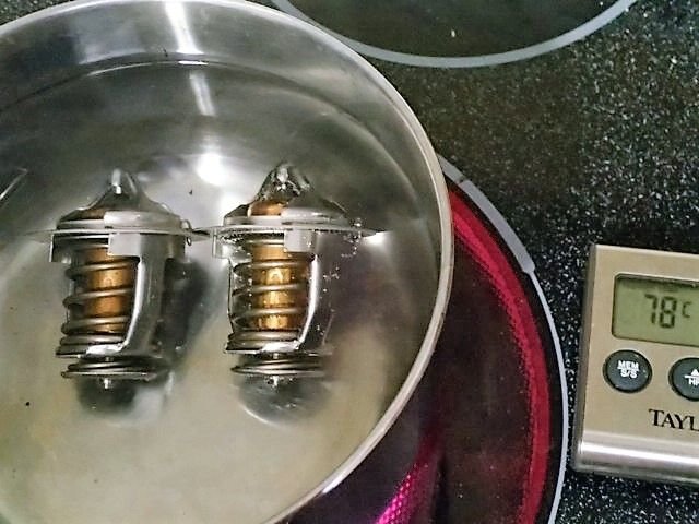

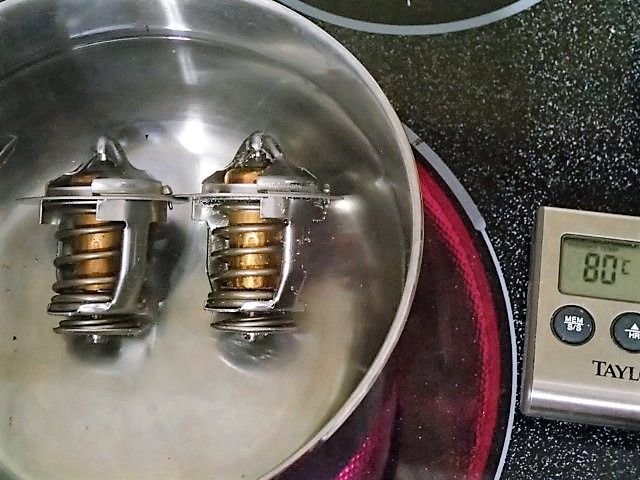

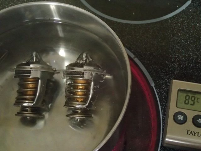

This morning I pulled the thermostat and tested a theory. I have a new one so curiosity struck again. Both are Toyota. Curious if it will run cooler with the new one...time for the jiggle valve chit-chat.
The old one on the left is dated 12/1995, same month and year the truck was built. In other words it's definitely original.
The new one on the right is dated 12/2016.
They both opened, the old one lagged a bit before it got a clue. The opening itself was relatively somewhat significant with the new one having the larger gap.

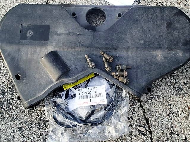

Some of those timing belt notes....
Gasket 11329-20010 for the #2 timing belt cover- this cover has 6 bolts.
Gasket 11319-20010 and 11328-20020 for the #1 timing belt cover- this cover has 4 bolts
The fat lip is the one you use the puller on. If you look close enough you'll see I learned that the hard way during timing belt change #2. That was a facepalm moment. On the plus side it's been working fine with no belt damage since then. It's a little embarrassing but I'm putting this up here because we all have those doh moments and if it helps someone avoid one then it's worth it.

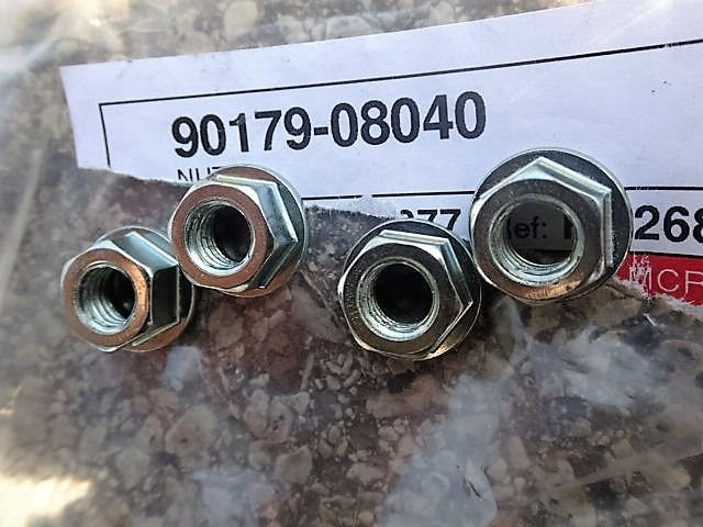

Fan nuts that hold the fan and pulleys on. 90179-08040, mine were a little beat up so got a fresh set.

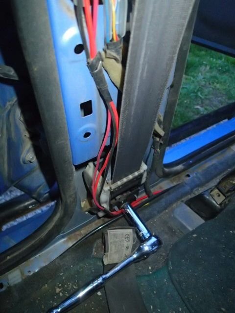

Had some daylight left over so got started on the next project, replacing the driver's seat belt. Sure, I'd like to replace them all but at $150, yeah, nope.
Part# 73220-35272-B0Belt & Retractor, LEFT
This is not for the newer 3rd gens, only for the 96 and 97, I believe. It's blue-grey.
IIRC the newer belts have a small charge that tightens the quickly during an accident, a pre-tensioner. The older trucks don't so I have no worries in that department. If your truck is newer/ has the pre-tensioner you probably need to find out if there's anything special to do.
Simple enough.
Remove the front and back door sills, unbolt and pop straight up to get off.
The pillar cover pops off, you can see the 3 popper thingies...
Unbolt the retractor, 14mm
Now for the shoulder adjuster. Push the adjuster button in, insert something to separate cover (I used very small flat screwdriver blade), pop off. Mine separated pretty easily.
The separated parts, bolt can now be seen. 14mm socket.
And there's a bolt on the floor too, another 14mm bolt head. Sorry the pic isn't the greatest.
Floor and retractor bolts are the same, the big one is for the shoulder adjuster. All have a 14mm head. All will be torqued to 30 ft lbs when installed.
