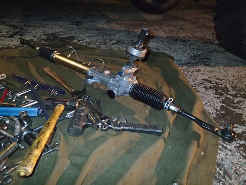

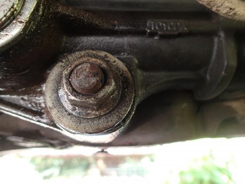

Time to unbolt the steering rack. 2 nuts, 2 bolts, 3 mounting spots.
Right to Left (passenger to driver)
This is one nut and one bolt on a horse-shoe shaped mount- save that rubber bushing, you'll still need it (or have a replacement available):
The center one unbolts from the top. the nut is tacked on (mine is not, but that's another story).
The driver's side is a nut that unscrews, then the long bolt comes out from the other side and slides just under the diff. I usually use a screwdriver or something to tap it out of the rack.

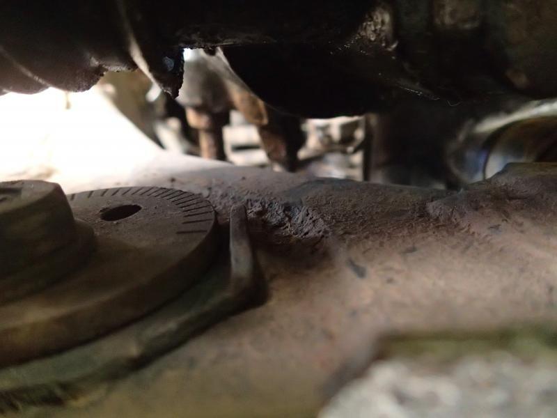

You aren't done yet. The blankety-blank power steering lines must be removed.
Looking up on the driver's side, between the back of the rack (towards the front of the truck) and the cross member. You can see the lower control arm bolt in the foreground. Look for the 2 blurry lines at the upper mid part of the picture. I loosened the rack and used a bungy to hold it up-ish so I could gain a little more room. The rack is also resting on the center mount. Oh, what a bear this can be, even when they aren't rusted on. Yay me, mine were not. A 17mm flare wrench is very useful here. The nuts are at different angles (refer to your new rack and you'll see) that make it very hard to fit the wrench in and on the nut. It can be done.
Fluid will come out of the lines, have a pan ready.
Get that sucker out of there!
Center the new rack (this one had two useful marks on the rubber dust boot by the splined shaft that helped center it perfectly once it was darned close.
Mark and remove the outer tie rod ends (this one came with inners). Count turns to help get them on the new rack as close as possible. I was able to remove them by putting a wrench on the flat side of the tie rod and one on the hex at the end of the rack. The lock nuts stayed put as the tie rod end came off and I had only to screw the tie-rods into the new rack up to the lock nuts, careful not to let them turn. It worked great for me...
I also put the rag joint on (the aluminum thing in the middle of it is a spacer for the 1" body lift) and that's where I should have left it hanging on the steering shaft. I did end up pulling it back off, making sure the steering wheel was straight and putting it back on the steering shaft in a way that allowed me to reach both upper and lower bolts. I tightened the upper bolt and slid the rack up onto the lower part of the rag joint while maintaining the rack's shaft position and the straight steering wheel. It might have helped to have someone hold the wheel straight rather than rely on the bungee to hold it. Once I got everything lined up I loosely bolted the rack enough that it wouldn't fall out and got to work on those stinkin' power steering lines. After that was done I bolted the rack in and tightened the rag joint bolt too.
Once the rack was in tight I put in the sway bar, the front diff drops, and the tie rod ends. If they refuse to tighten use a jack to push up from underneath and they should hold still for you to get the castle nut on. Don't forget your cotter pins!
Add dex/merc to the reservoir and turn steering wheel back and forth, checking on the fluid level.
I should have flushed it first and need to learn how.
That's pretty much how I did it. Feel free to critique if there's something I could or should have done differently, as I said, I did it logically rather than knowingly.

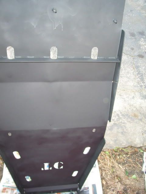

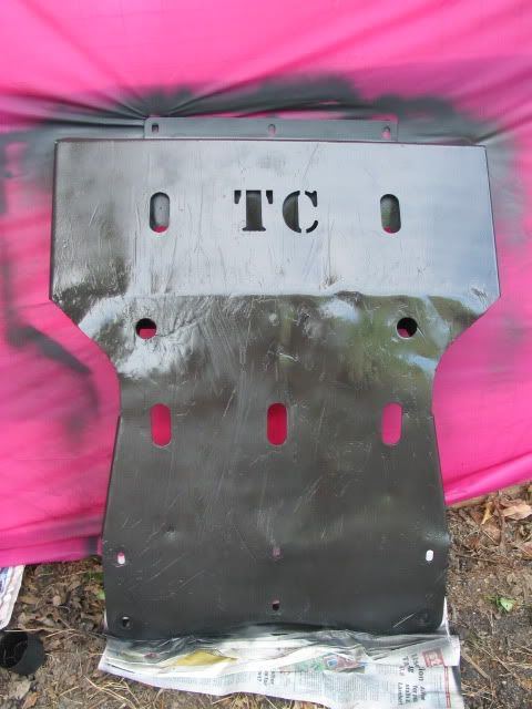

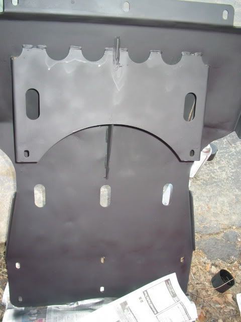

Habanero, which skid plates do you have, and how far back do yours go underneath the 4Runner? Do you also have a gas tank skid? It would be awesome if you had access to a shop with proper tools with a press and brake and water jet and blast cabinet and welder and paint booth and powder coat, et al, as there's no telling what you would fabricate...!
Old Aug 10, 2014 | 06:42 PM
  #2110
habanero's Avatar
Joined: Sep 2005
Posts: 8,247
Likes: 497
From: mo
I'd fabricate scary stuff! Artistic scary stuff!
I have Trail Carnage skids that came off fellow forum member Amorphous' truck when it was totaled (thanks Aaron!). They go from front to the cross member in front of the gas tank. No longer made.
Front
Inner side of front
Rear (tapered side goes to the rear)
inner side of rear
No gas tank skid yet, no rear lower control arm skid. No rear diff or locker skid. No bumpers.
