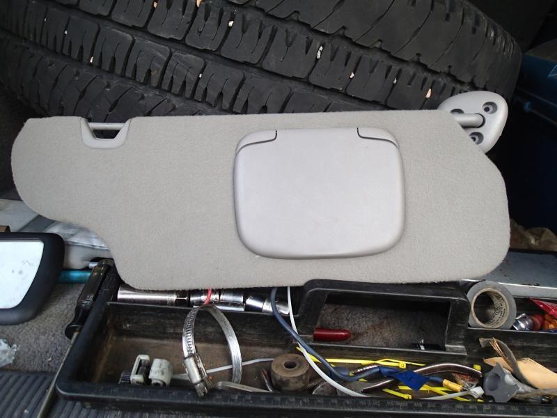

96 4Runner 262,xxx miles
Well here's a visor being modded. The 99 Ford Taurus is going away so free visors were available. Thought I'd see what could be done with them. They were not a great match- the post is too big for the 4Runner's plastic holder, it has to be trimmed to fit because it's too long- you get the picture. Lots. Down there.
Off the Taurus
Broke off Ford's mount:
Pulled out the catch thingy:
It's glued together cardboard. Gently pulled it open:
Pulled the spring out and trimmed off about an inch from the long end:

Measured a few times, jumped on the bed some. Gently pulled the material out of the way and cut off the end, made sure both sides matched:
Then trimmed the material, leaving enough to fold over and glue on later:

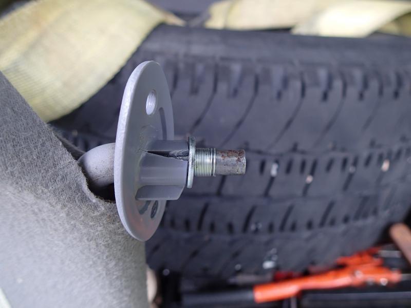

Unscrewed the 2 screws holding the 4Runner's visor in:
Took the plastic holder off for re-use on the Taurus visor:
Note: Both of the 4Runner's holders were split like this. It actually worked out good for me, the crack made sliding them onto the bigger Taurus visor post possible. I would have had to figure out a way to make the hole bigger otherwise. They are close, just not close enough:
Moved the spring over one notch. This makes it short enough that the 4Runner's catch will work with it:
Put the 4Runner's mount on the Taurus' post. Not a perfect fit. 'Luckily' the split was there and I was able to get it on, then a washer, and a tight fitting spring to hold it together until I can get to Ace to pick up a couple o' retaining clips of some sort.

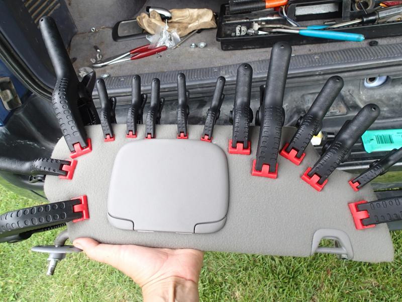

3M Weatherstrip Adhesive is great for this. I used it to glue the material to the cardboard and then the two sides of cardboard together. Next I made a porcupine out of it and let it dry. Heavy books or what-all would be fine:

And:
Will be interesting to see how it all holds up. The Ford's spring is bigger and springier and *should* stay in place better. How the split mounts hold we'll see.

Nice mod! She who dies with the most clamps wins! You win.

Clampbot is impressed.

Hey! It was a bag of them I got on clearance. I could not resist using all of them any more than.......than.......
well, than Clampbot.
I do win.
