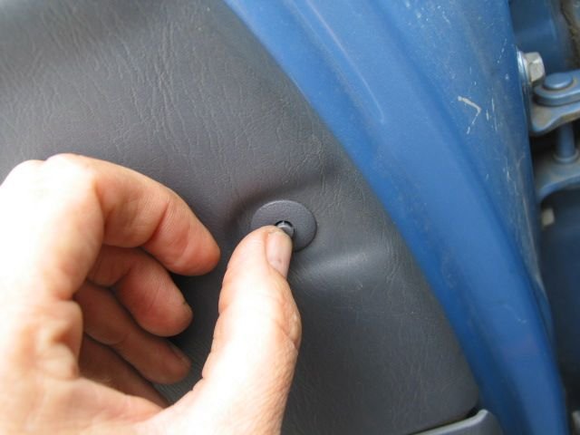

Pulling the door panel...
Push in the middle button on these clips. There are 2, one below the mirror and one on the edge of the panel below the lock button. Carefully pry out (should come out easy)
To get them back in later, just set so button is sticking out, put in place, push button flush. Not right now though.

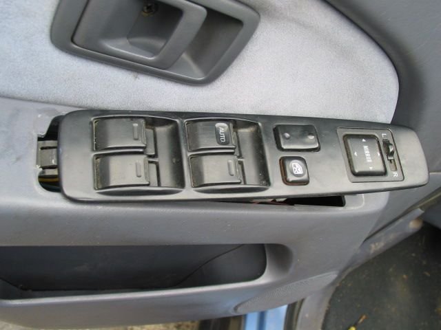

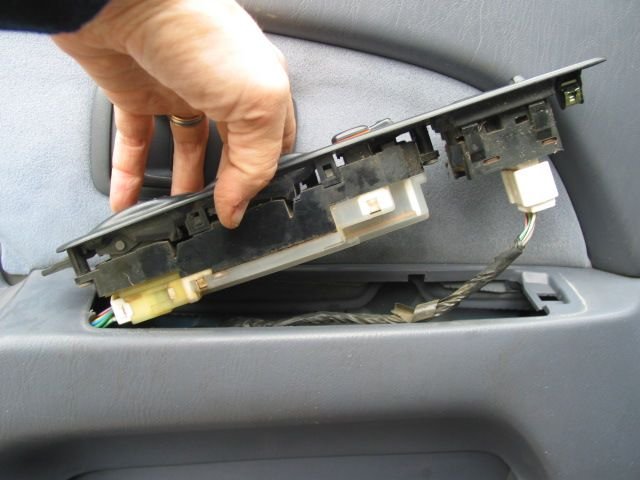

Lift straight up on the front of the control panel then pull forward to clear clip at back
Unplug 2 plugs and remove control panel

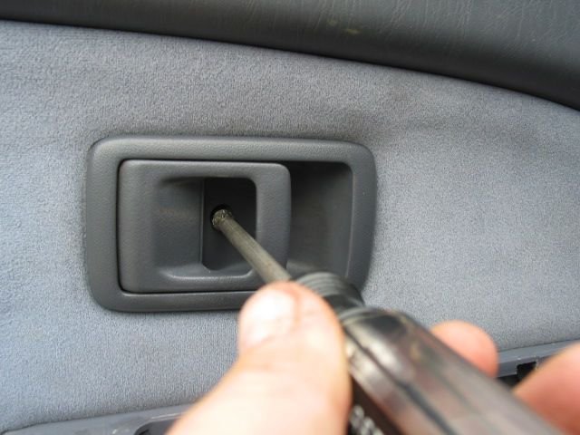

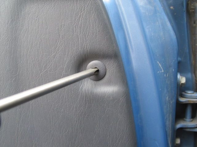

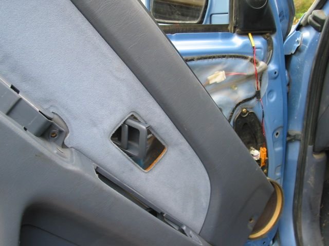

Unscrew here
Pull a little forward and out
The hooks you are clearing from the door

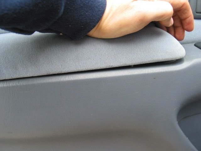

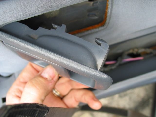

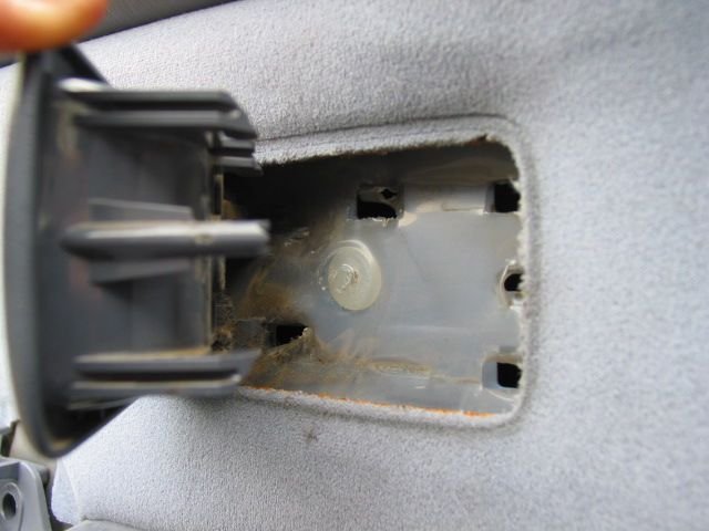

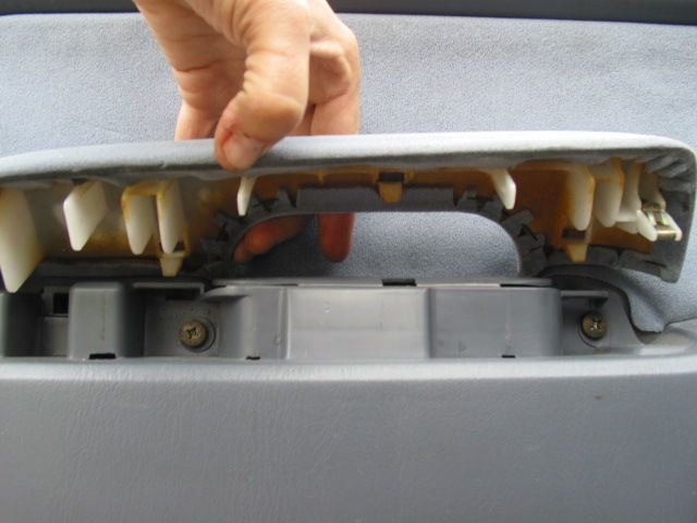

Pry straight up on arm rest.
Plastic ears and 2 metal clips hold the armrest in
Unscrew 2 screws that were hidden by arm rest.

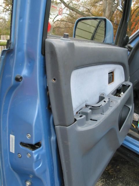

Pop door panel off door carefully.
Push up from the bottom to free panel from where it hangs on the window, then twist to clear the door opener.
Here are the 7 clips you are popping off (5 red and 2 white in this case, middle and bottom of door). If any stay with the door you need to carefully get them out and slide them into the keepers on the door panel. These clips are very annoying. They make a tool to help pop them off, but I was able to get these by hand.

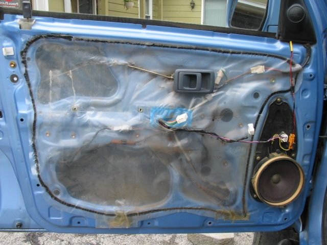

And here is what it looks like behind the door panel. The black gooey stuff that holds the plastic on allows it to be pulled off and re-squished on.
All I was doing today was cleaning up a gummy door latch. It wasn't wanting to close easily. I didn't really need to take the panel off to get it to work, but I really wanted to get back in there and I figured I'd show what's back in there while I was at it.
Funny, I cleaned the panel a little (pics are cleaned panel) and the dirt coming off the material part was staining the rag Moab red.
