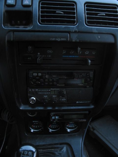

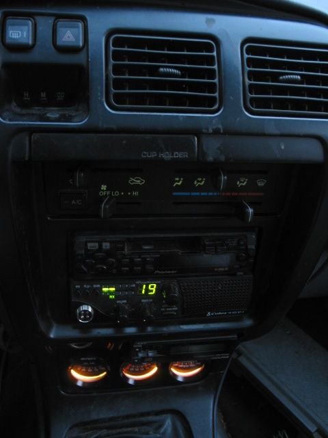

Cd thingy in using same screws/holes that held the ashtray thingy in:
I got the gauge set in there with minimal bending. Used the ash tray light wiring for the gauge wiring. Two screws under the lighter socket holds the set in. We'll see if it can take the bumping. If not I'll make a better bracket.
And the problem. The gauges weren't made to be viewed from that angle so there's light showing where I don't want it. I've already got a plan to fix it though. Should be a pretty simple deal. The cb mic wire hides part of the oil gauge but I'm ok with that. I was really just going for the volt and coolant temp but sure don't mind having oil pressure too. It is a lot easier to see the gauge faces in person than it is in the photo.
Up next:
Rocker switch for the voltage gauge to switch between batteries and hooking the gauges up.
