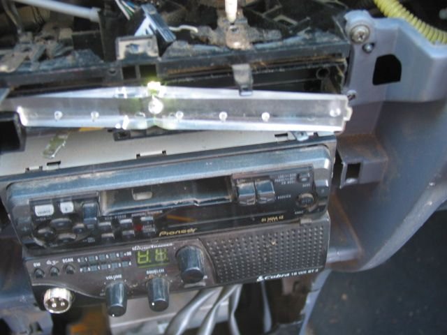

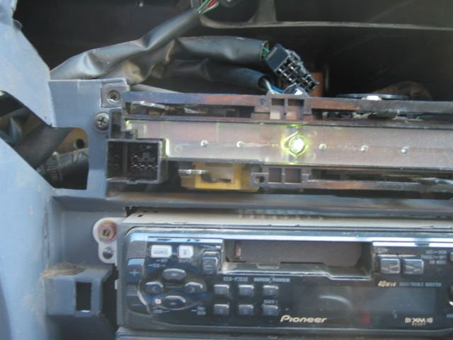

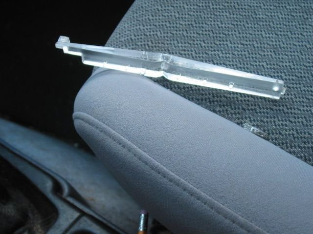

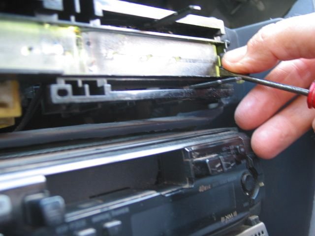

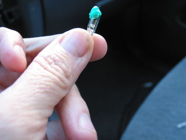

Coming up with a little different configuration with the cd changer. While had it apart I fixed the non-lighted climate control. The aftermarket bulb is a #74.
A quick how-to (after dash is apart):
Once you get down to the clear plastic doo-dad that is over the bulb, undo it. There is a plastic tab where my thumb is that you pull away from the lens while you gently pry the lens up with a small flat blade screw driver. Should require no force at all....
The lens you just removed...
Which exposes the single lonely little bulb socket. Pull bulb straight out....

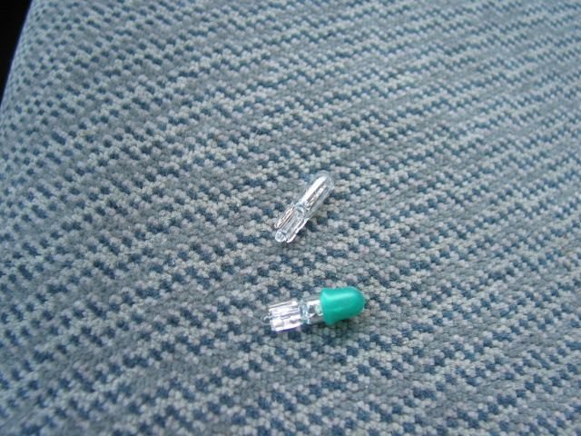

Here is the old bulb (green) next to the new bulb (clear)
Carefully roll the little green bulb condom off the old bulb. Roll onto new bulb.

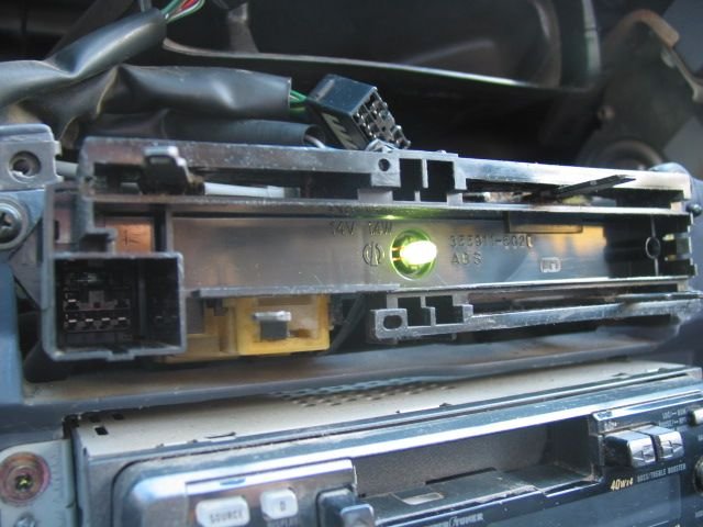

Test it before you put the whole mess back together. Success!
The lens keys into the driver's side and clips in on the passenger side...
And there you go. No more climate control roulette at night!

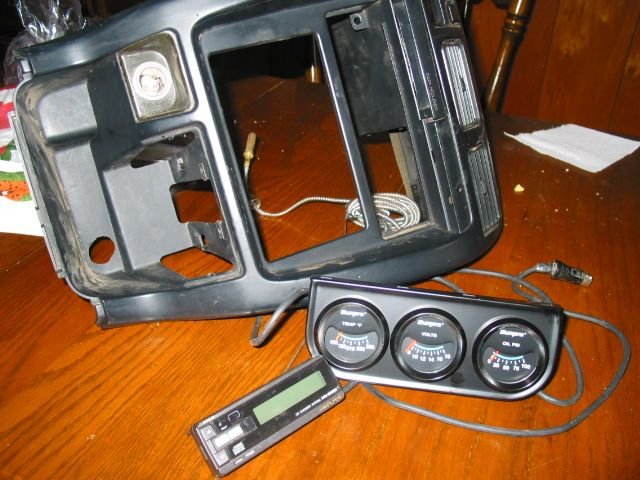

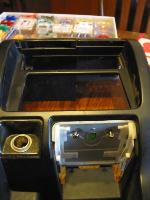

96 4Runner
Gauges and put cd changer controller thingy in a more permanent situation.
I don't smoke, I don't put change or anything in the ashtray and mostly it just annoys the heck out of me when I wheel and it keeps falling open.
So:
Take out the ashtray, then the slide/support thingy.
Which leaves you with this:
Here's what's going in. You think I would've at least cleared the crumbs off the table. Sheesh.
