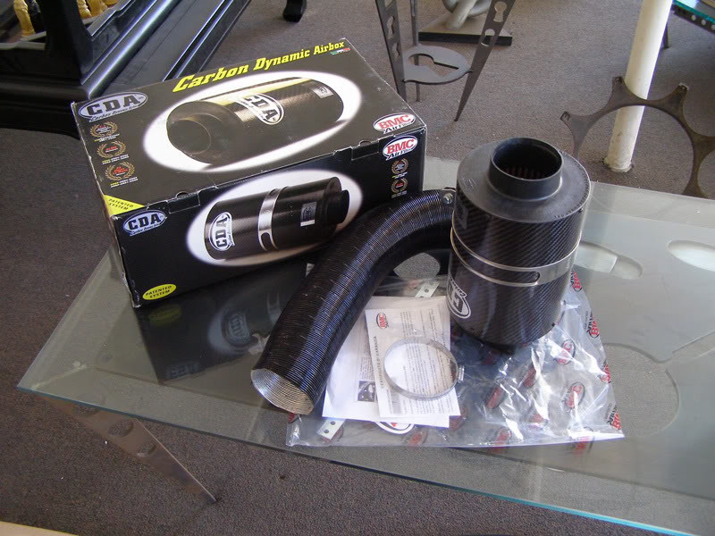

Still need to come up with an inline air filter or something that will fit under the truck before the turbo, these are cool but expensive.

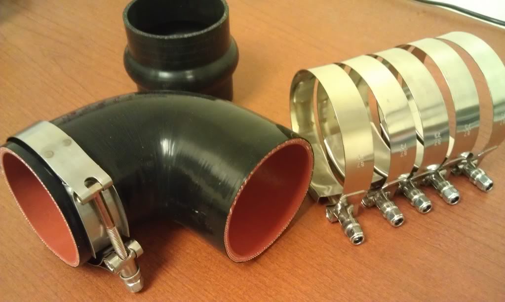

Some maybe snorkel parts...

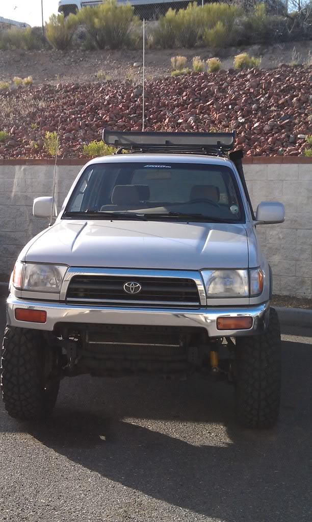

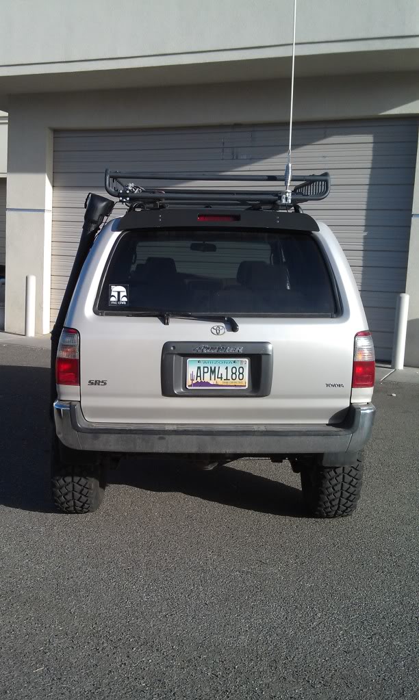

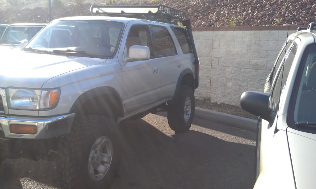

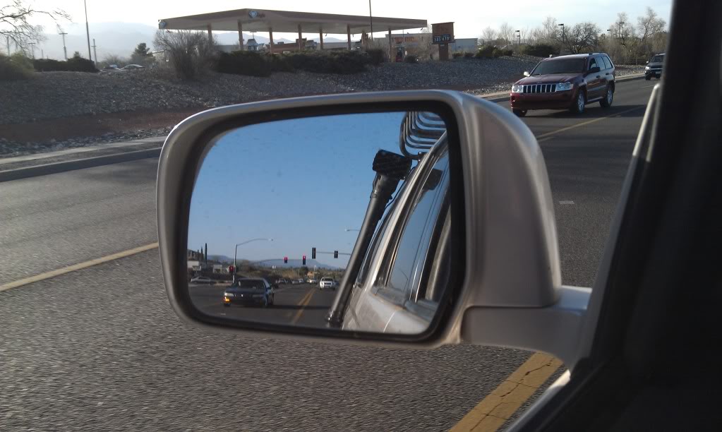

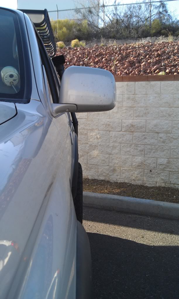

So I got the snorkel finished up. The 3" smashed down into a 2" oval so there isn't a view obstruction out the back and it doesn't even stick out past the fender flare. Made a nice solid mount attaching it to the roof rack so the window can't get broken if it ever did hit something.

Very nice looking, Gonna get a lot of questions about why the intake is at the back though lol.

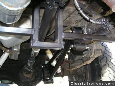

Great writeup! Absolutely love it! One thing that I would recommend would be a driveshaft hoop like the ones below though. I would hate to see all of your hard work destroyed by something as simple as a faulty u-joint! Most anyone who wheels has been through that experience before. Although in your case, it may not be as easy as letting your front driveshaft limp you off the trail. The catastrophic nature of a jumping driveshaft would likely obliterate your turbo. Just a thought! They can easily be set up with leftovers, pipe bender, heat, etc.!

Just read the whole thread again, so awesome! However I am really confused as to why the snorkel is on the drivers side... I'm sure your answer will make me face-palm it real hard...
Old Mar 29, 2012 | 02:20 PM
  #271
Clownmeat's Avatar
Joined: Jun 2011
Posts: 333
From: Arizona
The exhaust took up most of the room on the passenger side and I need some length and space to run a inline air filter.
