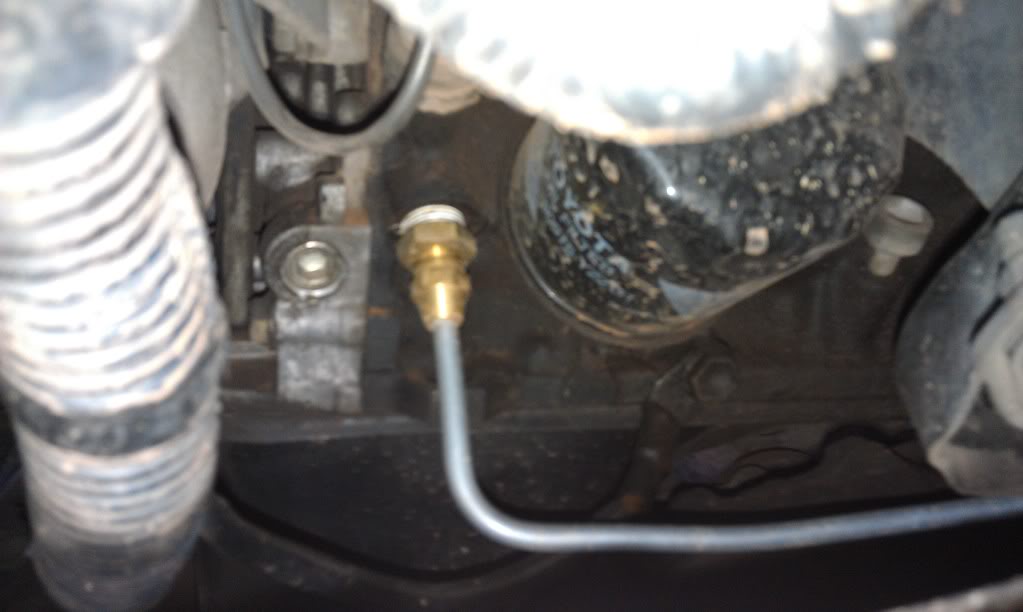

Clownmeat, can you post a pic and description of where/how you tapped for your oil supply? I know you mentioned it briefly earlier but a picture would really help.
Thanks.
Old Jan 6, 2012 | 08:44 AM
  #236
Clownmeat's Avatar
Joined: Jun 2011
Posts: 333
From: Arizona
This is where I put it just because it was NPT and I was driving it everyday and ACE hardware had the fitting for like $3. Where I put it is before the filter so the optimal place would probably be where the oil pressure sensor is, then it's after the filter. To do that you just need to buy a BSPT adapter, I use one from stealthmode performance on the Honda, it's really nice because it has 1 in and 2 out so you can screw your pressure sensor back in and run a feed line or another gauge or whatever.

Did you use hardline all the way to the turbo?
Old Jan 6, 2012 | 09:01 AM
  #238
Clownmeat's Avatar
Joined: Jun 2011
Posts: 333
From: Arizona
Yup, and all one piece too. Routed it just where I wanted it so rocks or anything couldn't get to it and used cushion clamps to secure it. Thought of using copper to make it easier, but went with steel for durability. Had to buy a nice double flaring tool that wasn't cheap and probably wont use again. If anything happened to that line out on an adventure, I would be dead in the water. Guess you could just buy a 12' steel braided hose if you were feeling lazy though.
Old Jan 6, 2012 | 09:08 AM
  #239
Texas_Ace's Avatar
Joined: Apr 2007
Posts: 4,932
From: DFW TEXAS BABY!
Nice, I have mixed feelings on hardline. It is great for something that will never be touched again.
For things that will have movement or could get damaged such as this, like you said, if something happens you are screwed.
I plan to tap into the same place, although most likely after the filter since I already have an adapter there for my pressure gauge.
Not sure what line I will use, most like just go with steel braided ran inside the frame rains like I did some other stuff.

Who you calling lazy? Hehe. I'm using a -4an and a braided line.
