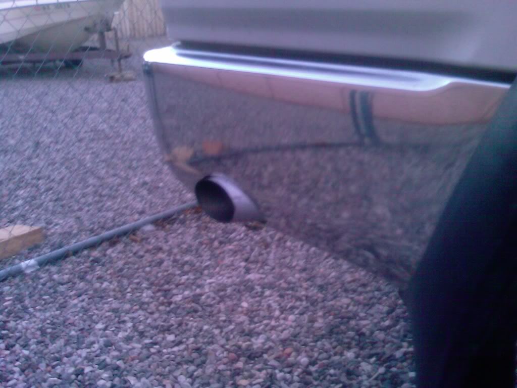

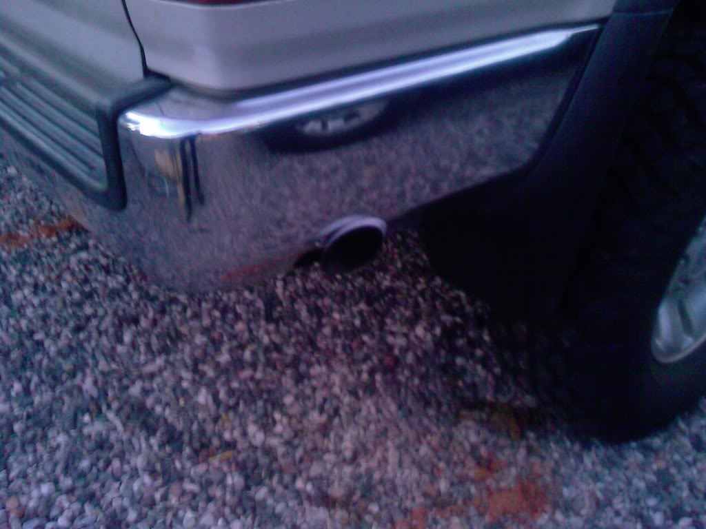

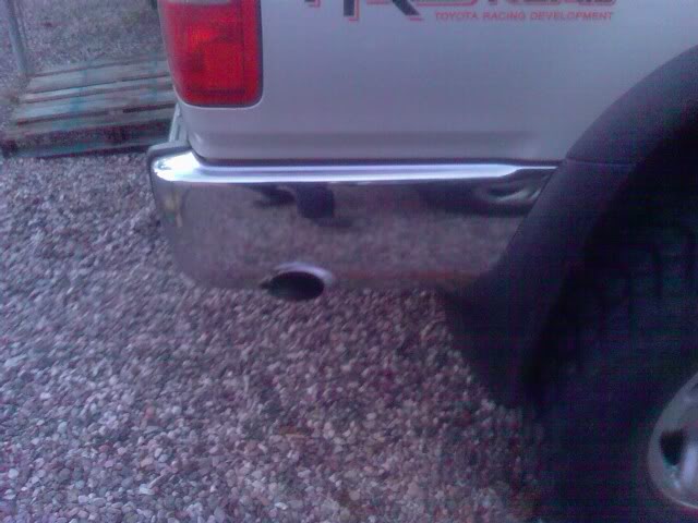

Got the hole cut and finished the exhaust.

Old Nov 16, 2011 | 04:13 PM
  #188
Texas_Ace's Avatar
Joined: Apr 2007
Posts: 4,932
From: DFW TEXAS BABY!
Looks good!

Very clean!
Just one question - the body/frame/exhaust all move independant of each other. How will your solution work without something breaking, etc.?
Andreas
Old Nov 16, 2011 | 04:33 PM
  #190
Clownmeat's Avatar
Joined: Jun 2011
Posts: 333
From: Arizona
The entire turbo setup and tailpipe is still on rubber hangers, should be just fine.
