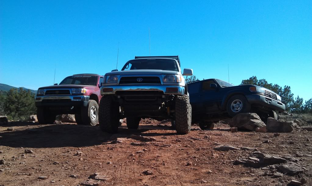

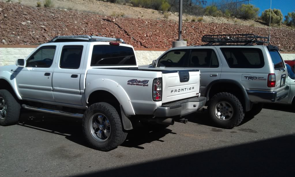

Here we are, the red 4runner was filming.

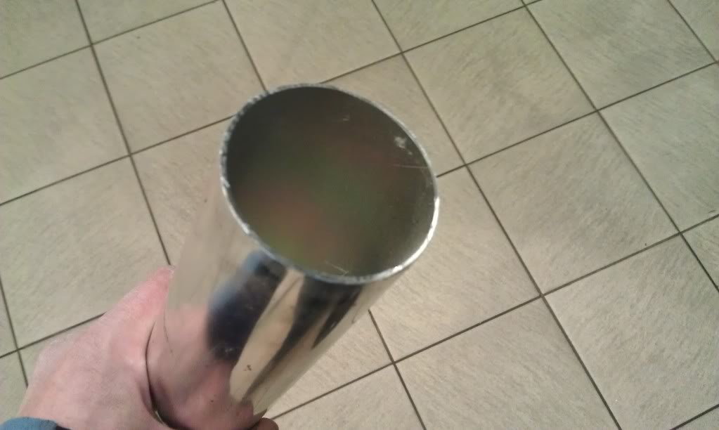

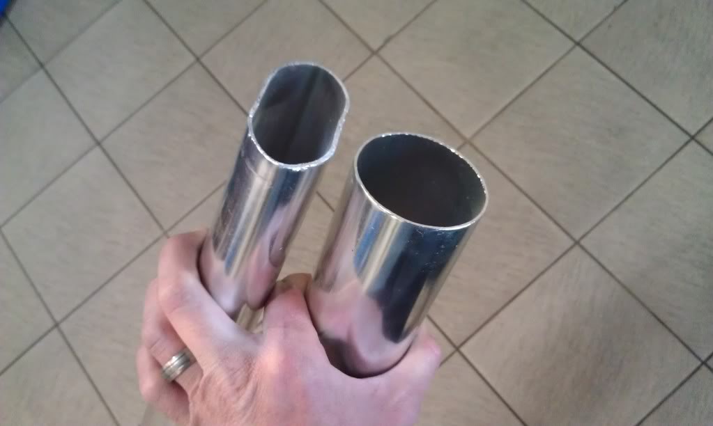

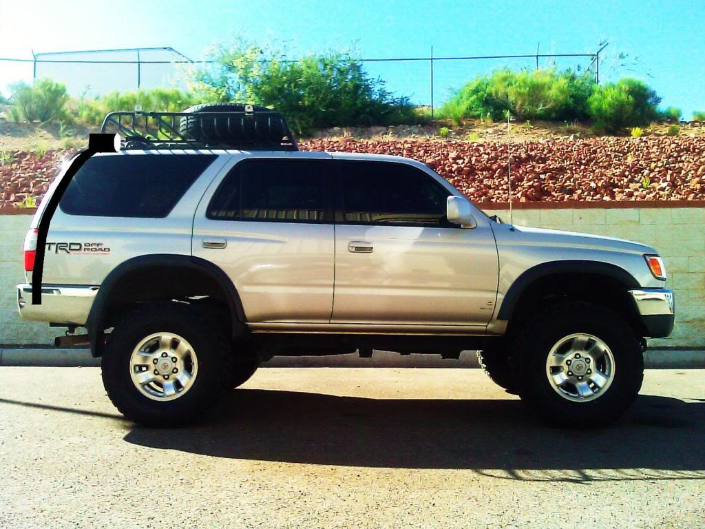

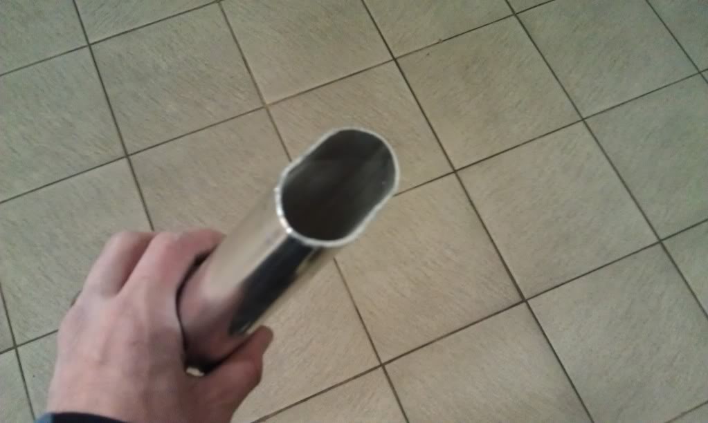

Now that the paddle shift is done I'm going to try and get back to getting my air inlet up higher before something bad happens. I can't just put 3" pipe up the side because I can't see anything out the side mirror. I found some oval pipe but it's ridiculously expensive and round to oval transitions are even more expensive, and it isn't even the material I want to use. I was bored today and may of found a way to make my own oval aluminum tube, tested it on some leftover intercooler pipe I had laying around.

Speaking seriously here, take that pipe thru the cab and up through the roof & put the filter inside ur spare tire on the roof. Done!!!
Thought about this before but I don't want to cut a big hole in the body if I don't have to.
