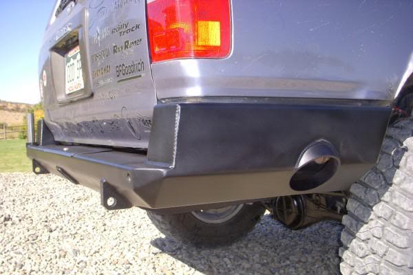

It's not very loud, sounds about as loud as my wife's 4runner which has a 40 series flowmaster, so no muffler for me. Just going to run the exhaust out around the factory location but will be higher up, probably out the side of the bumper I haven't built yet so it doesn't get smashed like my stock exhaust did.

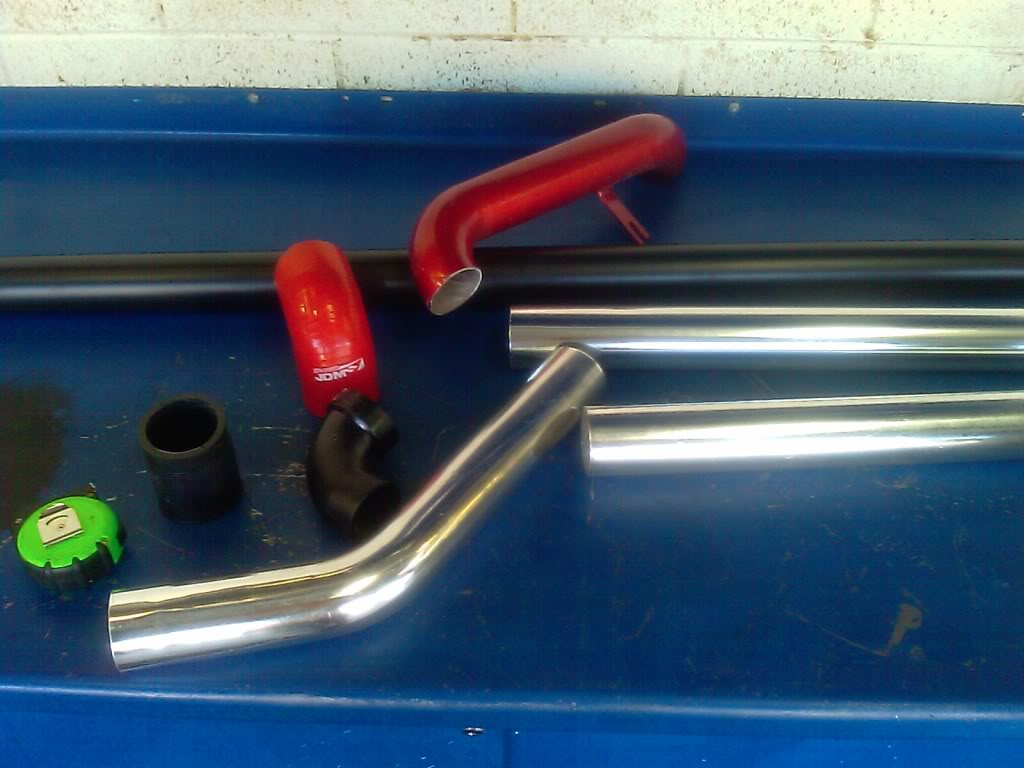

Rounded up some leftovers and went to home depot and spent $20 so I can start mocking up some charge pipes to see where they will fit. Getting kind of anxious at this point.

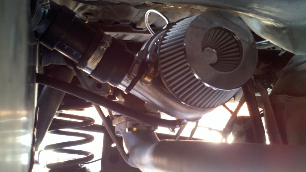

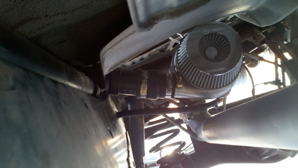

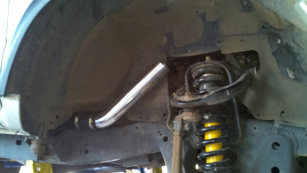

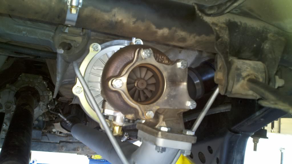

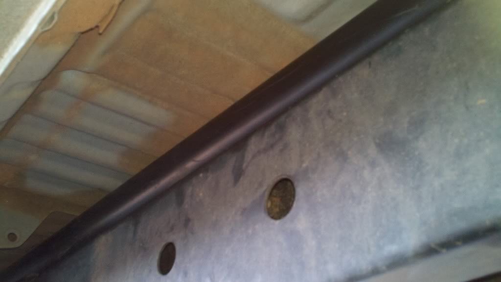

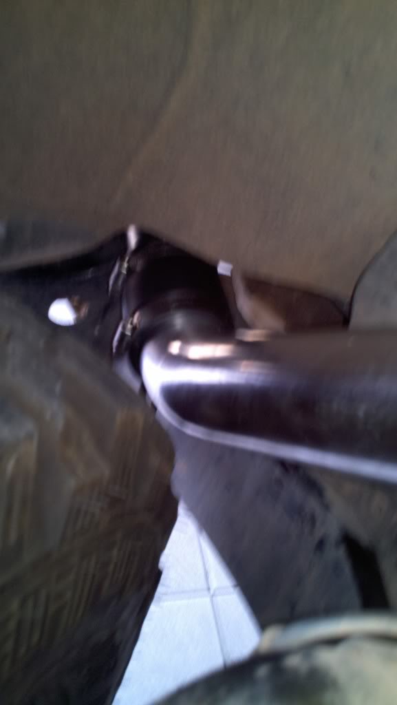

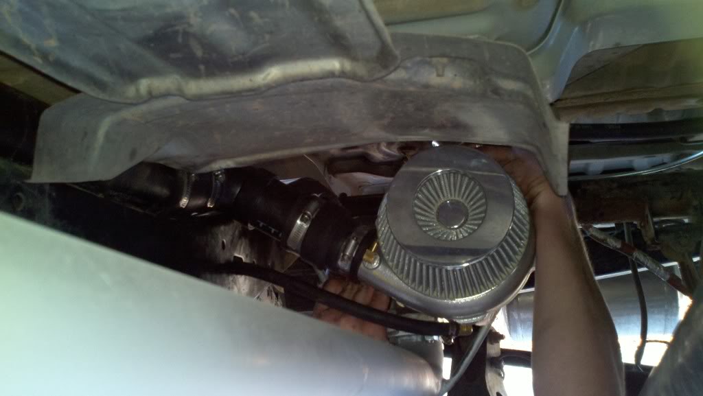

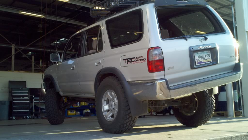

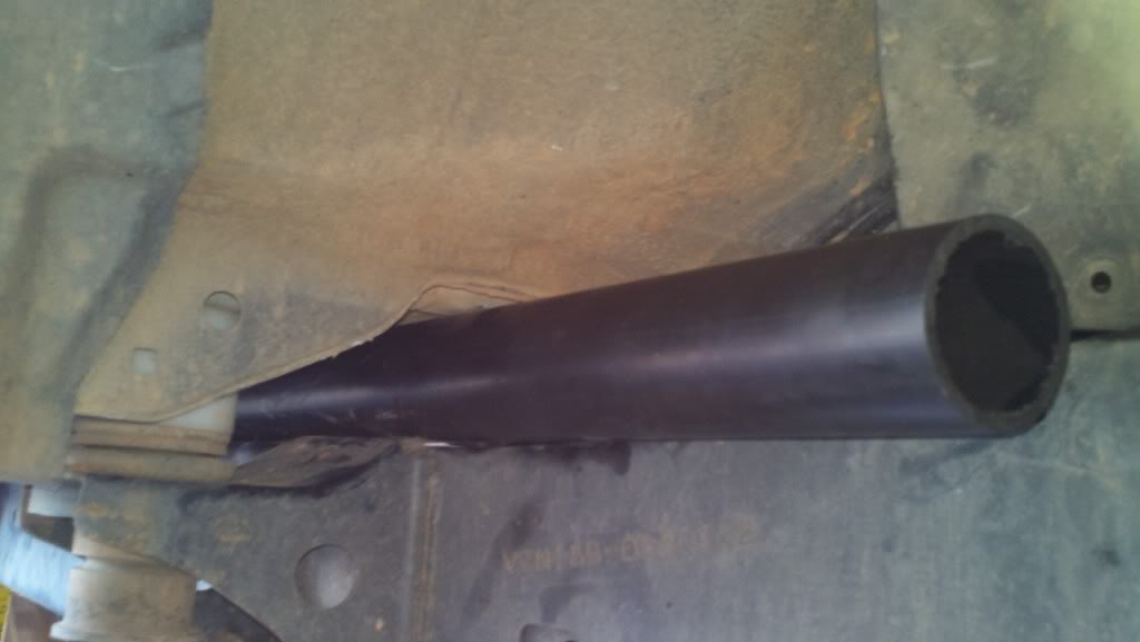

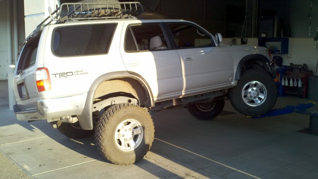

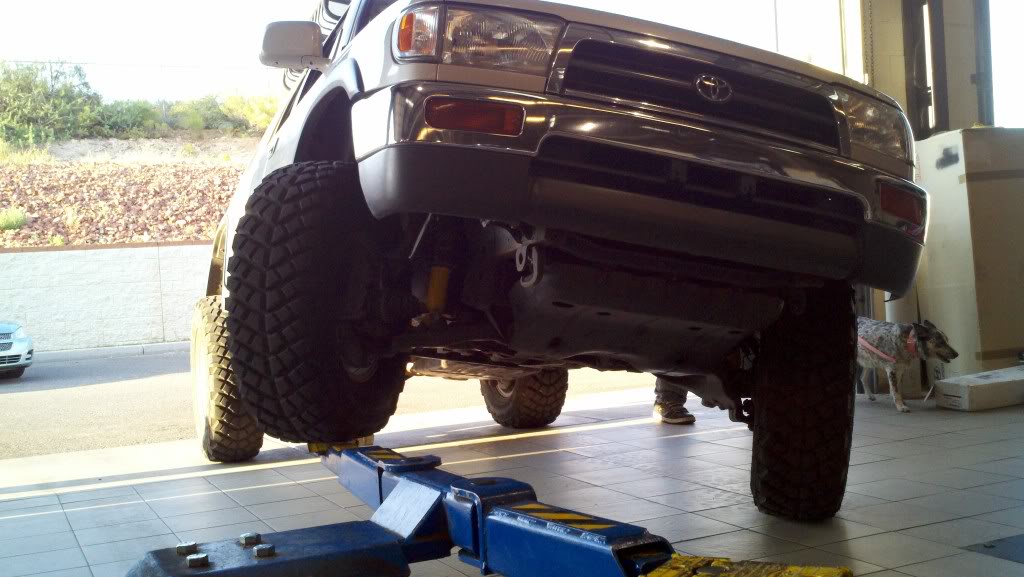

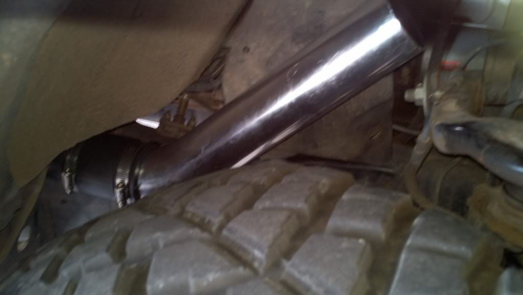

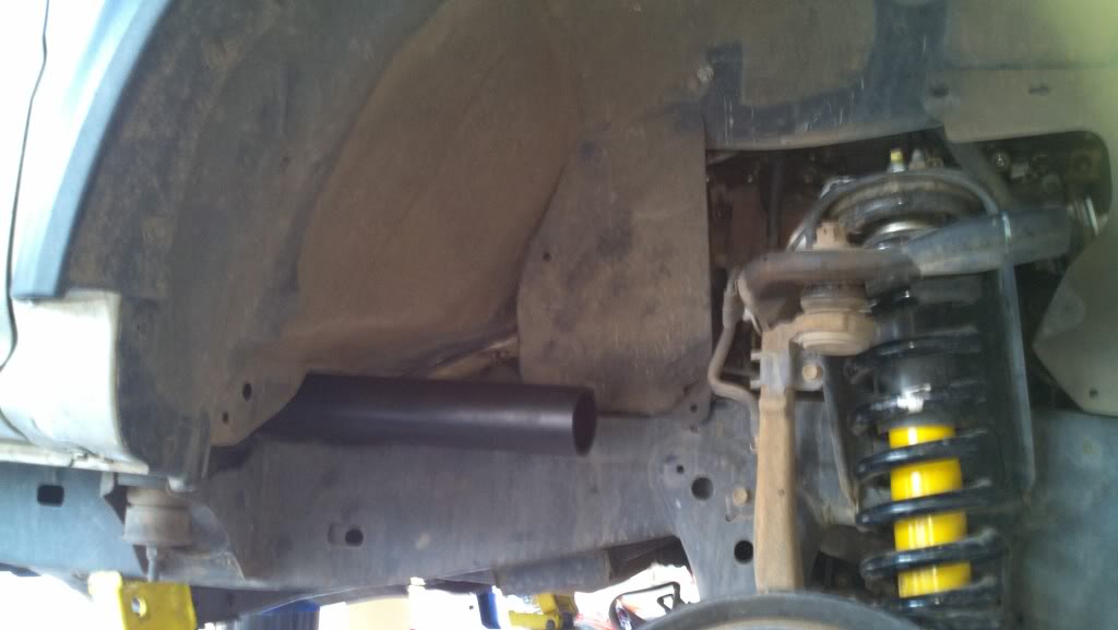

Had some free time today so I mocked up half the charge pipes. Fit perfect along the top of the frame because of the 2" body lift. Also didn't know if the tire would clear but almost fully cycled and the wheel at the lock it's about 2" away from rubbing with 33" tires so good there too. Need to order piping now.

Nice, i didn't think it would clear the tires with that setup either. What size tires do you have? 285's?
Looking good again!
Old Oct 21, 2011 | 07:51 AM
  #52
Clownmeat's Avatar
Joined: Jun 2011
Posts: 333
From: Arizona
Yeah 285/75/16

So are you going to more or less copy the STS setup it looks like just run it on top of the frame rails instead of beside it? What size piping are you going to use for the charge piping?

Down the top of the frame then up threw the inner fender, 2.5" aluminum piping, you can barely see it but in the 8th pic down there is a circle drawn in sharpie in the fender well, the pipe will go up threw there which is a pretty straight shot at the throttle body.

Just some advice with this one, I don't know if you thought about it or not yet, I am sure you have, but just in case, make sure that pipe has enough play around the hole your gonna be making to be able to move with the engine. I don't know if your planning on some sort of flex connection or whatnot. Would hate to see ya bust a pipe and/or hard mount.
Pretty big piping for a remote mount, might cause more lag with no real gains in power. Think a "2 or 2.25" would be less volume for the turbo to fill before it can start making boost. Thats what i see on most remote mounts, sometimes even smaller then that.
Splitting hairs really though, either setup will work just fine. Just real worried about lag personally with a setup like this. So not ideal from a performance aspect lol.

Was thinking maybe a couple of silicone hump couplers might supply enough play, going to start the hole at 3" and just see what happens. Don't know why more people haven't, none of it has been difficult, drove it everyday while building it so no down time, and it was cheaper than my tires.

Not worried about lag at all in the first place, but the 2.5" will be about 9.5 liters air to compress where as 2" would be about 6.2, it's not going to take a considerable or noticeable amount of time to fill that difference. As far as performance, if I decide to run 18psi and a bigger turbo and spin it to 9k I wont need to replace my charge pipes, lol.
lol, yeah you will have plenty of flow and it will work just fine. I am very big on efficiency though so anytime i see something less then ideal it just bothers me.
