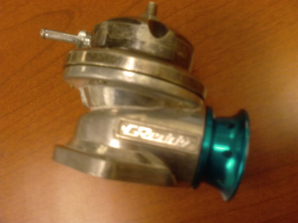

Buddy gave me Greddy RS BOV so maybe I can get the intake finished up.
