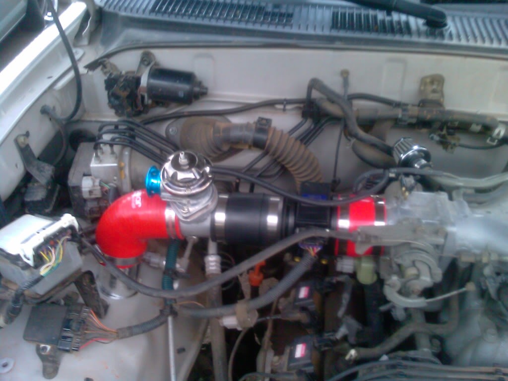

Fixed the intake pipe. Doesn't blow the charge pipe off anymore and runs like a champ.

Ok, so you are running the MAF after the turbo/BOV, won't have any problems with the BOV that way. Most try to run it before the turbo.

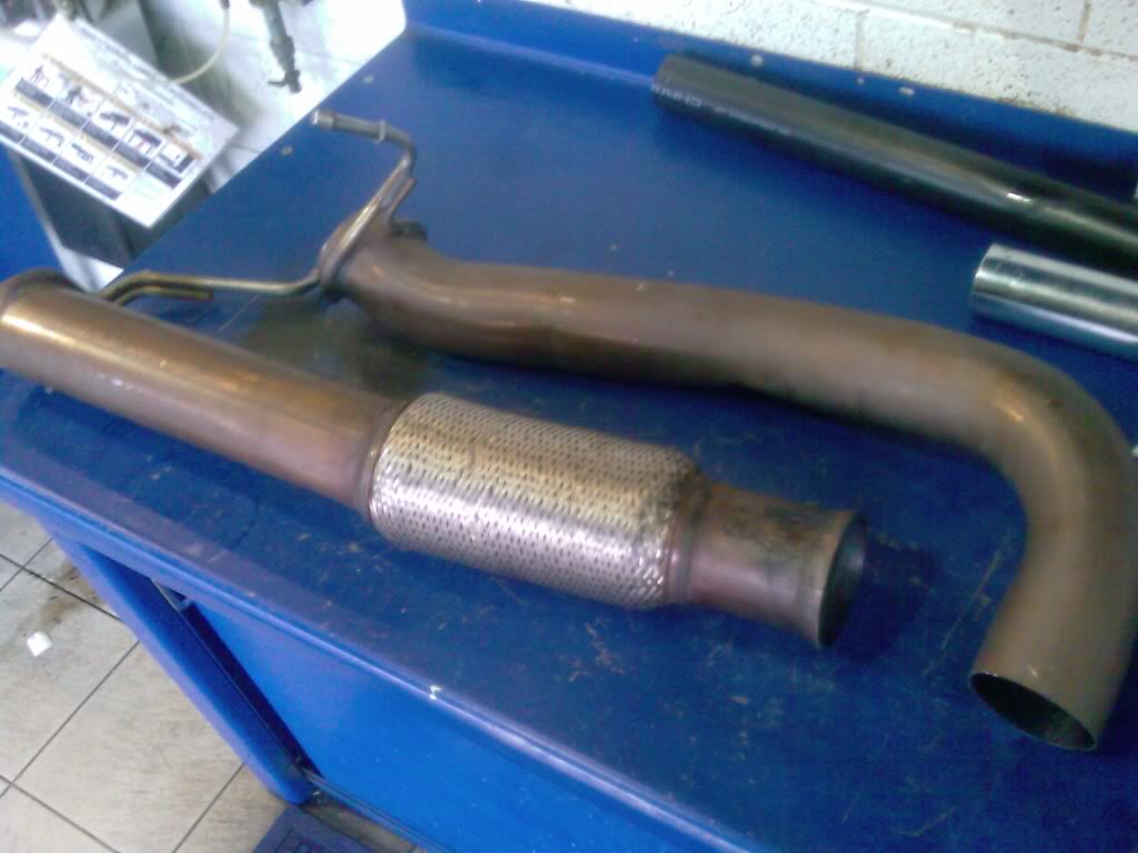

Going with 3" exhaust.
