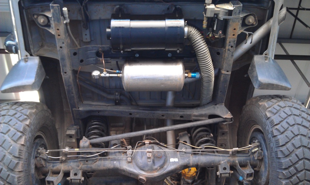

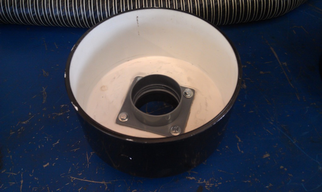

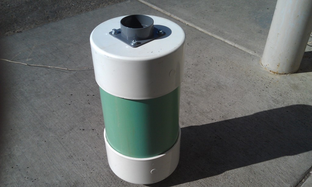

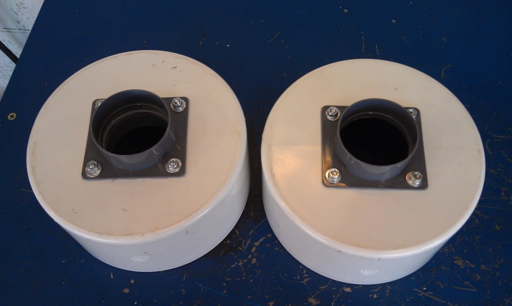

One waterproof, high flow, inline, lifetime, washable, heavy duty air filter.

Interesting setup, should work nicely, surprised there were not any pre-made versions of this.
Me too. I did find two, one was way to small and the other was almost $300.

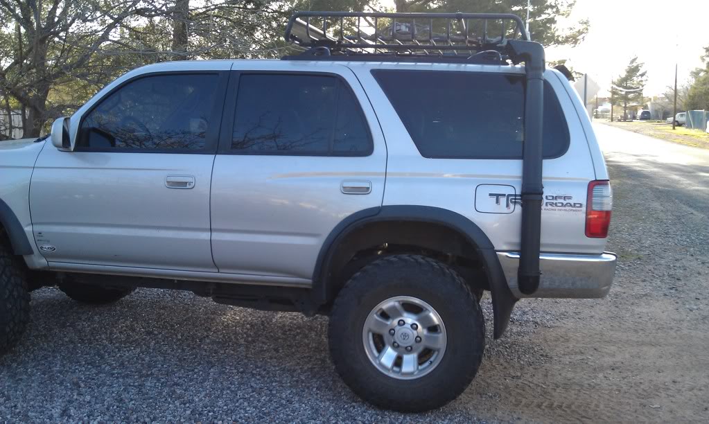

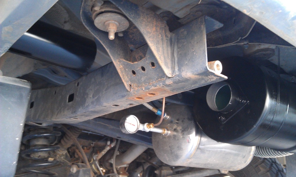

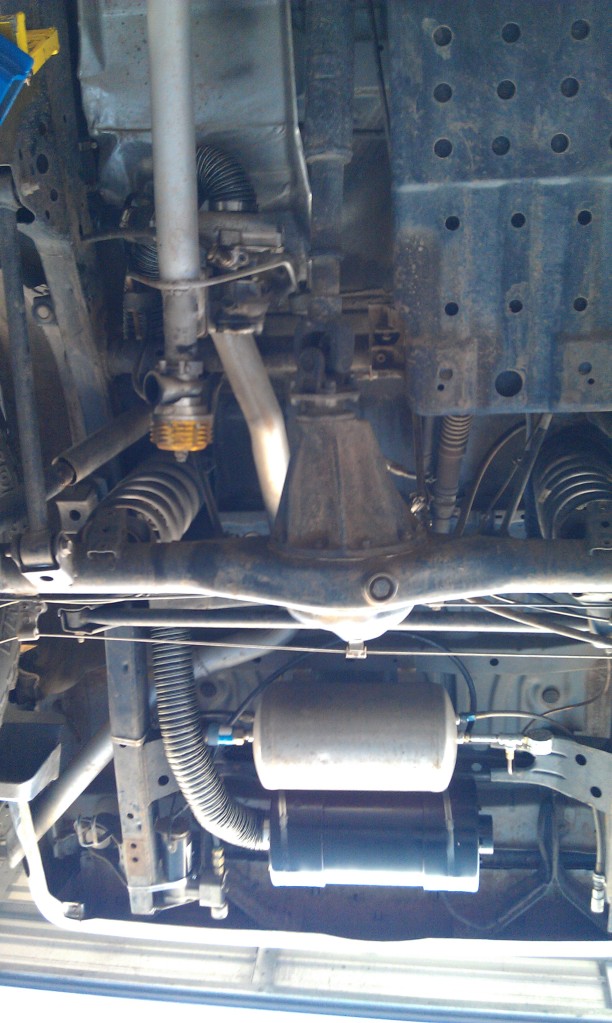

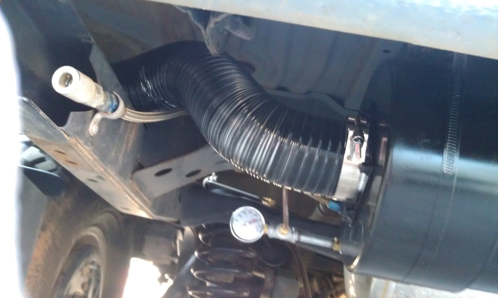

I'm all snorkeled up now. Ran out of neoprene hose and had to finish the snorkel to filter bit with some flex aluminum.

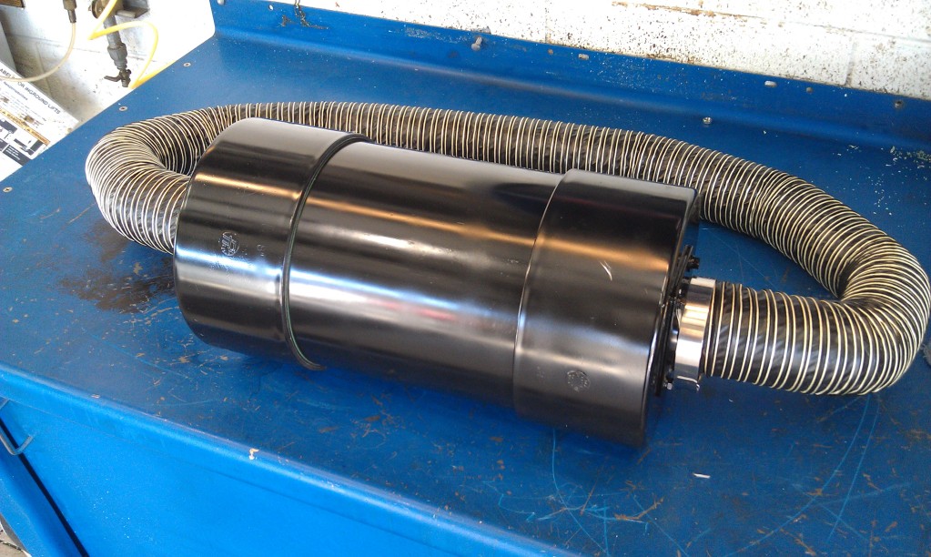

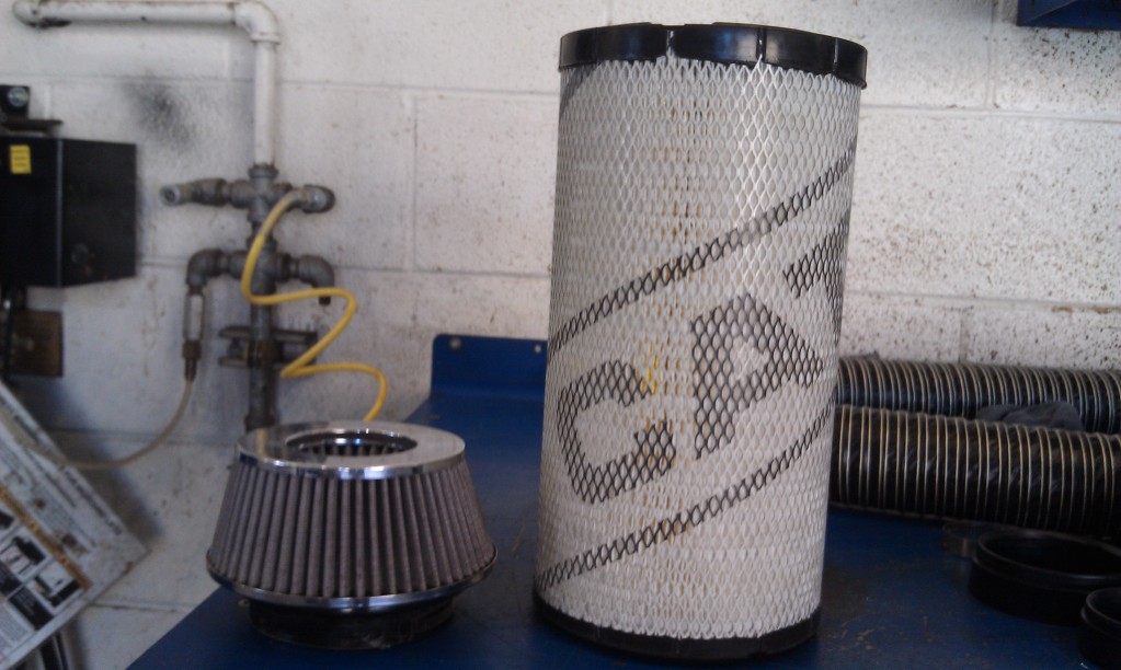

Old filter compared to the new one.

Clown you should put a condom of some sort over your air chuck on your frame. I had mine in a similar spot before I tore my on board air set up off and it would always be jammed up with rocks, dirt, etc. Just an idea.
For your filter cansister, did you look what Cummins had to offer? My dad has a nice Cummins filter housing on his Razor 800.
