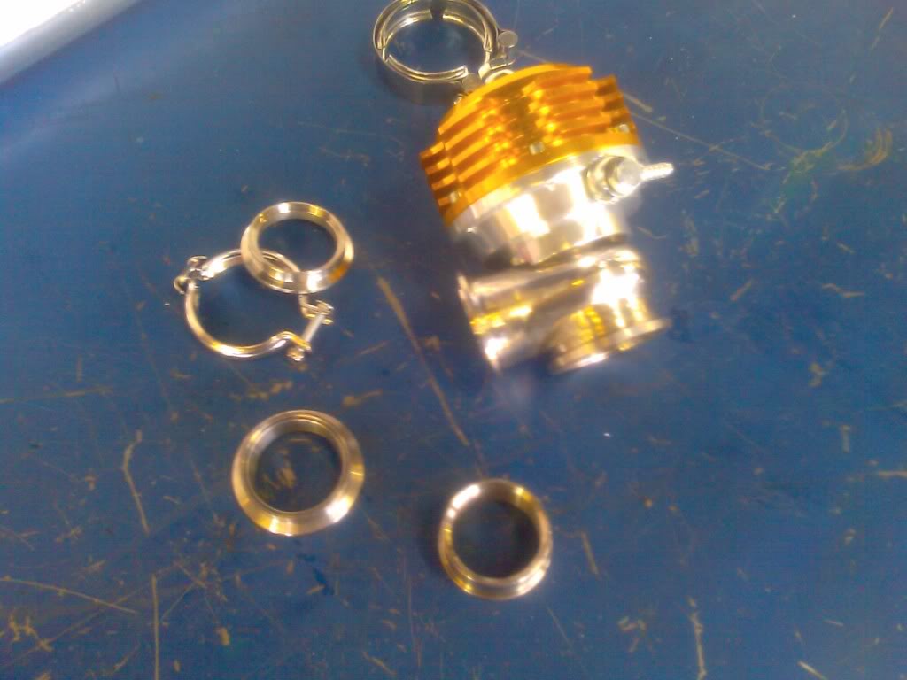

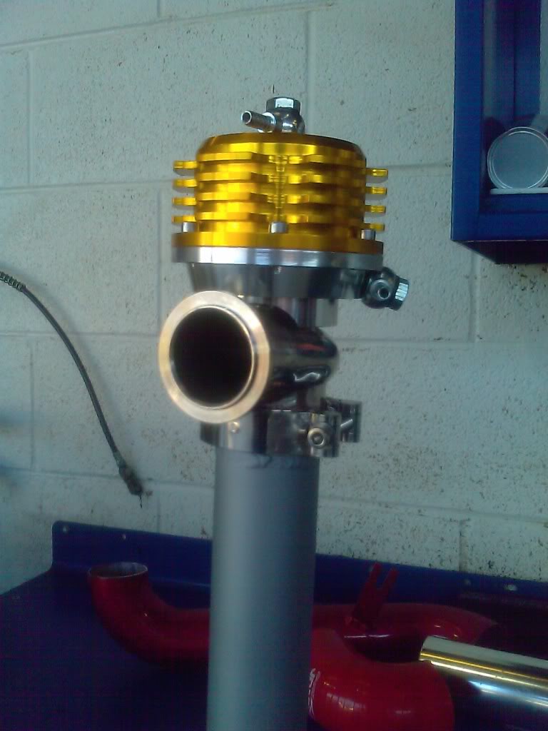

Wastegate came in the mail today ahead of schedule. So theoretically I could be making boost this weekend.

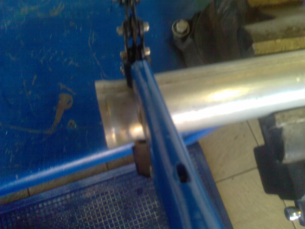

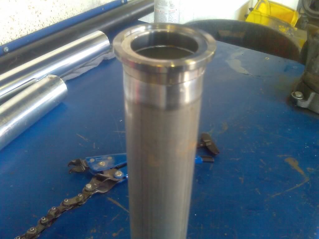

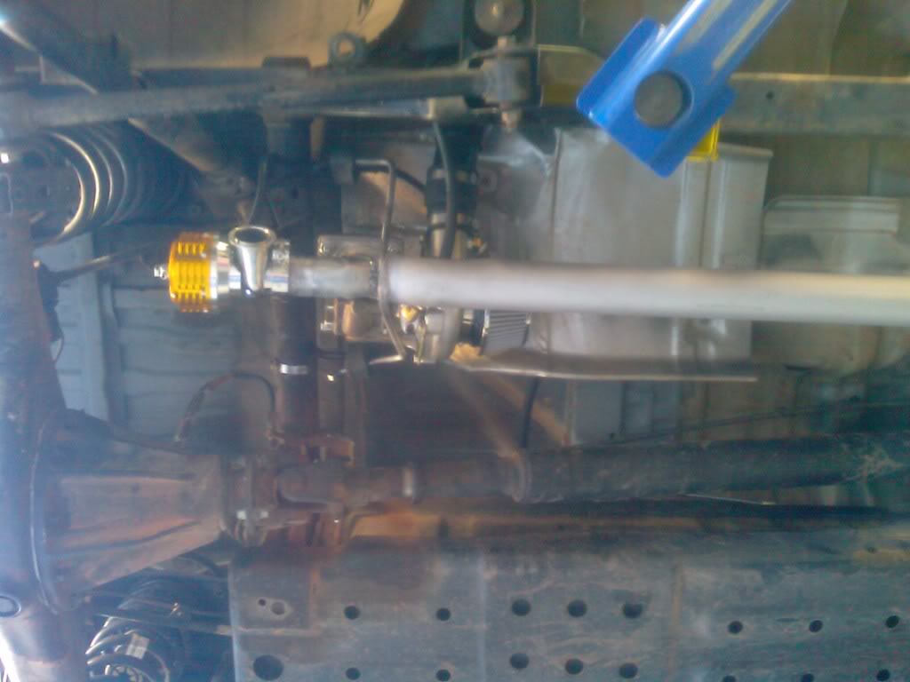

Today's lunch break... trying to get the wastegate mounted.

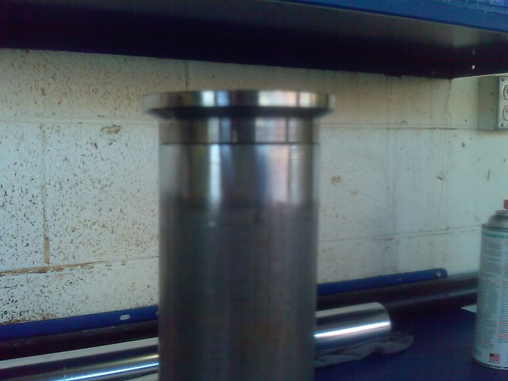

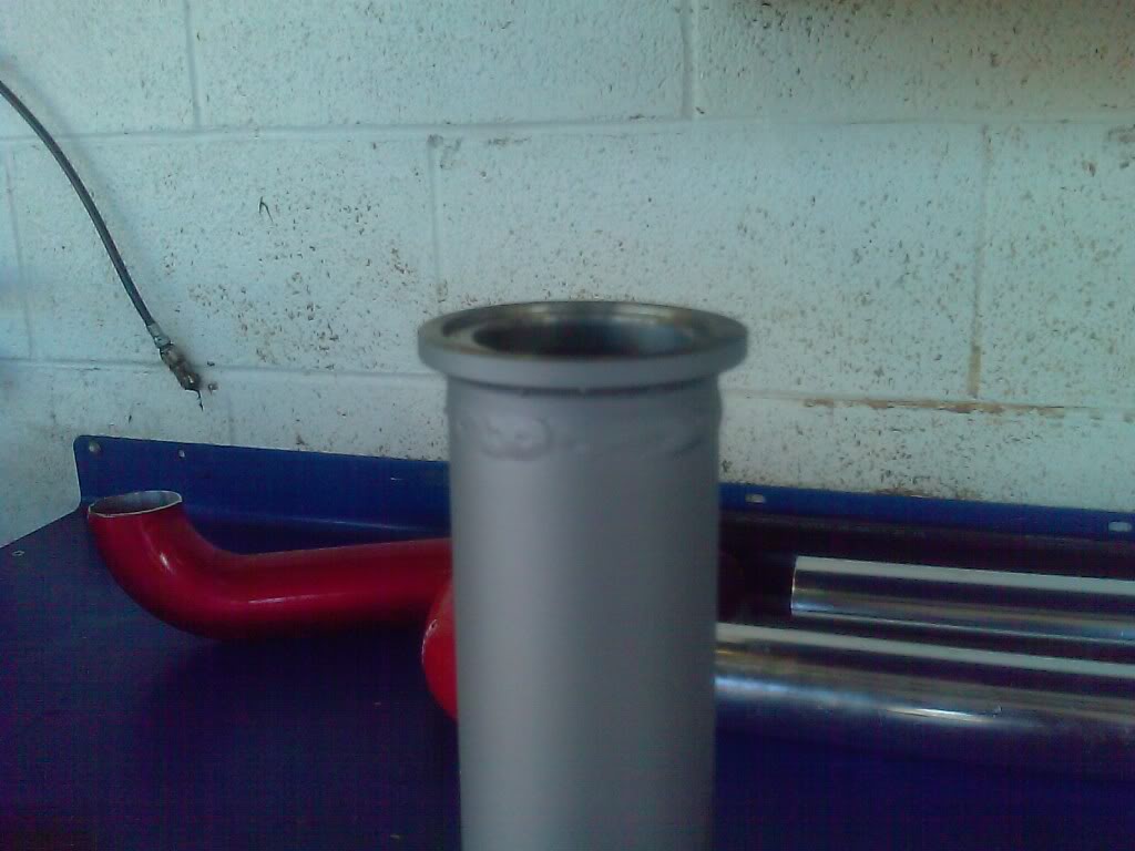

You do your own ceramic coating?
What brand is that wastegate and how much was it? Looks like a tial knock off.
Where are you going to mount the wastegate?
It's just 2000 degree paint, holds up well for the most part.
No name wastegate, it uses the same flanges, clamps, springs and diaphragm like a tial or turbosmart. Last one ran about 3 years before a new diaphragm was needed, $80.
Don't know where it's being mounted yet, maybe tomorrow.

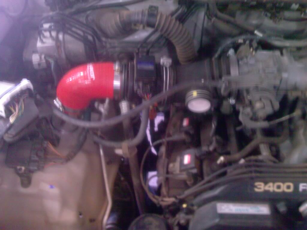

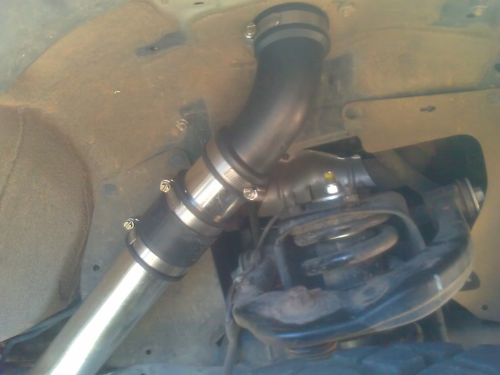

Wastegate is on. Got the rest of the charge pipes mocked up and is drivable, but I took it out and floored it and blew the pipe off the throttle body, so need to get my silicone couplers and t-bolt clamps on there.

Nice! what spring do you have in the wastegate?
Also whats the elbow in the fenderwell made out of? looks like PVC?
Be sure and get lots of videos of it running!
Old Oct 22, 2011 | 12:45 PM
  #68
Clownmeat's Avatar
Joined: Jun 2011
Posts: 333
From: Arizona
7 pound spring
It's flexible rubber
