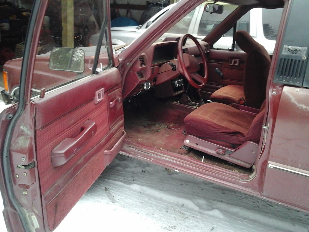

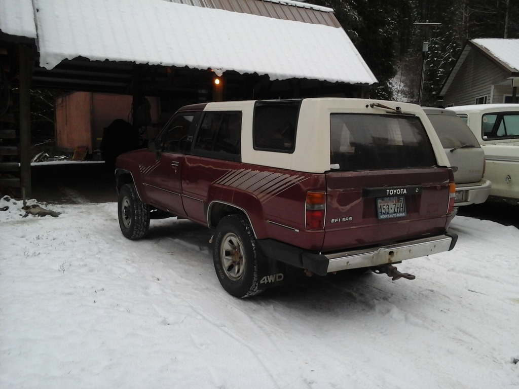

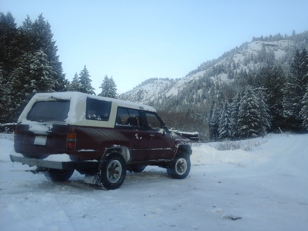

New-to- me 87' SR5 4Runner
Well I ended up selling my 86' 4runner, and picked up this 87' SR5 as a part trade. It has a 22re/5speed, and 243,000 miles on the odometer, supposedly 80,000ish on the motor. The body has some rust, mainly on the passenger rear quarter wheel well opening, Im hoping that is the extent of it, I guess I'll find out the more i tear into it. The interior needs some TLC. The seats aren't in the greatest shape, but the door panels and side panels are pretty good. The head liner is in really good shape, even on the remove able top. Not my first choice for interior color, but it's in good enough shape that I can work with it. Here's some pics.

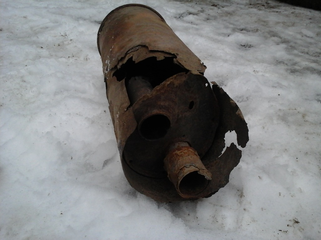

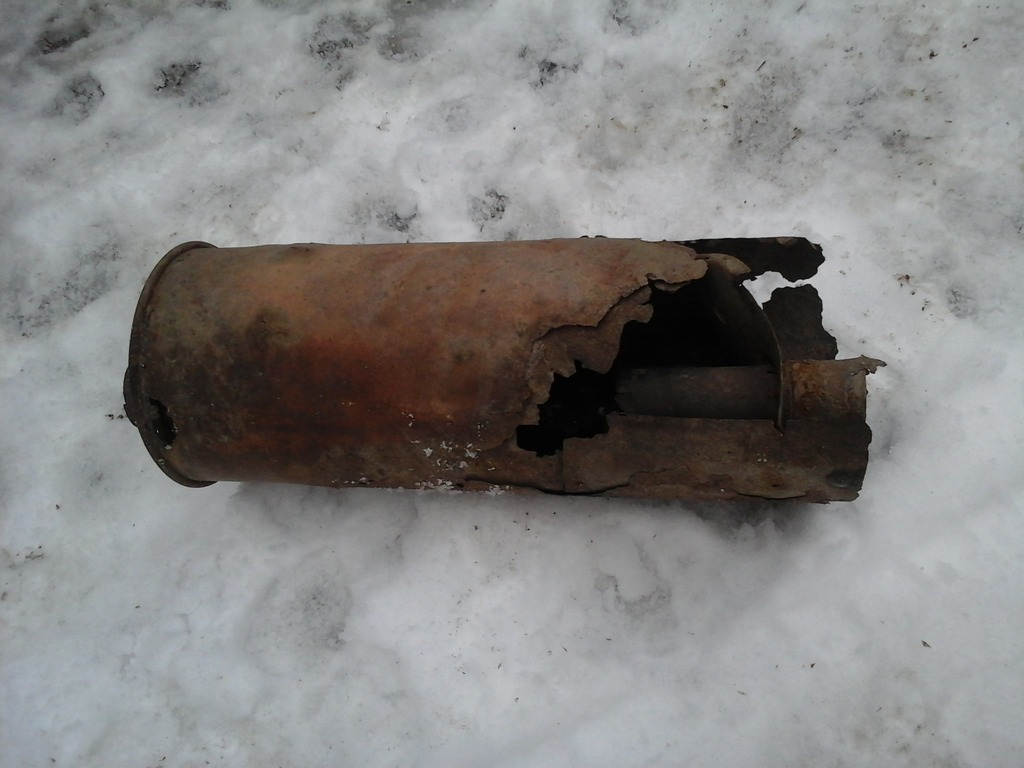

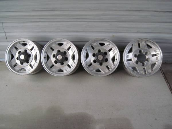

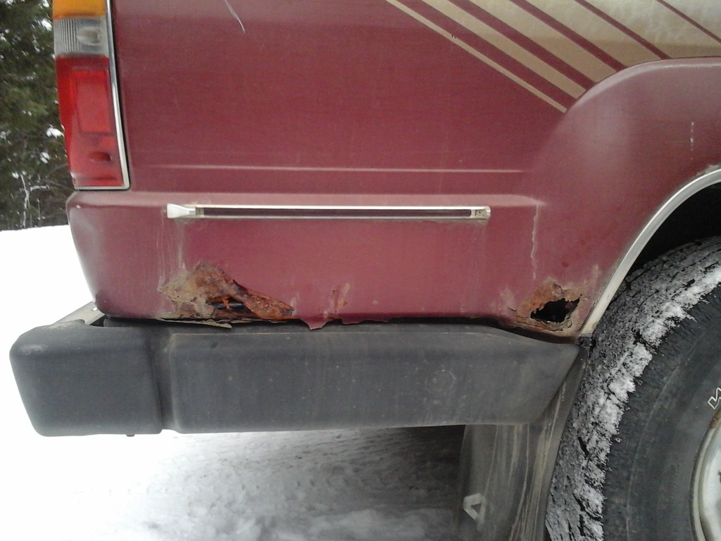

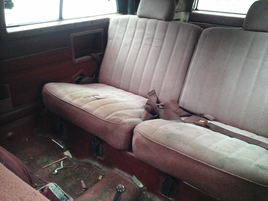

I haven't decided on the direction I want to go with this 4Runner yet. On my 86' it wasn't really drivable when I first got it, then I did a SAS and V8 swap on it right off, so this is kind of like my first EFI/IFS equipped toyota in a sense. I'm not going to say that I won't ever sas it, but for now I'm going to just clean it up and fix a few things on it and see how it goes from there. Here's a short list of some of the things I'm going to address first (nothing to exciting).
◆Fix intermittent start issue, (click, no start)
◆Replace the muffler, the current one is completely rotted and half missing.
◆ Get some better tires mounted. It currently has 235R15's on it, and I have another set of 4 like new on my old 76 ford parts truck
◆Fix passenger side front seat. I flipped it forward, and now I can't recline it back into regular sitting position.
◆Clean the inside really good, I think a cat or dog was living in there!
◆ Replace the heater controls. It blows hot, but all the selector switches are trashed.
◆Zuk mod, I'll probably use Jeep tj front coils again.
◆ Try to straighten out the front bumper and valance, replace missing front bumper end caps
A couple long term plans, probably for next spring/summer.
◆Fix rust issues
◆DIY bedliner the whole exterior (white) I'm leaning toward Monsta-liner.
◆Build a locking center console/armrest/cupholder (similar to the one in my 86') to replace the stock beat up one
◆Build a rear bumper/tire carrier
◆ add more things as I think of them

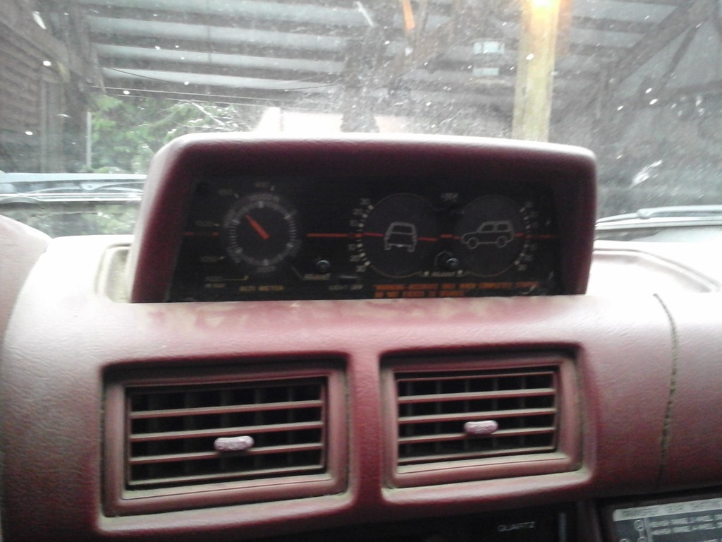

I'm happy that I got a tach and inclinometer this time, out of all the toyotas I've had, this is my first SR5. I also like the double map light feature in the rearview mirror!

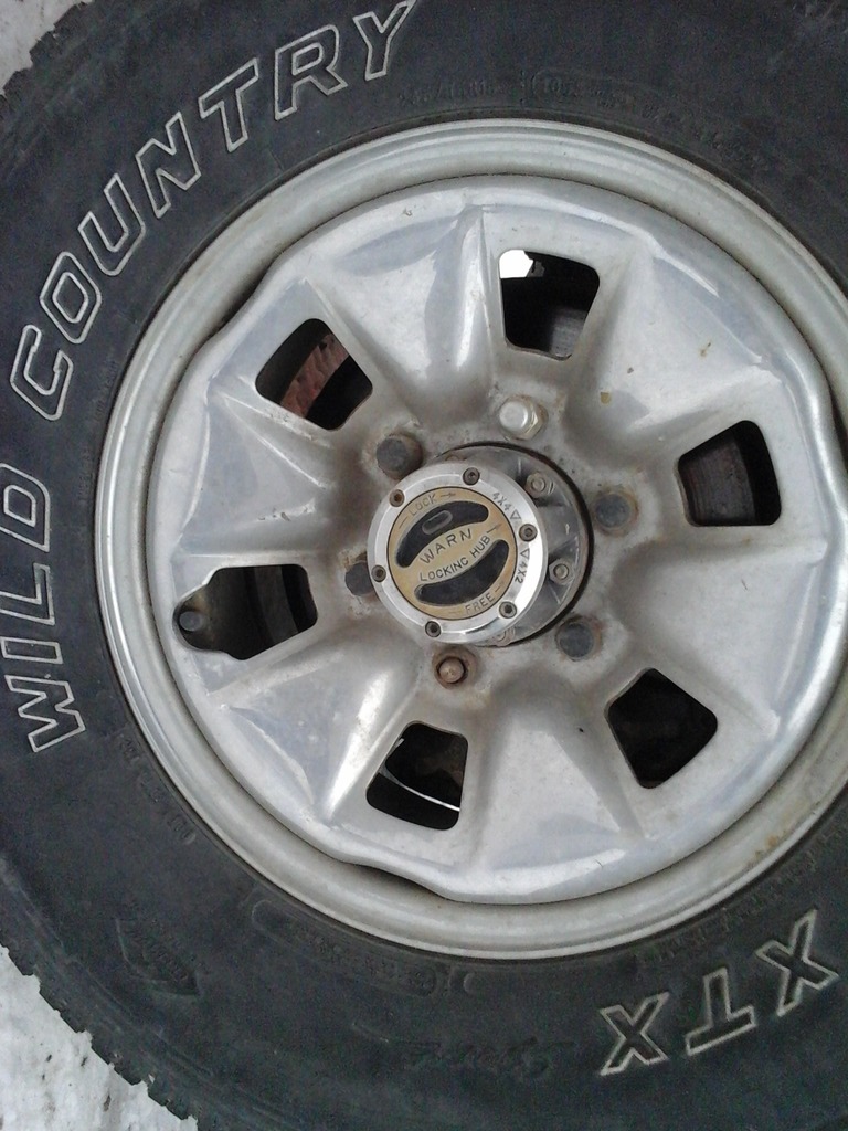

Just noticed today that I have Warn locking hubs, we'll see how well they hold up.

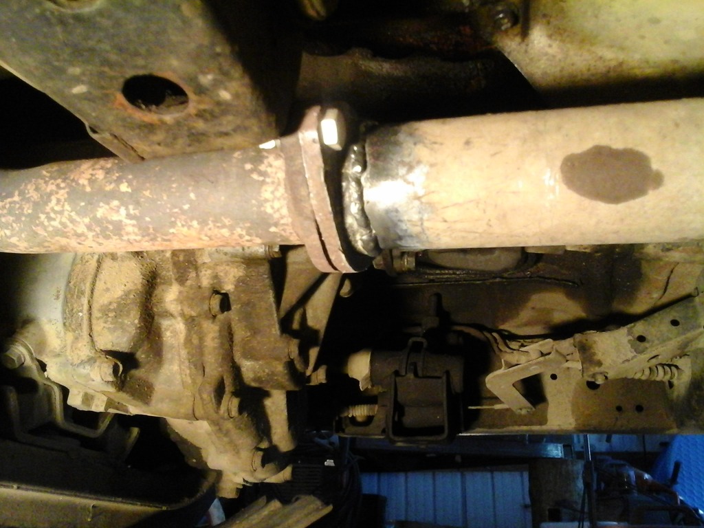

I worked on the 4runner a little today. I couldn't handle the sound of the exhaust any longer, it was so obnoxiously loud, lol. I didn't have any money to buy a muffler, so I took the one off my 76' ford parts truck, it was longer (24") so I had to remove my cat to make room for it, which was fine, it was probably the original cat and plugged anyway, plus I don't have to worry about smog. I cut the flange off the cat and welded it to the new exhaust pipe (which was 2-1/4") that went to the new muffler, then welded the hangers onto it. Took it for a test drive, it's so much quieter now, and feels like it got some more power too, it seemed pretty doggy before.

Here's whats left of the old muffler...

No major updates. My mpg improved since putting on the muffler. I went from around 18 mpg to 20mpg. That's with an average speed of around 50 mph and with the front hubs locked in due to weather conditions. We took it on a 500 mile round trip to Yakima and back. The 4runner ran great and I got 23mpg on the freeway, I'm happy with that, nearly double the mpg's of my 302 4runner.
I played around in the snow a little today, I tried to following some snowmobile tracks up this old logging road, my nearly bald tires are definitely a limiting factor, lol. I had to back up about an 1/8th mile since there was nowhere to turn around.

Hopefully I will be addressing the tire situation soon, I want to get some 31 or 32x10.50x15's, not sure which one yet. I've been looking at getting some of the older factory toyota rims, found a set of 4 for $100 on CL, hope to get the money together before there gone. Here's the wheels I want to get.
