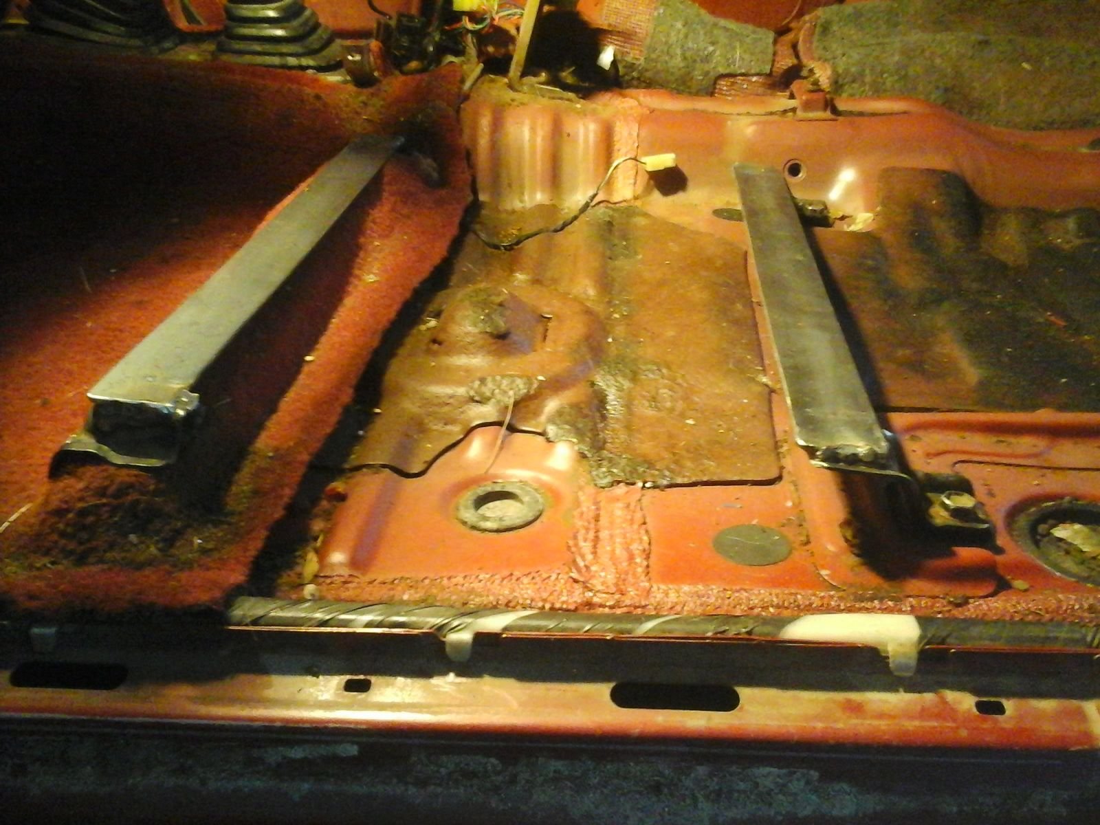

I should have an update on my seat install project in the next few days, I have to modify and build some new brackets for the front buckets. I pulled the OEM rear seats out, and didn't realize how much of a contour the floor has where the seat bottoms go. I fear that the shape of the floor is going to complicate the install since the durrango seats bolt to a flatter floor surface.

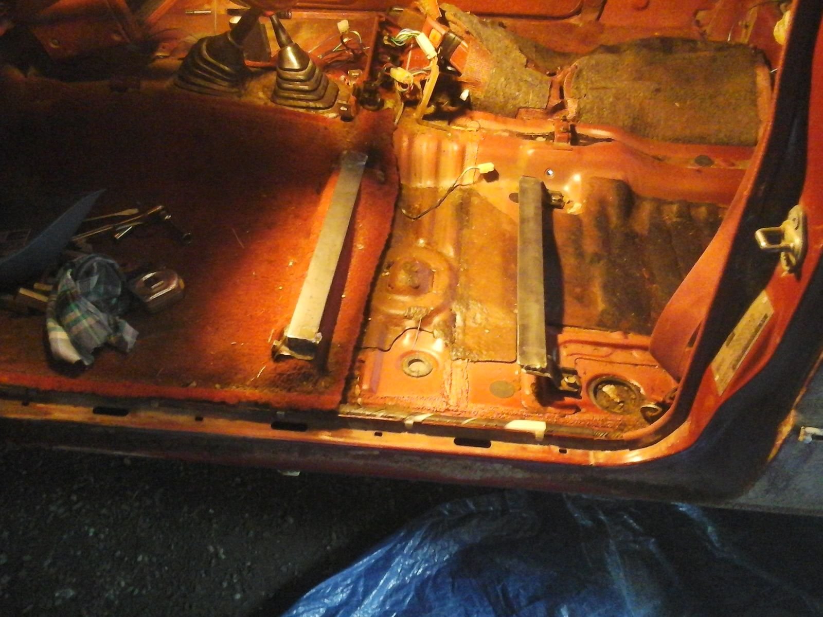

I got a little bit done on my seat brackets for the drivers side front bucket seat. I had to change my plan a little, my original one didn't work out. What I ended up doing was grinding the rivets off the bottom of my original seat sliders and removing the "feet" that bolt to the floor. With the seat already out I bolted the feet back down to the floor then tack welded some 1-1/2" wide by 1/8" thick flat bar stock across. Now I can center the seats where ever they need to be and weld the new seat slider to the flat bar. I didn't get very many pics it was getting to dark, but tomorrow I'll get some of the seat installed.

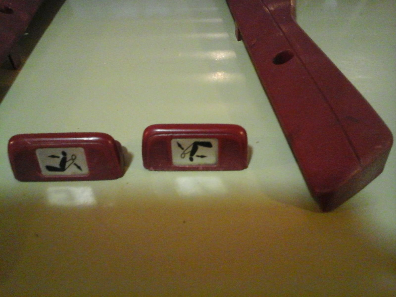

My old front bucket seats are pretty much junk, but the plastic covers that go to the seat bottoms are in good shape, just need cleaned up. Also the headrest covers are pretty faded and worn, but the headrest foam inside was in good shape. I also have the complete rear seat and hardware, again they would need reupholstered, but they are complete. If anyone can use any of the parts below just let me know.

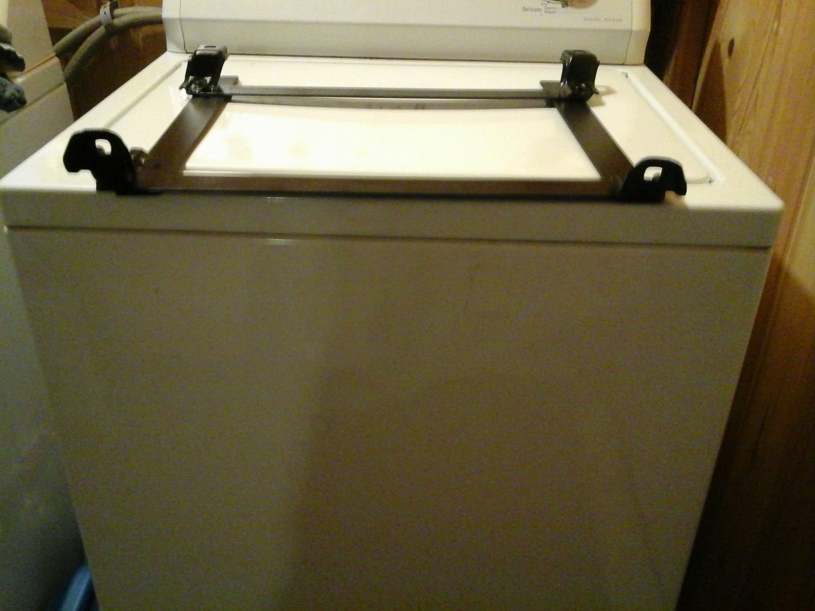

Well this project is taking alot longer that I thought it would. I changed my idea for the seat brackets again. I didn't like the idea of welding the seat sliders to the brackets that I was making, I can't unbolt the sliders from the seats, and didn't want to risk welding on them while still attached and possibly burning a hole in the seat. So I added 2 more supports running parallel with the sliders and bolted the seats to my brackets. It worked out pretty well. It was alot extra work, mainly just time consuming trying to figure out the seat placement so I would have enough seat adjustment forward and backward. It will be worth it when I'm done and the new seats will bolt right up to the factory mounting holes. The passenger side should go alot faster since I know what I'm doing now, lol.
Here's a couple pics of the finished bracket after I painted it.I haven't installed the seat yet, it's was still cold outside, so I had to let the painted bracket hang by the stove to dry (my wife loved that). So I won't have any pics of it installed till tomorrow. I ended up using all my 1-1/2" flat bar on the one seat, so I'll need to buy some more to do the passenger seat.

I like how you are using the original mounting tabs on the bracket. That will make it an easy install and if ever need to remove the seat in the future. Looks great.
