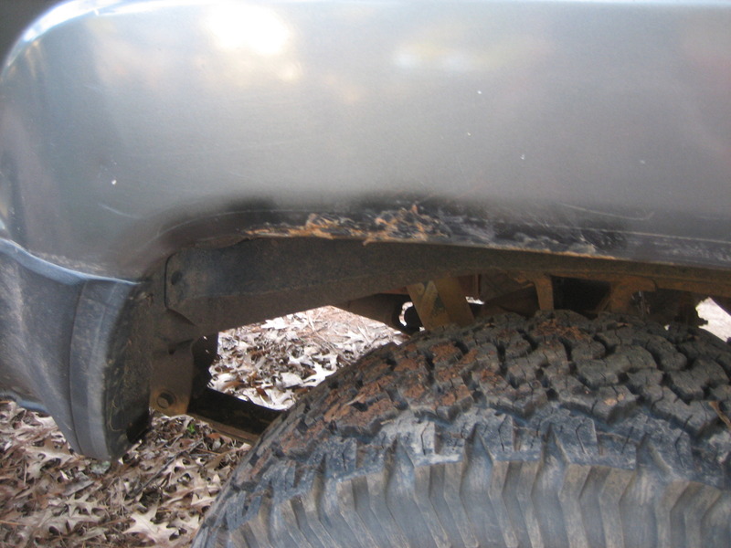

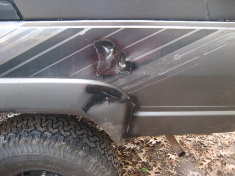

Sorry to hear about the rust. I feel your pain as I'm sure you've seen on my build thread. The unfortunate thing is that unless you have a scratch in the paint or the paint has just plain faded and peeled away, rust rarely starts on the outside. It typically gets in places from the inside through leaks or cracked seam sealer then just sits. It gets on the dust and dirt that naturally accumulates and never dries, and creeps into pinch welds. What this means is that by the time you see a bubble on the outside, the inside is usually more than ten times worse. Not trying to scare you, just trying to mentally prepare you so you can get it fixed right.
Here's my truck showing what was visible from the outside versus what was actually happening on the inside.
Back left wheelarch. Obvious rust but not as bad as some I've seen.

But cutting it open revealed this. 90% of it was rusting and it would only be a matter of a couple years before it all showed it's ugly face.

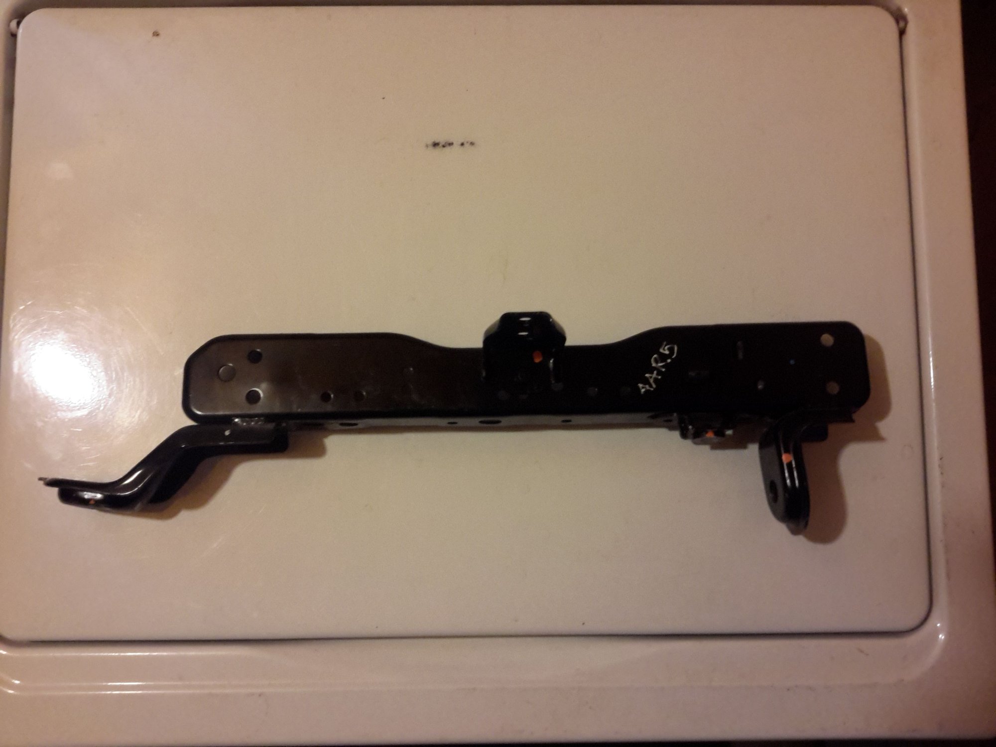

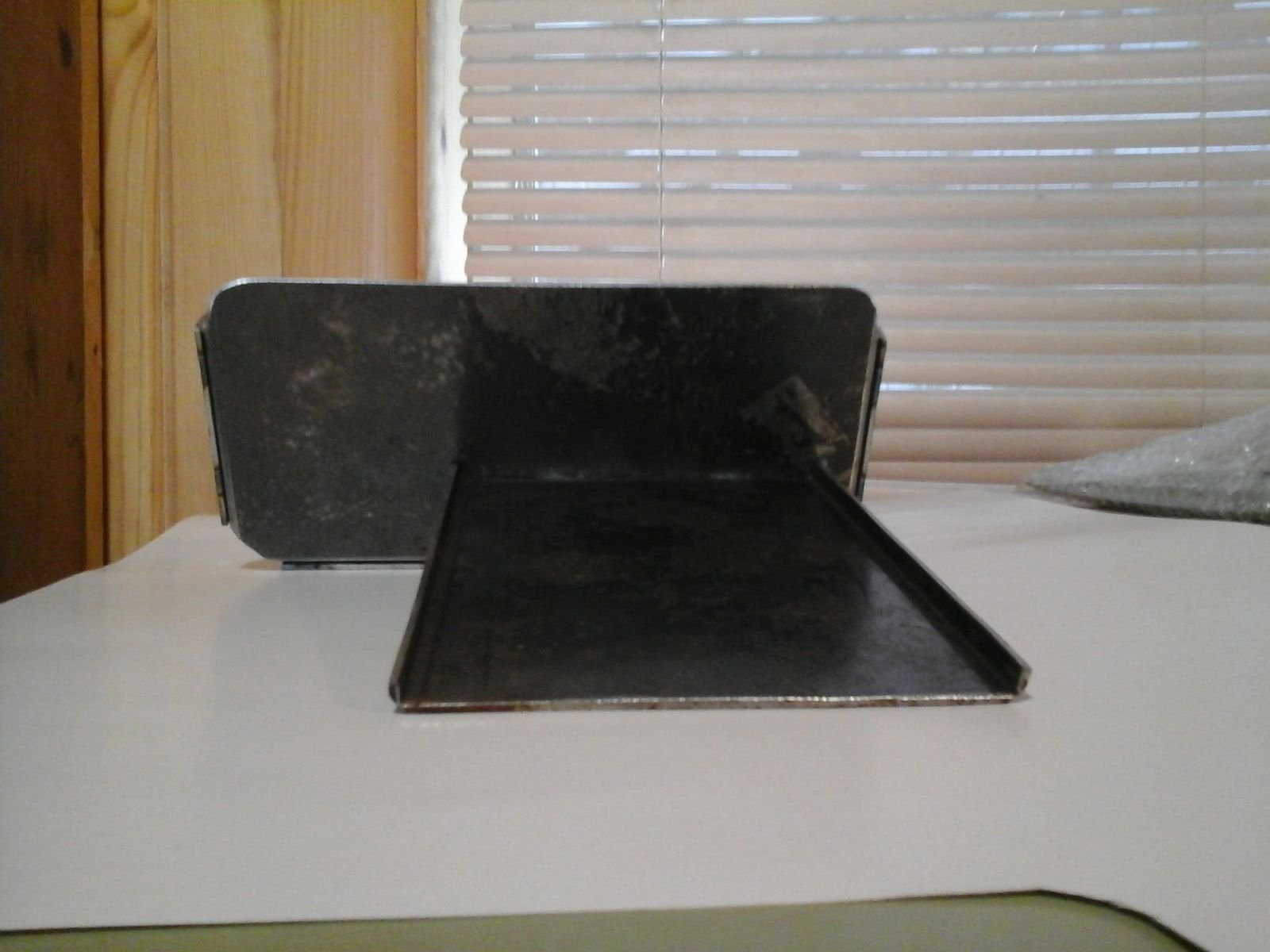

I was looking for a mount for my tablet so I could play my music library through my stereo, but I was having a hard time coming up with one that would work, most of them use a suction cup mounting system to the windshield, but my inclinometer is in the way. So I decided to try to make my own. I will use the track that the ashtray slides into to secure my tablet mount.
Here's some pics, it's still rough, I need to bevel the corners and clean it up. Then I will probably wrap it in some fake leather fabric I have.
I was a little concerned about the weight of my mount since I made it out of some 14 gauge sheetmetal, but since it slides really far into the dash it is really sturdy.

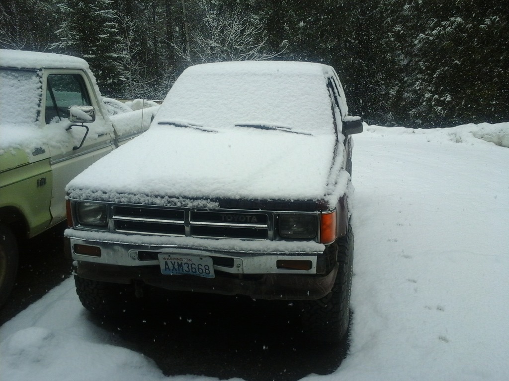

Well I thought we were in for an early spring, the weather has been nice and the snow finally melting off... then this morning I woke up to this:

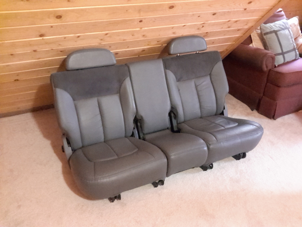

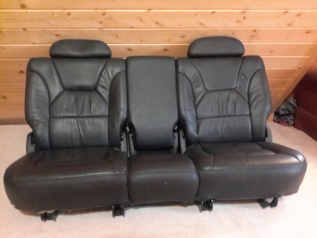

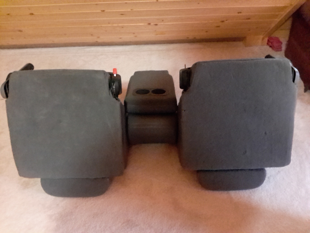

Small update. The guy I bought my seats from had another rear bench seat out of a Durango for sale on Craigslist that looked like a closer color match to my front light grey bucket seats.
So I called him and he let me trade my dark grey for his light grey bench seat, got it home to compare them and it's a really close color match. This one has some suede at the top, but that's fine, I'm pretty happy with them. You can see how much darker the other bench seat was in the above pic compared to the ones below. Hope to get my carpet tomorrow!!

Originally Posted by punks_is_4x4
Do the rear seats fold down flush like the oem ones do? Curious I really like the option of a center console in the rear for my kids. Also what year are they from I guess 2000 up all make and models were required to have a car seat latch system

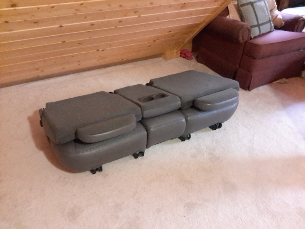

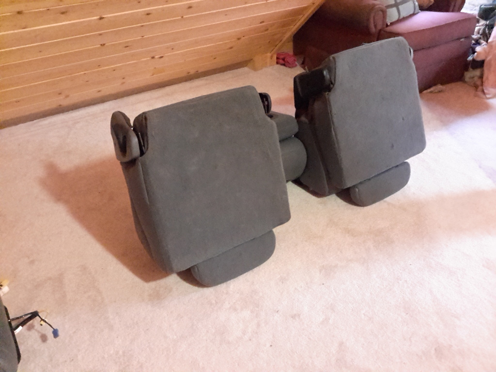

No, they fold differntly than oem. You can fold each seat back down flat like the center section/console, then you can tumble it forward towards the front seat, if that makes sense, (like in the 4th pic above your post)The reason is this was a middle bench seat, and it was to allow easier access to the 3rd row seat. The center section with the cupholder is stationary, it doesn't tumble forward. I'll go back and add pics when I get home from work tonight just to make it less confusing, lol. I'm not sure on the year, probably 98' and up. These are just like the ones out of my wife's wrecked 2002 durango. I have 2 kids, so having the cupholders is going to work out great!
*EDIT, here's some pics of it folding up in stages*

Originally Posted by 84 yota dude
Is there enough room to fit that bench seat in the back?
Yeah there's room, I was a little worried because I forgot to measure my old seat first before picking this one up, but they both measure aprox 52" wide.
