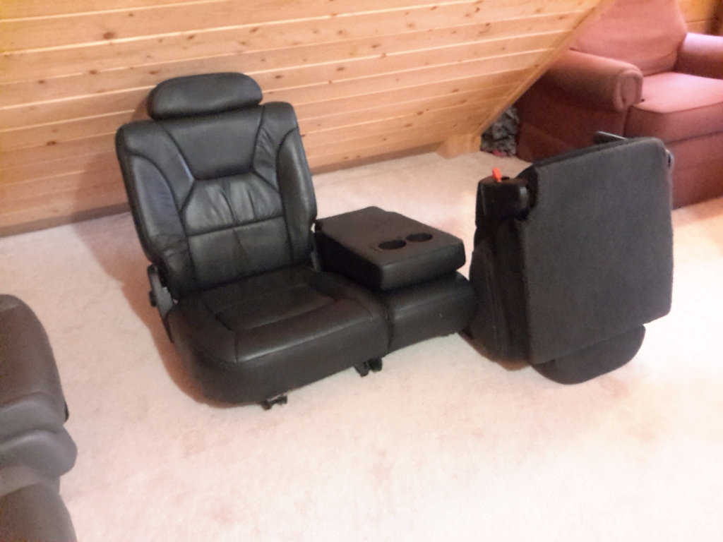

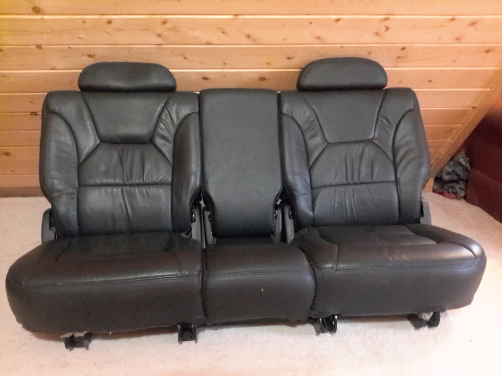

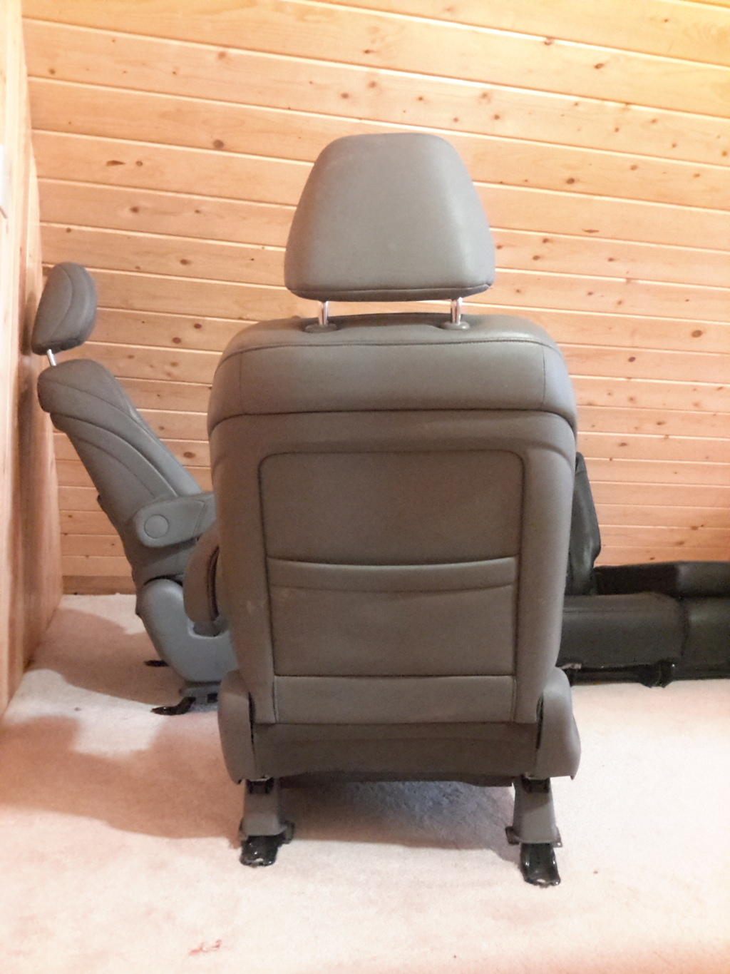

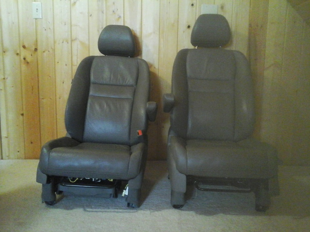

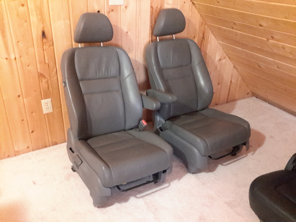

New seats!
Well I was looking through CL and found a guy that had probably a dozen sets of nice seats for sale, most of them were leather with power, and in really great shape. I found a set of light grey non-power seats in fantastic shape for $120. He wasn't sure what make of vehicle they came out of. I also bought a middle bench seat out of a dodge durango that he had for $80, its leather as well, but is a dark grey, they look almost black in the pics. I lucked out on the rear bench, I forgot to measure how wide my factory rear seat was, it ended up being the same width, around 52" wide. This was kind of spontaneous splurge on my part, I should've waited to see if I'm going to have any more issues after overheating the engine awhile back. But I reasoned that by getting some new seats it will hopefully give me the motivation to do an interior color change to grey, plus these front buckets are way more comfortable! The kids will appreciate having cupholder too.
Not sure if I'm going to try some SEM interior dye/paint on the back seat to try to match the fronts or leave them. Anyway, for $200 I think I got a good deal.

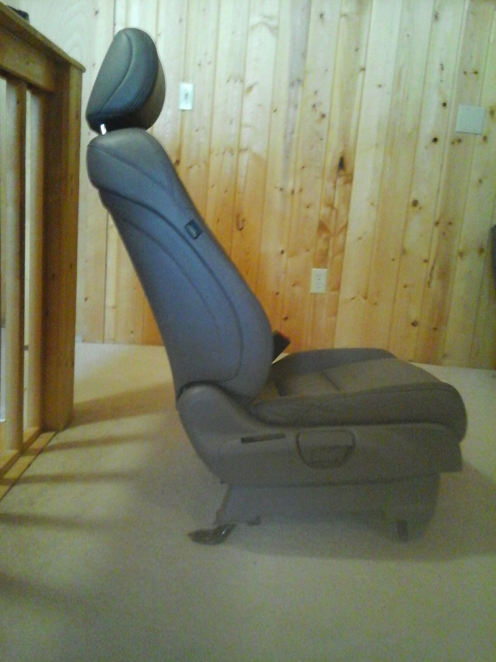

^^^The driver seat has a handle that you can raise and lower the height of the seat. You can see in the pic the driverside is raised all the way and sits close to 2" higher than the passenger side. Passenger seat has a little drawer under it. I can already see that I will have to modify the seat bracket as they sit to high, after looking at them, it doesn't look like it will be that difficult . Name:  20160206_105403_zpshy7girtk.jpg

Old Feb 6, 2016 | 02:08 PM
  #64
bootscootboogie's Avatar
Joined: Nov 2014
Posts: 818
From: beast alabama
Man what a nice score on the seats. I really like that passenger side compartment. Would be a great place to store snacks. Lol

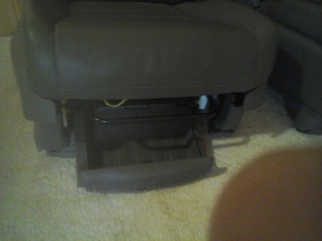

Thanks, I happened to pull that side compartment drawer out, and on the bottom was a Honda logo, so at least I know what brand vehicle they came out of, I'm kinda thinking they are out of a Honda Odyssey or maybe a Ridgeline, just from the fact that they have the extra bracket on the seat base that makes them sit up higher. It seems like on the cars they sit closer to the floor, I'm just guessing, but anyway, they are comfy for sure, I'm pretty excited about getting the them mounted. I will probably wait until the weather warms up, in the meantime I will be gather some parts to do a complete interior color change over to grey. I have a tax return coming, so plans are:

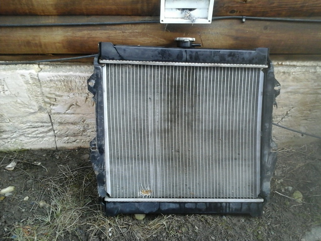

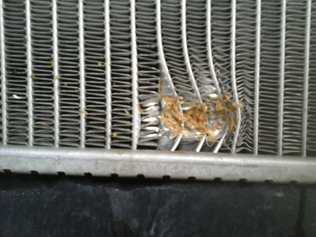

Thanks for the tips on flushing the cooling system Terry, but I think I might have found the culprit.
If you guys remember back to my original post about my 4runner overheating, you'll remember me talking about having to stop and clear this broken tree that fell across the road and that's when I noticed my truck smelled hot. What I didn't mention was about a 1/4 mile earlier down my driveway there was another tree down with some small limbs that I ran over, evidently one of them snaked it's way in and found my radiator! Costly mistake on my part, new radiator should be here tomorrow. At least I know I didn't drive very far with it running hot, still crossing my fingers and hope the head isn't warped!

Did it appear to be leaking? Doesn't look wet around the bent tubes.
Old Feb 9, 2016 | 05:23 AM
  #71
rustED's Avatar
Joined: Sep 2010
Posts: 2,716
From: Tri-Cities, Wa
Yeah it leaks bad, I started to pour some coolant in the day after and it poured right out through the bottom. I couldn't see where it was leaking with the front skid plate on, I was asumming it was from the bottom tank.

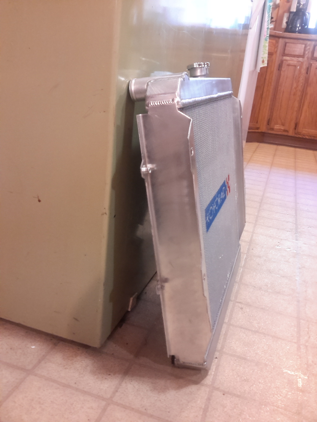

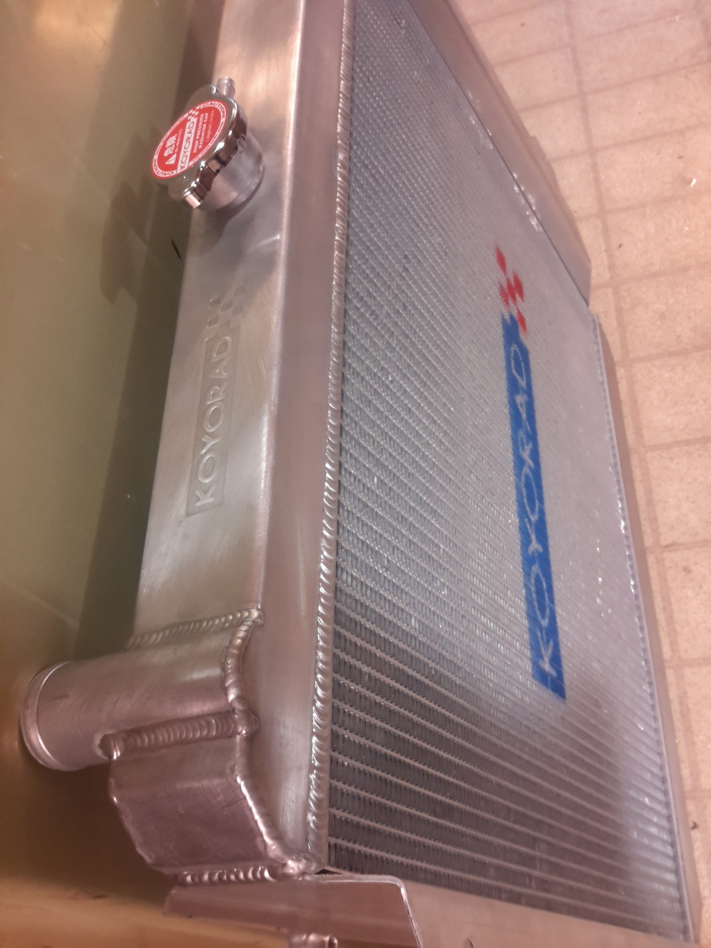

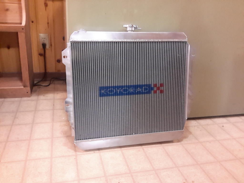

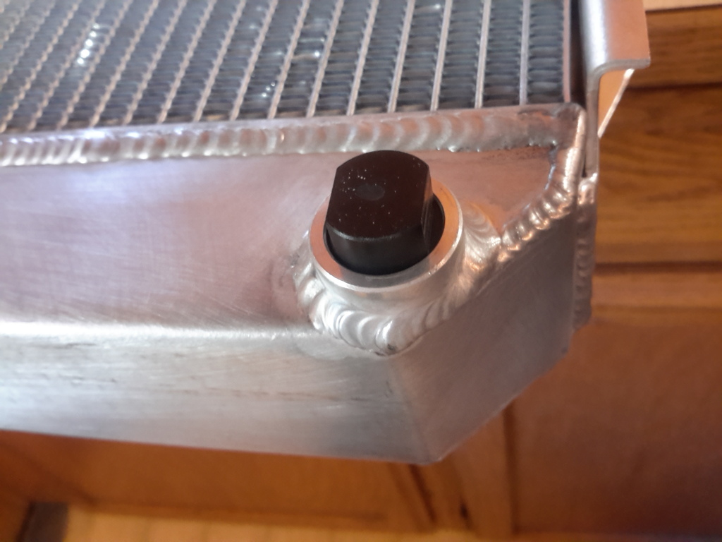

UPS delivered my new Koyo aluminium radiator today around 1pm. I had already received the new Koyo radiator cap in the mail a couple days ago, I had to order a cap since the new radiator takes a special sized one and didnt come with it. Yesterday I got the new toyota oem 2 stage thermostat and gasket, anyway, so I had all the parts ready to go and got it all installed this afternoon.
^^^Here's the new radiator, it's all aluminum and fully welded (no epoxy) looks to be pretty nice quality.

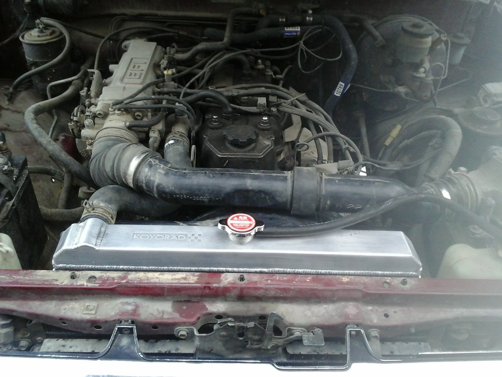

^^^Here's a couple pics of it installed, man I really need to clean up the engine bay! The installation went really smoothly, the site said it was a direct fit, but I always expect to run into a snag. To my surprise it was a direct fit, the holes were slightly slotted making lining up the holes easy. The shroud bolted right up as well, without any problems.

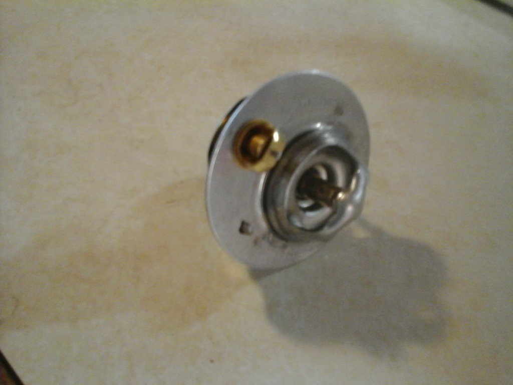

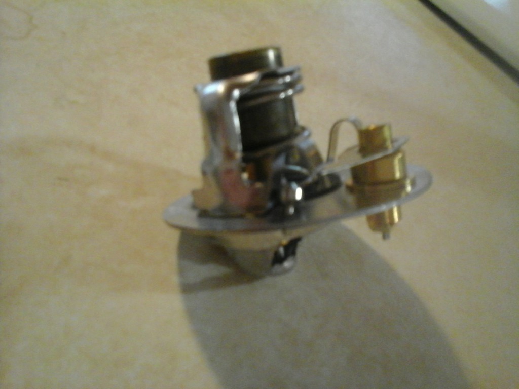

^^^Drove up on a snow pile to raise the front end up higher to help burp the cooling system. Pic doesn't look like it but fronts raised up a good foot higher.
^^^Here's what the 2 stage thermostat looks like, I never used one before, but after reading a good write up by 4Crawler, and reading the symptoms he was experiencing, mine sounded really similar, so I figured I'd give it a shot. Here's a link to the write up along with part # for the thermostat for anyone who's interested:
http://www.4crawler.com/4x4/CheapTri...tatReplacement
Checked the oil, looks good, no sign of coolant. The exhaust looked normal, no white smoke, didn't smell like coolant. Took for a test drive, so far every thing seems good!

That looks to be a great quality radiator and glad to see it fit like advertised. I have never seen the thermostat that you have posted. Always wanted to try one just never got around to it. Thanks for posting a picture of it.

Before buying the thermostat, and before I killed my old radiator, lol, I was doing some research, I was noticing my temperature gauge would spike a little high from time to time (I have an aftermarket one the PO installed, it normally reads around 190°). Anyway, after reading 4crawler's thread, the symptoms he was experiencing sounded the same as mine. He explained that toyota released a Technical Service Bulletin about this problem with the 22re's, and this thermostat was made available to eliminate the temperature gauge overshoot problem. I figured I would buy one and give it a shot, it's a oem toyota thermostat, so I figure it has to be better than the run of the mill Chinese made ones, lol. I picked mine up off Amazon for $34 and had to buy the gasket seperatly for another $4.50. I didn't notice the temperature spike at all yesterday on my test drive, and I was doing some snow wheeling, low speed/ higher RPM's too. I'll keep you updated since I plan to resume dd'ing the runner this week.

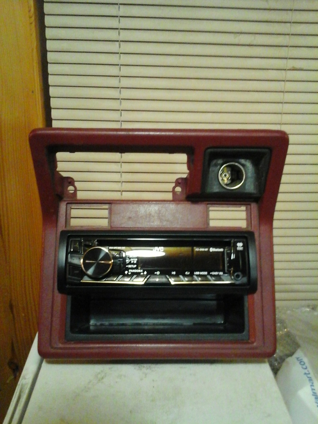

Got my tax return money, so time to do some upgrades! First, I mentioned earlier about the old CD player I had found in storage, took a chance on it and ordered a new wiring harness plug off ebay for $4.50. The CD player didn't work, neither did the aux input, where we live the radio stations are few, and dont come in clear. I was discouraged enough that I just went down and bought a new deck today. It's a JVC, wasn't very expensive, $98 but has bluetooth, aux input, remote, can take calls hands free, etc. It should suit my needs well, I don't need amps, and alot of bass like I used to have in the past, my hearing has gotten alot worse from all my younger days of loud working conditions, shooting guns, and loud music, and no hearing protection. I will eventually replace the front factory dash speakers, and get some for the back side panels, might mount them in those side storage compartments that are by the back seats.
^^^for some reason I had to trim more of the bezel to get the stereo to fit, I think the PO cut just enough to fit the stereo and didn't use the mounting bracket that the stereo slides into, they just pushed the old stereo in without it really being secured. I plan to eventually relocate the rear window and defrost switches from the console to the 2 empty blanks in the bezel.
