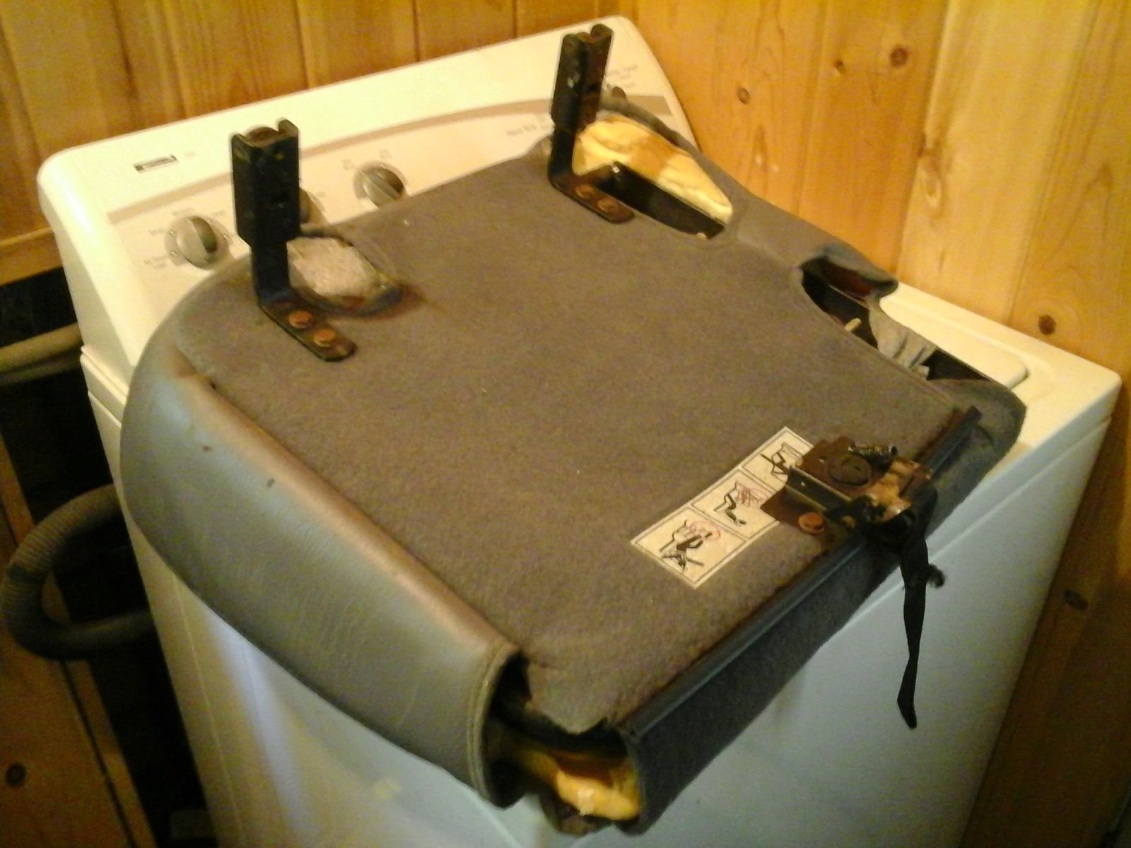

Worked on the back seats today. I had to make a change to the seat back frame a little bit. The first time modifying it I cut the frame and left the hinge in the original location, but I think that will interfere with mounting the center seat/armrest. So I cut the frame and moved the hinge over, then modified the hinge by widening the mounting flange. I thought I would have to drill new holes in the floor for the hinge, but I was able to use an existing threaded hole that was for the center seatbelt.
^^^Here is a before pic, you can see the way i cut the frame and welded it back together it left the hinge in the original location. I cut the the square tubing, and moved the hinge over more.
^^^Here is the hinge after I cut the frame and moved it over about 4-3/4 inches.The floor contours right where the hinge bolts to the floor, so i made a 1/4" thick spacer (not shown) and welded to the hinge to bring it back out level. The spacer was wide enough that I was able to use the seatbelt hole to bolt it down.
^^^Here is the seat bottom. I welded in a peice of flatbar.
^^^Then i cut the frame and slide the springs over to center them.
^^^Side by side comparison. The durango seat bottom on the left and the modified 4Runner frame on the right.
^^^And finally some pics of the foam and cover on the newly modified 4runner seat bottom frame.
The way the durango seat foam is shaped, the seat backs slope back a little more than the originals, same with the seat bottoms. I dont think it looks too bad, and they are really comfortable.

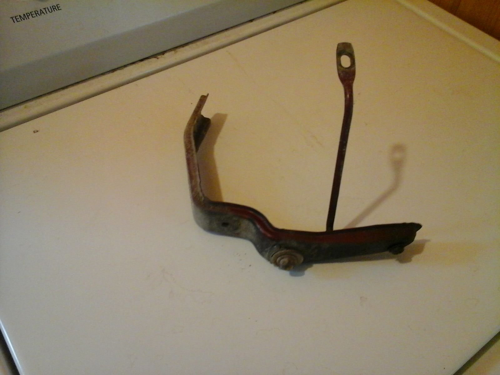

I took a break from the seats and mounted my front bumper today. At first glance it looked pretty decent, but comparing it to the oem chrome bumper the metal is alot thinner, if you push on it it flexes really easily, basically it's almost like sheetmetal, lol. Here's some pics:
^^^ before, thrashed chrome bumper, missing end caps, beat up valance.
^^^Also added a second tow hook to the driverside while I was under there, had a couple extras from when I sas'd my 86 4runner.
^^^When I removed the valance I didn't realize that the bracket also help support the plastic end caps. It was kind of a pain removing those brackets to begin with, had to pull the air intake to get the driverside off. So instead reinstalling them I drilled out the spot welds on the round steel part of the bracket and removed them.
^^^Then I bolted it up to support the end caps, One of the spot weld I drilled all the way through so I could get a bolt through the bracket and into the plastic end cap. This bumper will be temporary, at least it looks better until I come up with something else...
