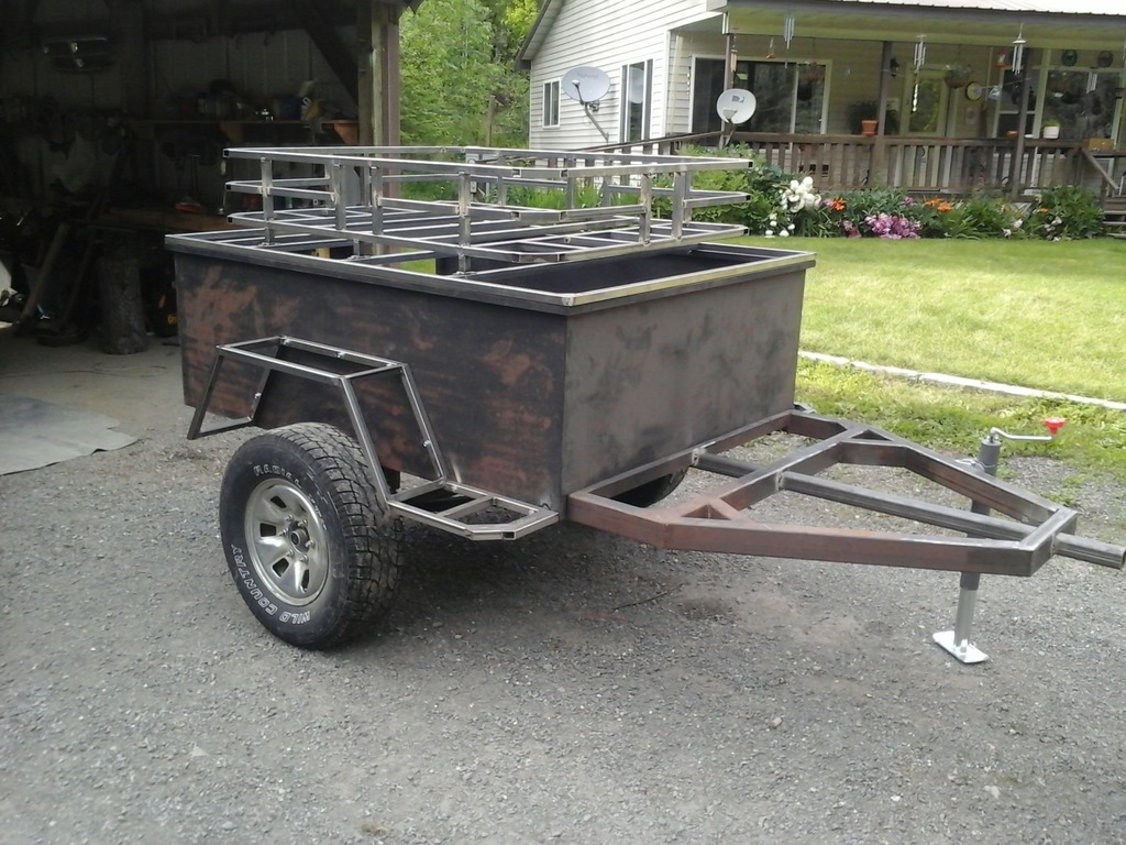

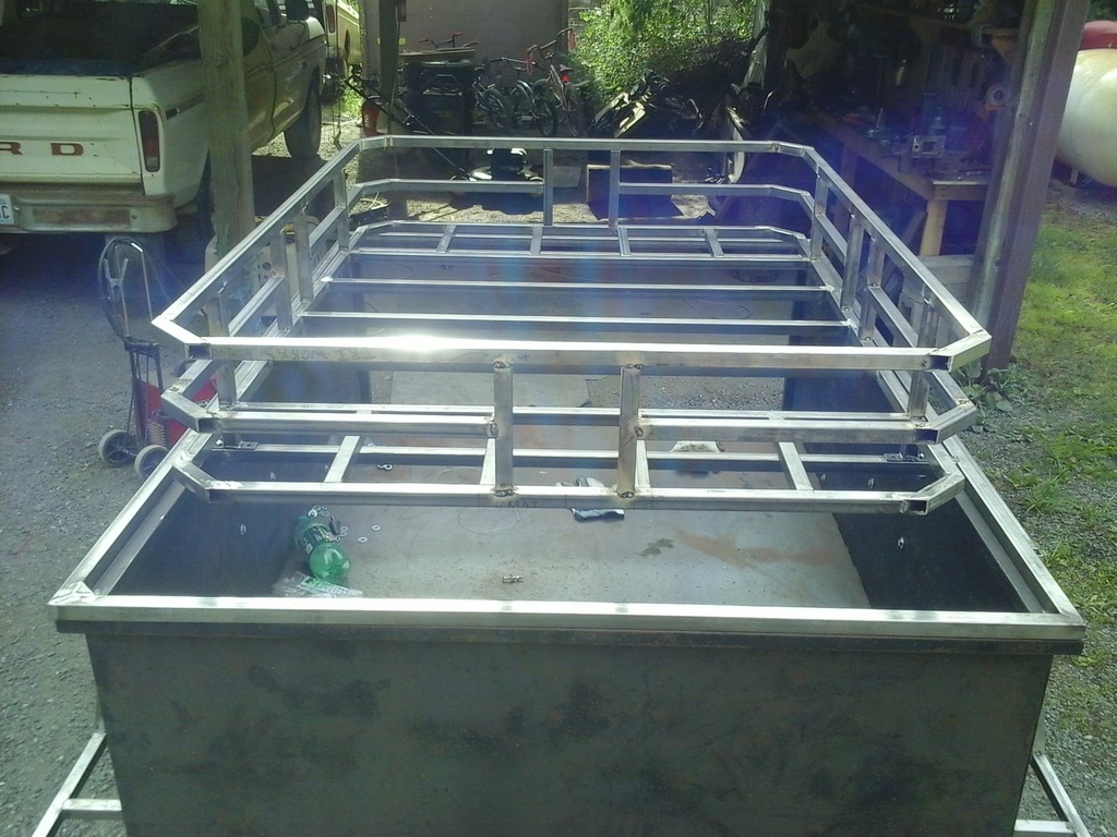

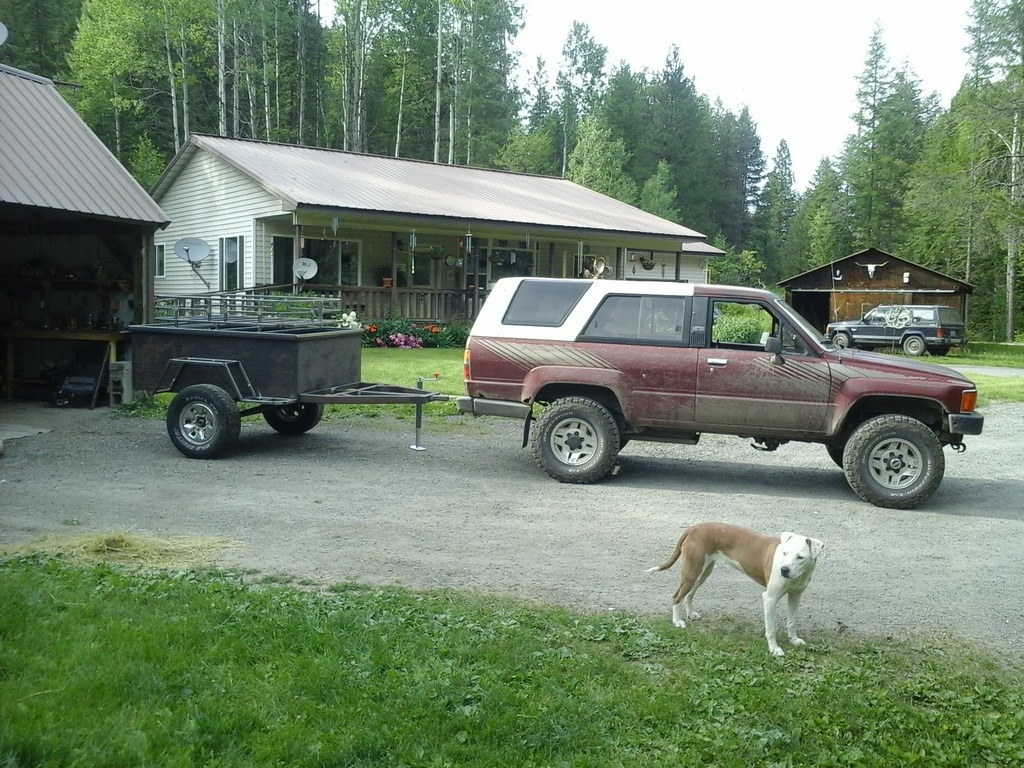

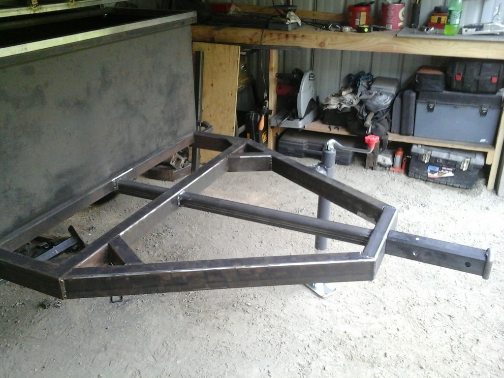

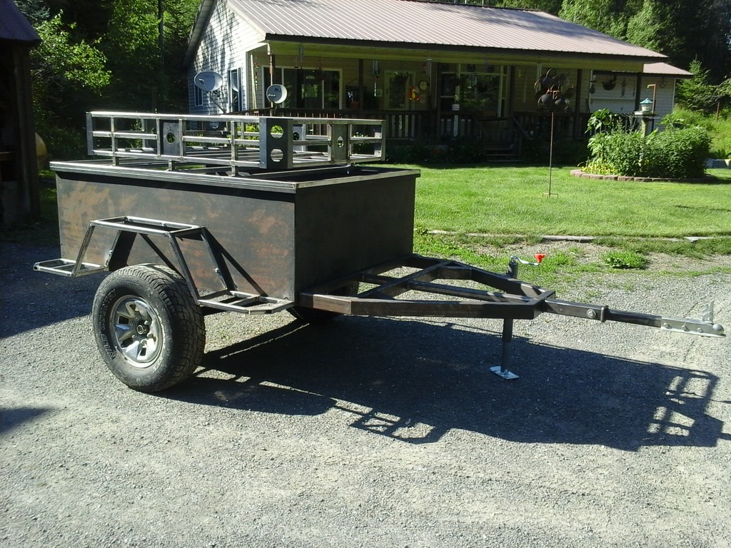

I haven't had much time to work on my 4runner, I been trying to finish up the offroad trailer project. I got the safari rack almost finished, I'm thinking about building a scaled down lower profile rack for my 4runner when I'm done with the trailer. Also reworked the trailer tongue and added a receiver so I can switch to a 3 axis offroad coupler. I haven't been on here as much lately, just thought I'd throw up some pics of what I've been working on.

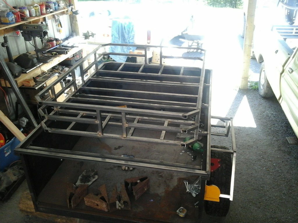

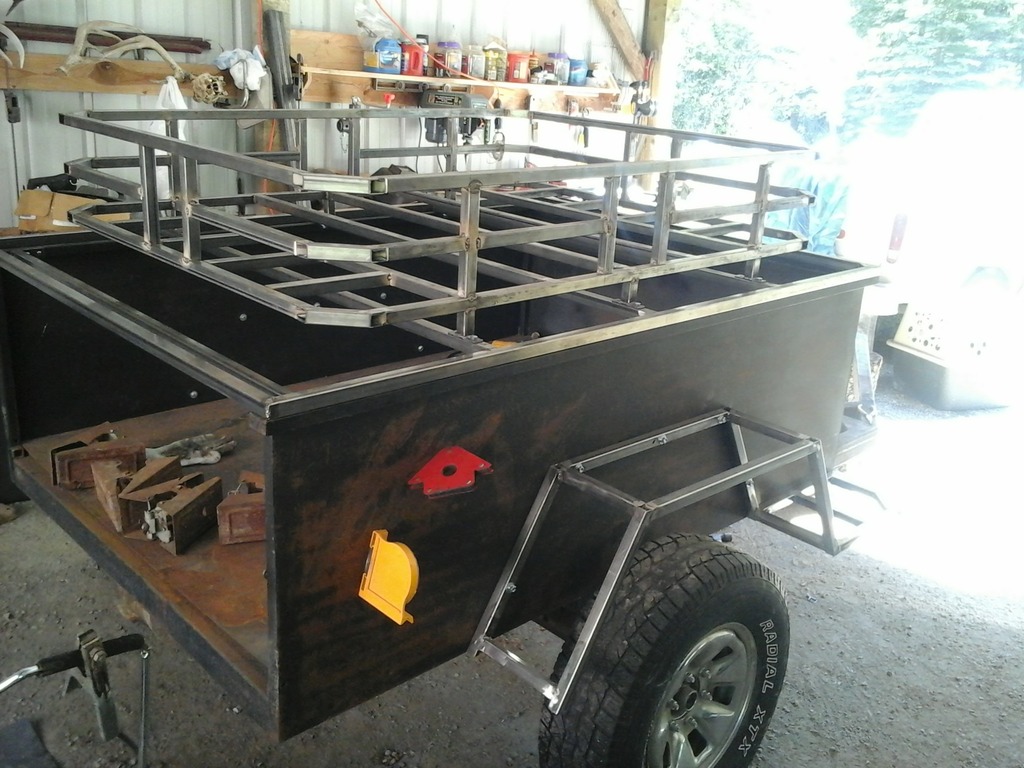

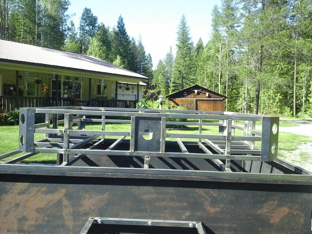

^^^I got the safari rack mostly done, added more cross bars for support, just need to wrap the 45° corners with sheetmetal to give the exposed cut 1" tubing a more finished look, and weld up the rest of the seams. Next I will take the rack back off and skin the lid and fenders with some 16 gauge sheetmetal.

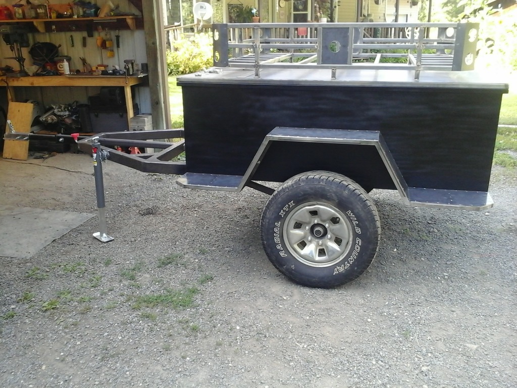

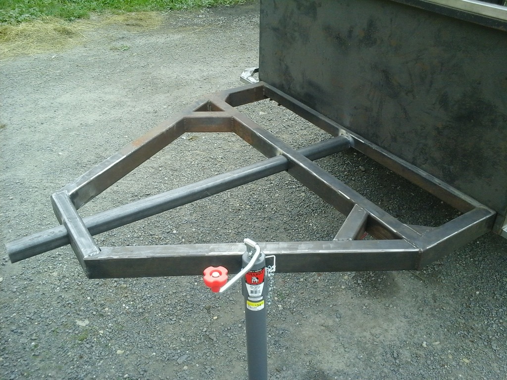

^^^Reworked the trailer tongue, got it nearly finished, also got the tongue jack mounted.

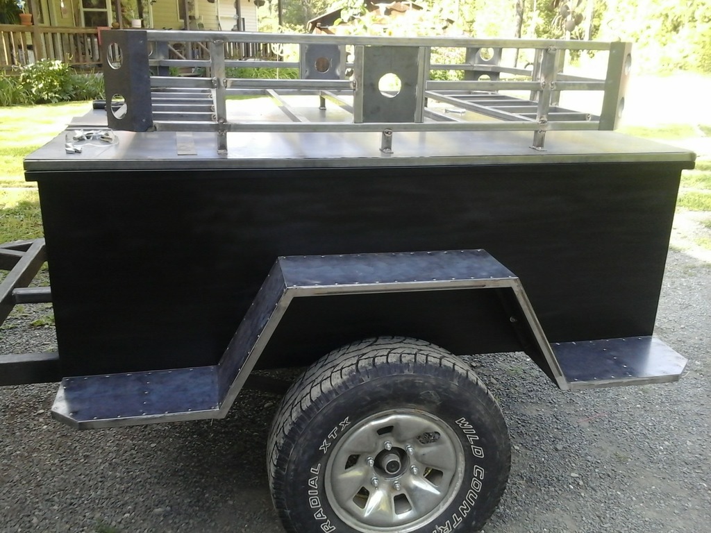

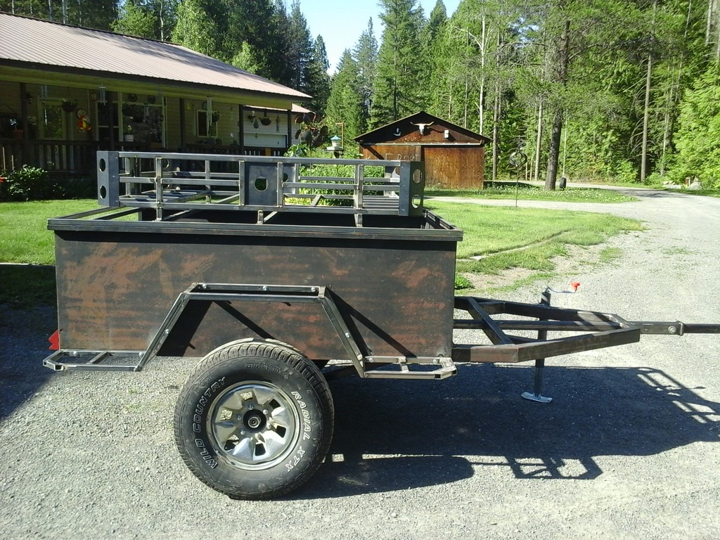

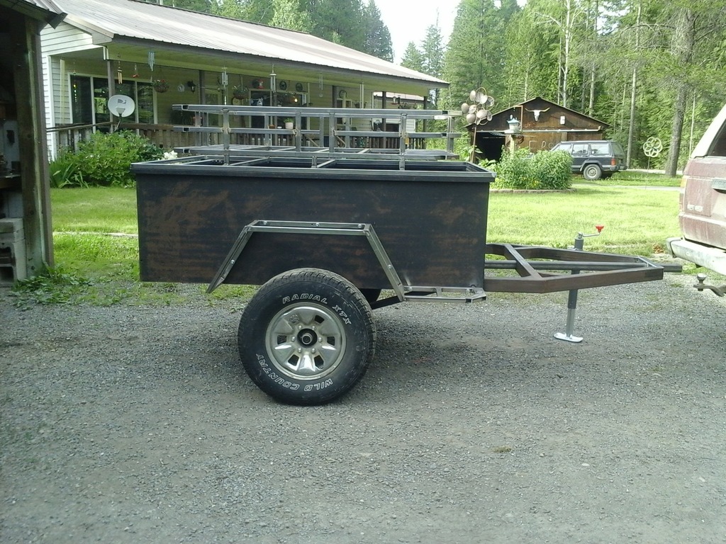

^^^ I got the cargo rack finished up, and built the rear steps behind the fenders, and skinned the fenders and lid with 16 gauge sheetmetal.

I never considered (needed) a trailer before now and with the kid too big to stuff behind the seats forcing the swap over to the 4Runner, the time may be now. I like your design and really like your skills as a craftsman. Bravo!

Thanks Les, that's a huge compliment coming from a craftsmen such as yourself! I'm liking how the trailer is taking shape, just wish it hadn't taken 4+ yrs to get it to this point, lol. If you decide to build a 4runner, what year/ generation body style are you looking to get?

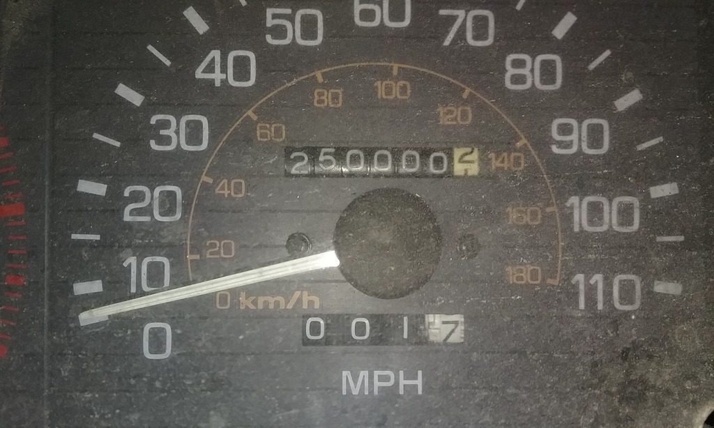

250,000 Miles
Not much to update, I've put about 7,000 miles on the 4 runner since I bought it and it's running great. I've been getting aproximately 20-21 mpg average. I've put about 5,000 miles on it since replacing the radiator with the aluminum Koyo radiator and 2 stage Toyota thermostat and so far I'm really happy with the setup. I haven't had the temp gauge spike since installing them, my aftermarket temp gauge never goes above 190°

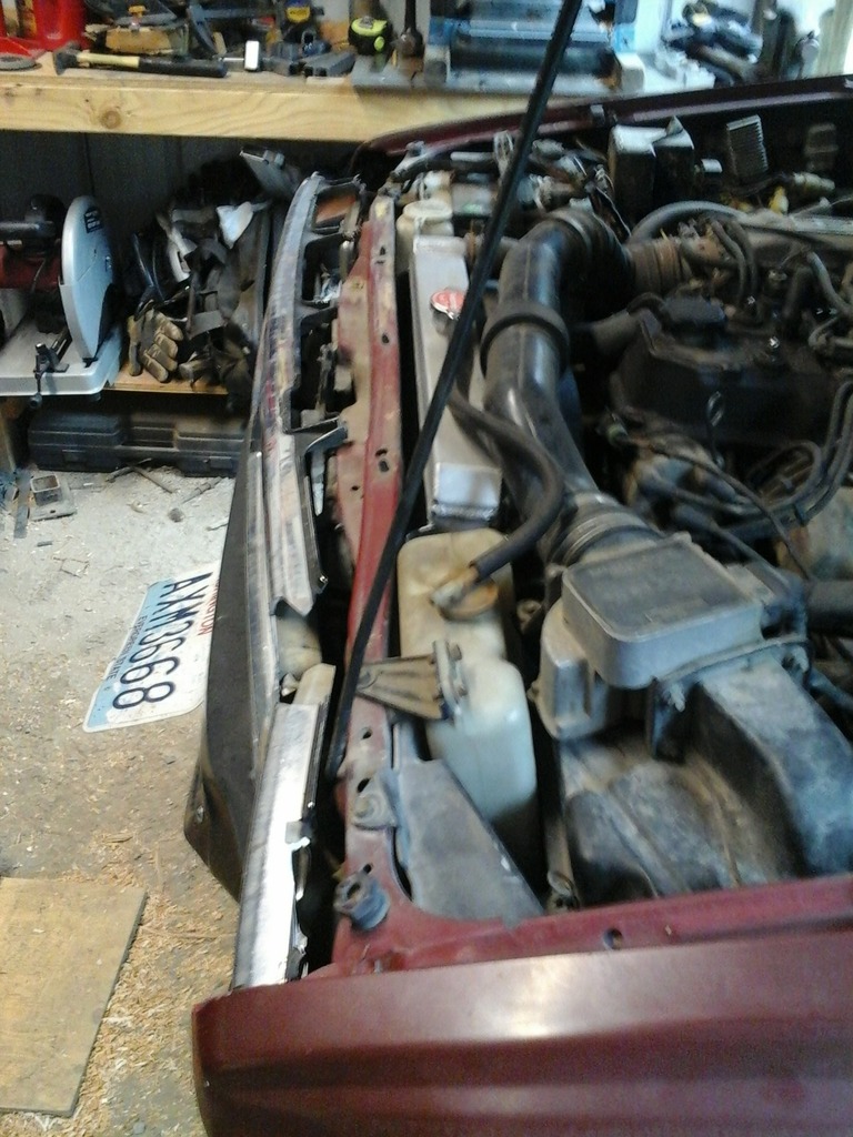

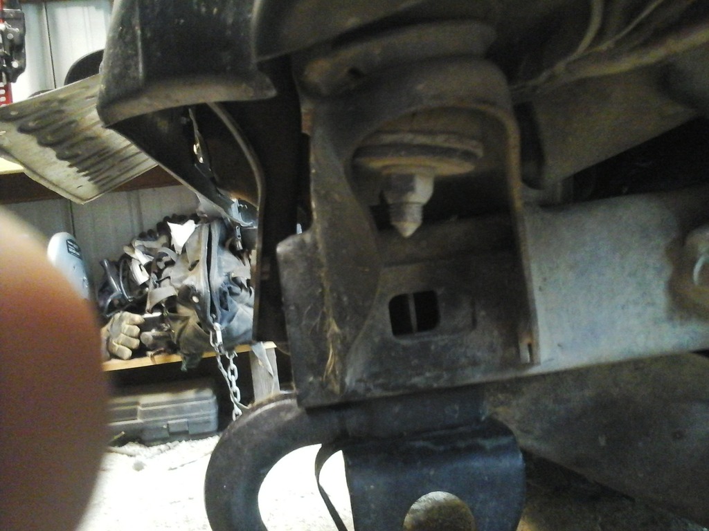

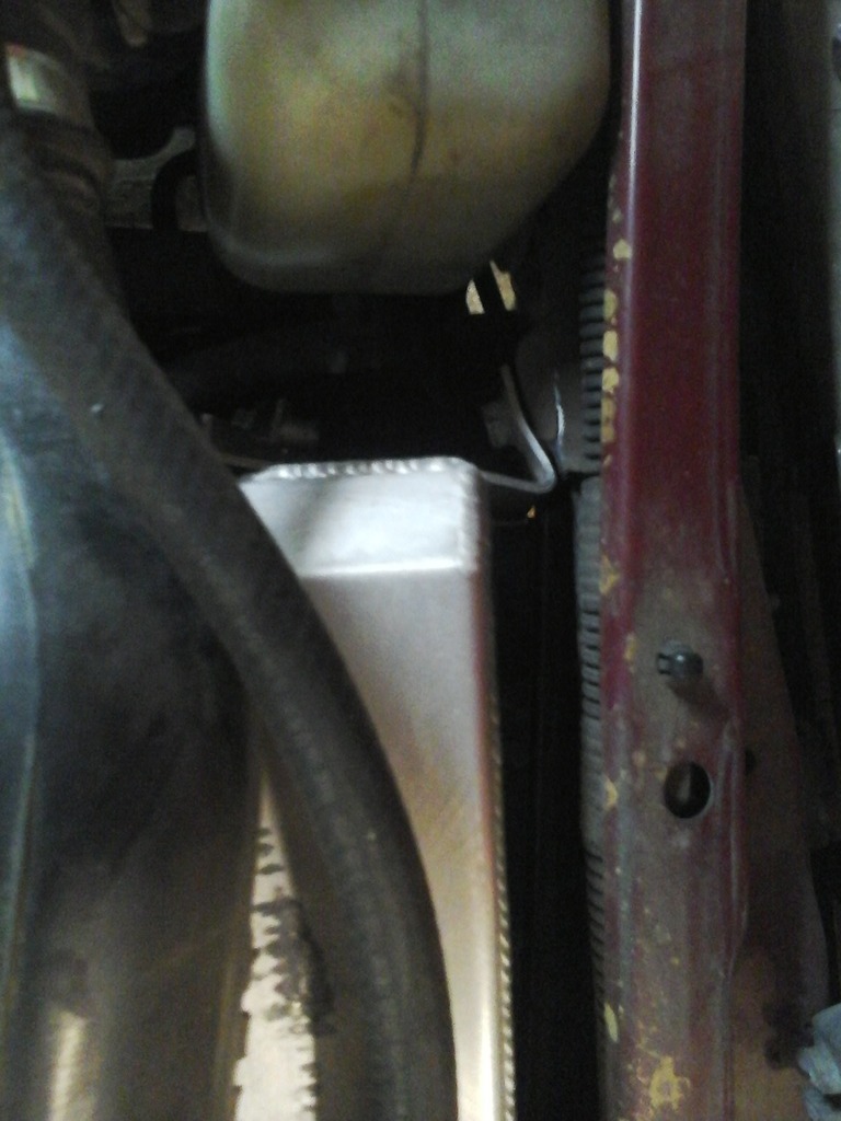

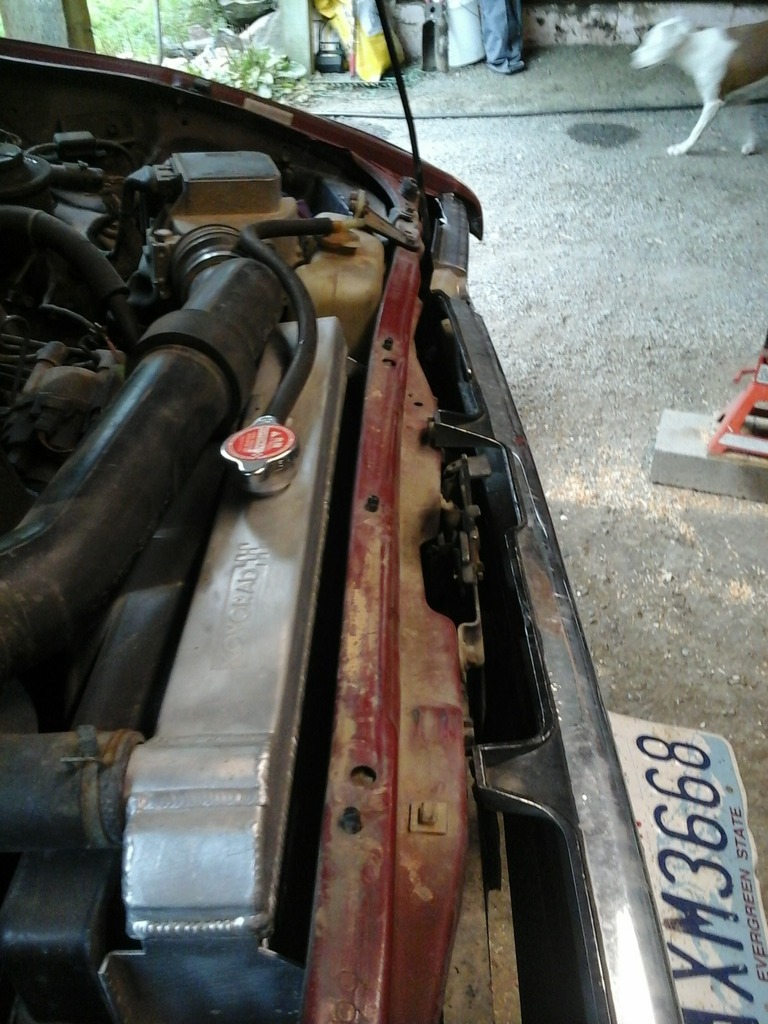

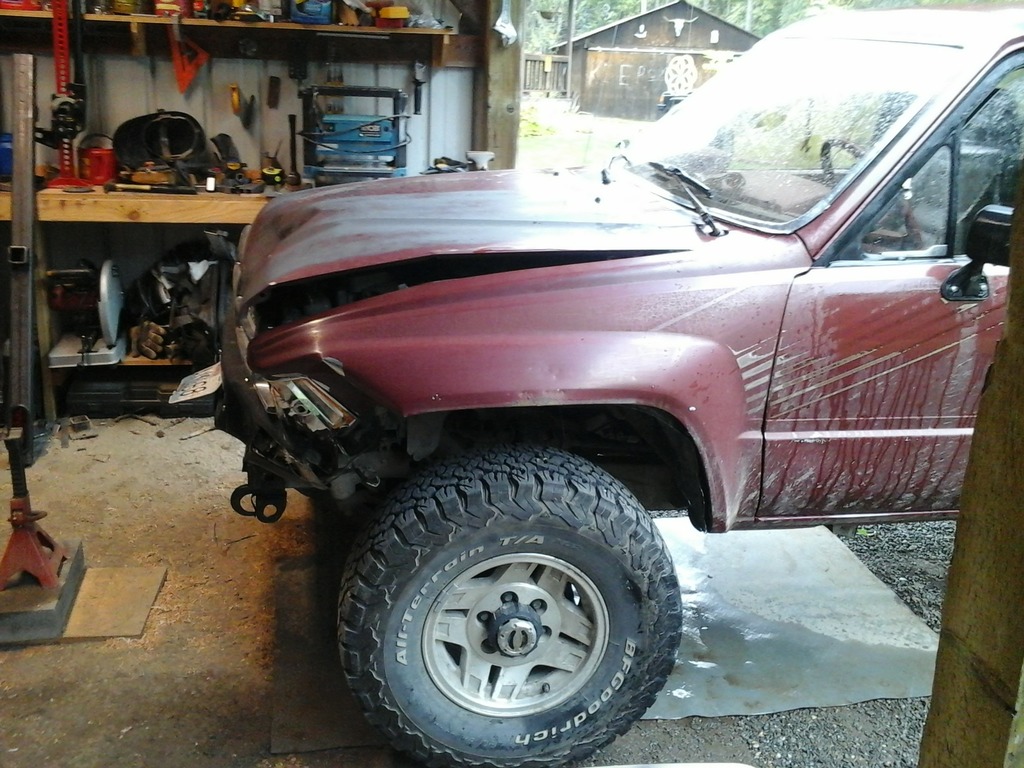

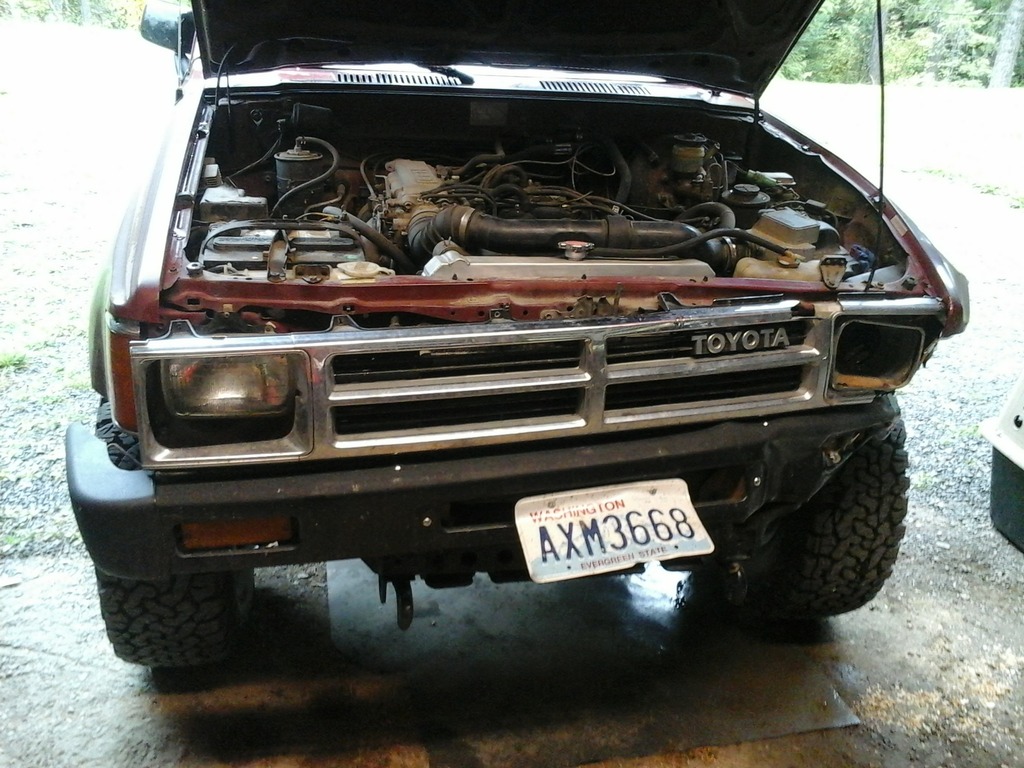

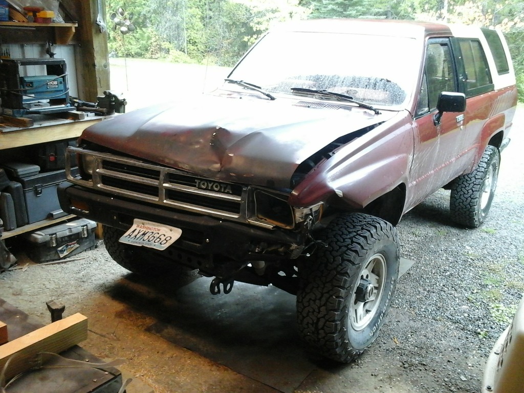

Have i mentioned how much i hate deer???!!!
Not the kind of update I like to post.
I was able to drive it home, I kept a close eye on the temperature gauge, not wanting to chance overheating it, but it was fine. I parked over some cardboard and surprisingly not even a drip from the radiator. Upon closer inspection it did make contact with the the fan, I have a Cresent half moon shaped mark in the fins where the fan hit, in one of the above pics you can see where one of the mounting brackets is bent...hopefully the radiator is salvageable. The fan shroud got pushed into the fan belt and sawed into it a bit, no pics of that. At the very least I'm looking at replacing the driverside fender, headlight bezel, probably the grill, turn signal, headlight and bumper. Depending on how bad the core support is and whether or not I can straighten it out and still have some structural rigidity I may have to replace that as well. In one of the pics you can see the core support/body mount looks like it's dented in, not sure if it's pushed up as well, it's hard to tell with all the twisted metal and weird angles, kind of makes it hard to tell, I'll have to do a closer inspection on everything after stripping it down.

Wow dude that sucks! Sorry for your loss, lol. But the trailer looks awesome. Might be time to put your fab skills to work on a deer proof front bumper. Keep up the good work.

Thanks man. yeah I won't be putting another one of those Chinese ebay bumpers back on there, lol. It looked the part, but that was about it. The metal was probably half the thickness of the factory bumper I took off there. Yeah I agree it's definitely time for a big old locomotive/ mad max style cow catcher bumper, lol.

Ouch!!! You have had some bad luck lately with trucks. You might be able to get a jack and some wood and push the core support out. If you have to replace the core support, it is not that bad of a job. I had to on my 86. I just bolted mine in and have no intentions of welding it back together. If you do have to replace the core support, get a spot weld cutter. It is a drill bit that makes cutting the spot welds easy. Dont try and drill them out. Harbor Freight has them for like $6. It looks bad and you will need to get several parts, but I dont think it is near as bad as it looks. The worse part I think is getting the inner fender lined back up.
Your trailer is looking great. Might want to consider some Mad Max bumper for the deer. I nearly hit one a few days ago. Not the way I like to go deer hunting.

Hi Terry. Yeah I've had a pretty bad streak with hitting animals since moving up here, I hit a deer in my wife's old durango, a cow in my old ford, and a turkey in my 86 4runner (they can do alot of damage if they're flying). My wife was joking and said the only animals left that I haven't hit is a bear and a moose, lol.
I'm definitely over due for a bumper upgrade, I will probably build my own with some sort of grille guard as well since this will more than likely will happen again. I need to look into upgrading my headlights too since I do alot of night driving. Every animal (except the turkey) I've hit coming home from work at night.
Thanks for the tip on replacing the core support, that sounds like the route I would go if I need to, I would probably bolt the new one in place as well, I don't really see the need to re-spot weld it in place. I found a local guy that has over 40 toyota pickups/4 runners from 85-95' so I'm hoping I can source most of the parts I need through him once I have some extra money. In the meantime I will have to drive the old ford. I wish I had the money, I found a 89' 4 runner on CL for $550 that has a really nice body and interior, power windows/ locks etc, but it's a 3.0 with an automatic. For the price tho it would be worth it to either do a body swap, or swap my 22re/5speed and harnesses over to it. http://kpr.craigslist.org/pts/5779199325.html
