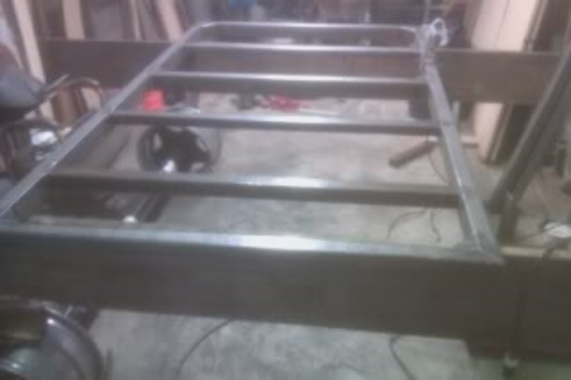

I started this project over a year ago. The goal was to build an offroad capable camping trailer that I could pull double duty with. Since I had sold my DD truck to help finance the build on my 86' 4runner, I wanted to build a trailer small enough to run trails, yet big enough to haul some lumber (or a sheet of plywood) home from the local hardware store.
The plan, make the inside dimensions 50"W x 72"L with the tailgate down around 96"L)
Also instead of using leaf springs I wanted to do a 3-link suspension with Jeep TJ coil springs. I'm using a 3500lb rated trailer axel, It's actually wider than the Toyota axel width (it's 63" from hub to hub) but I had to run a wider axel to get the 50" inside trailer width I was shooting for.
I bought some brackets from Ballistic Fab to mount the coil springs to the trailer axel and to the frame. I also bought shock tabs, and tabs to mount the links, and some poly bushings for the link ends.

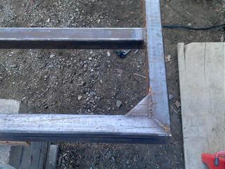

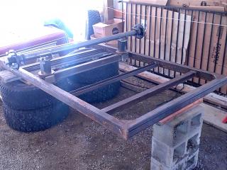

I pretty much got the majority of the trailer frame built last year (minus the tongue/hitch) using 2x3" tubing.

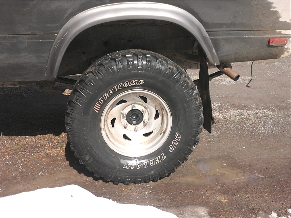

^^^These are the 33x12.50" tires (gotta love the centerline directional rims!) I'm going to run for now, just scored them today I traded the 31"x10.50's that were on my 83' Toyota for these. Now I will have 2 for the trailer and a spare for the trailer and a spare for the 4runner. I have another set of 31"x10.50's that I'm going to put on my 83'.

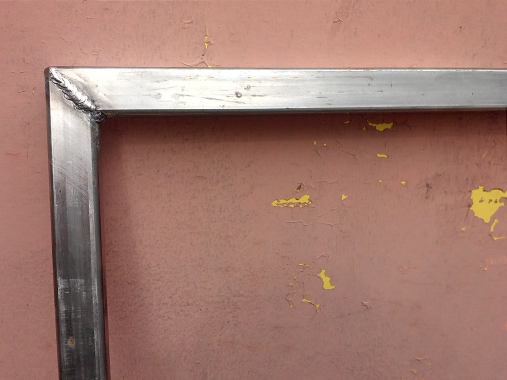

Today I went and bought some steel, I got 8-1/2 feet of 1-1/2" square tubing .250 wall, to use for my 3 link. And I bought some 1" square tubing to use as the frame work for the bedsides. The shop only had one 20' stick, so I had to order the rest and will have to go back and pick up the other 3 sticks in a couple days.
The main reason I decided to use the square tube for my links instead of round tube was because I don't have a tubing notcher, I have notched round tube by hand with a grinder, but it was a pain, I just figured it would be easier to notch the square tube and keep both sides even.
I didn't get very much work done on the trailer today, I got one side of my panhard bar notched.

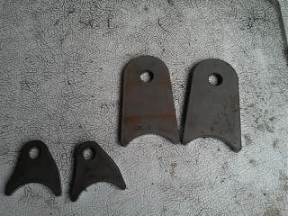

Here's a pic of the shock tabs I have and also the axel tabs that I'll bolt my links to

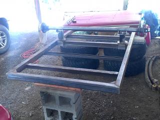

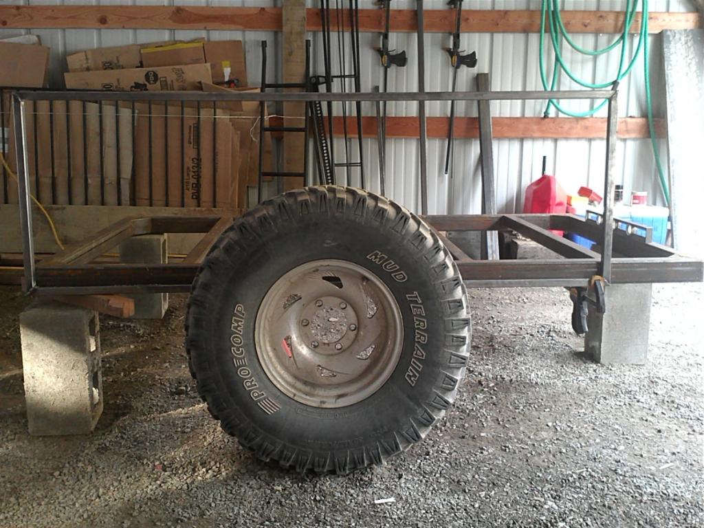

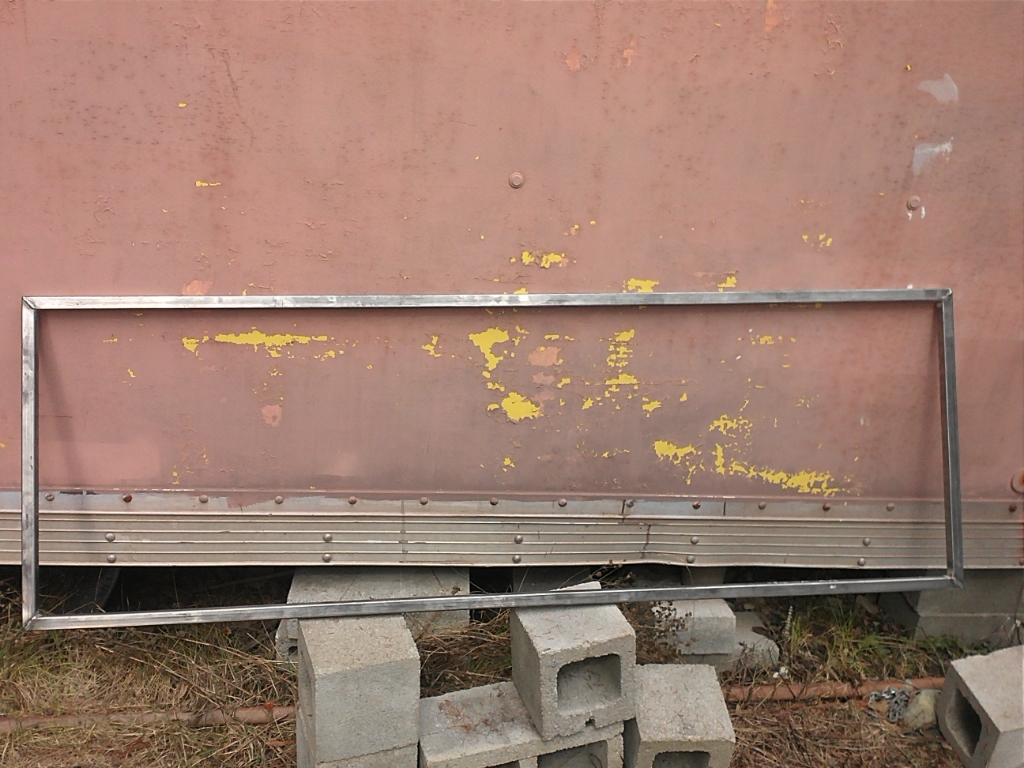

Today I got the frame built out of 1" square tubing for one of the bedsides. It measures 73"Lx 24"H. The 1" tubing that I ordered was supposed to come in yesterday, but won't be in until Friday so I cant start on the other side yet.
I still need to order some Jeep TJ coils off Ebay, I will probably use the rear coils, they are a little shorter than the front ones.

^^^It looks kinda out of square in the pics, but it's just an illusion, lol

^^^I thought I'd roll a tire in and get a visual of how it might look, it will definitely sit higher than this once the coil springs are installed.

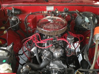

*EDIT* HERE IS A PIC OF WHEN I FIRST DID THE ENGINE SWAP

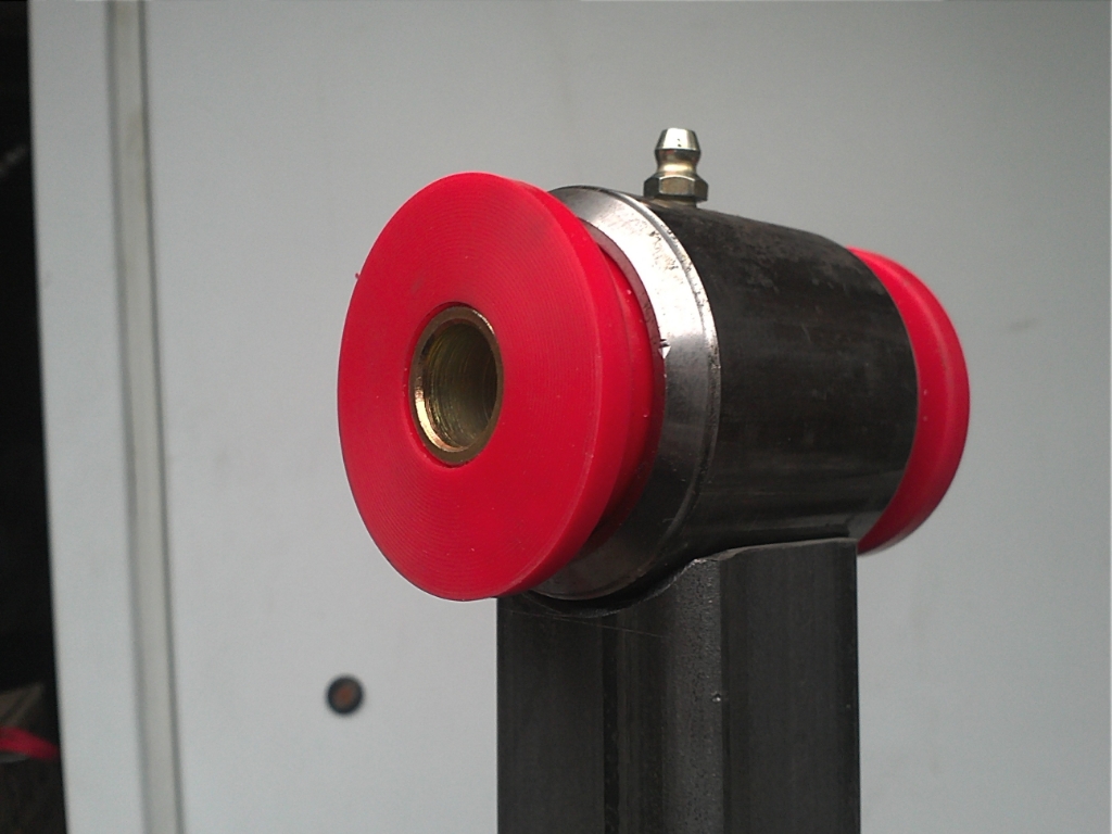

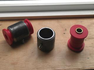

Thanks for the link Tom! That coupler looks pretty cool and plenty strong! I think I could copy that and make something similar. Maybe use those bushings like I'm using for my link ends (in my first post)....?

Thanks for posting the engine shot, looks good and I like how clean it looks under the hood. Lots of space would be a nice change...

No problem, sorry the pic was so small, I'm in the process of going back and editing some of my post and re-sizing and adding some pics. Yeah it has a lot of space on the sides of the engine, but not in front, it's really tight between the radiator and the waterpump, I had to trim a little bit of the core support to make room for the electric fans to fit.
