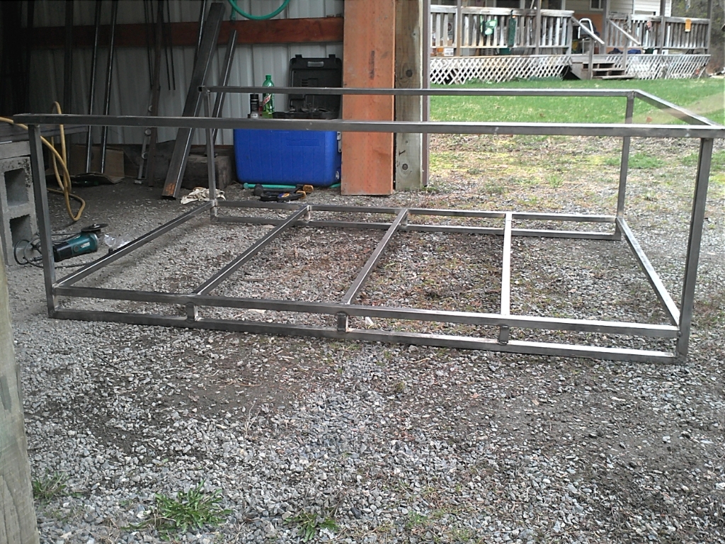

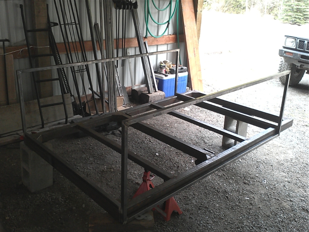

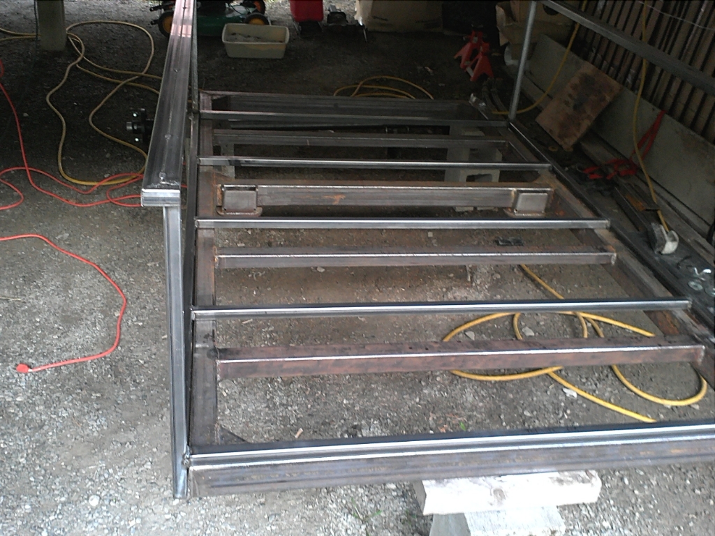

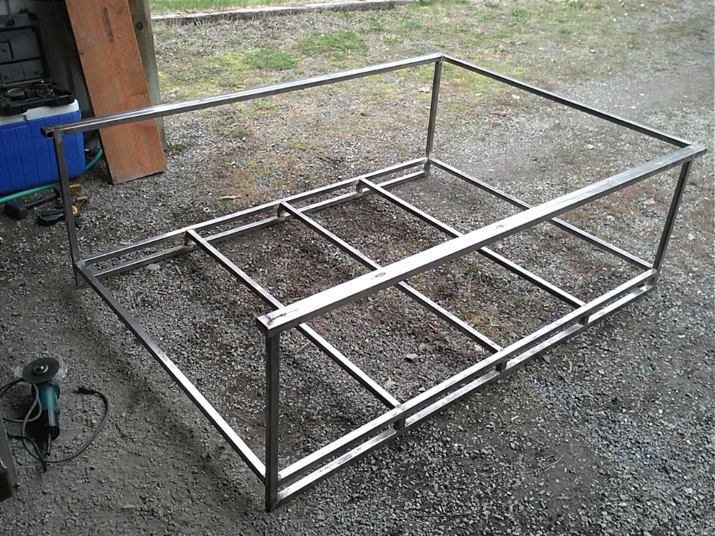

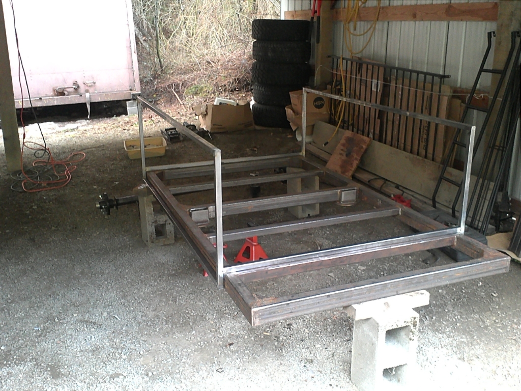

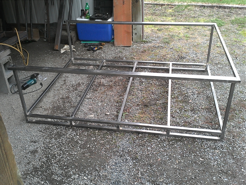

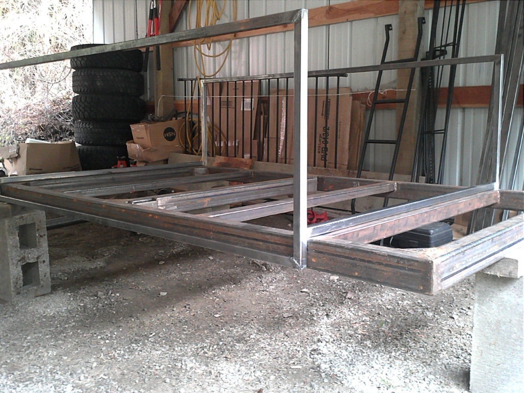

I got a little work done on the trailer yesterday. I got the other bedside built and 2 floor cross members tacked in place so it sits on the trailer frame now with out the use of any clamps.
I've been running into a few problems since building the trailer frame a year ago. Just little things, kind of like "what was I thinking when I did this" sorta of stuff, lol. I thought I had put a lot of thought into the trailer, and had plans drawn up on Microsoft paint program, but that was on our old computer, which has sence died... so I have kind of been winging it and changing things as I go.
One problem I noticed was that I made the overall trailer frame width 50" with the intent of having the inside usable space 48"....well with bedsides being made out of 1" square tube and attached flush with the outside of the trailer frame that leaves me exactly 48"...with the idea of this trailer being able to be multifunctional, If I wanted to say haul a sheet of plywood in it, it would be wedged in there pretty tight... I don't know why I didn't make the frame an inch wider. I thought about just going with it since now I have a pickup to haul stuff in, but I would like to stay with my original multipurpose plans, in case I'm pulling the trailer behind my 4runner or my wife's Durango. So instead of making the bedsides of the trailer flush with the trailer frame, I extended them and make them overlap the frame, so now my inside usable space is 50" with the tailgate down, I just hope that the offset of the wheels that I have still allows enough clearance with out rubbing. Here's a few pics...

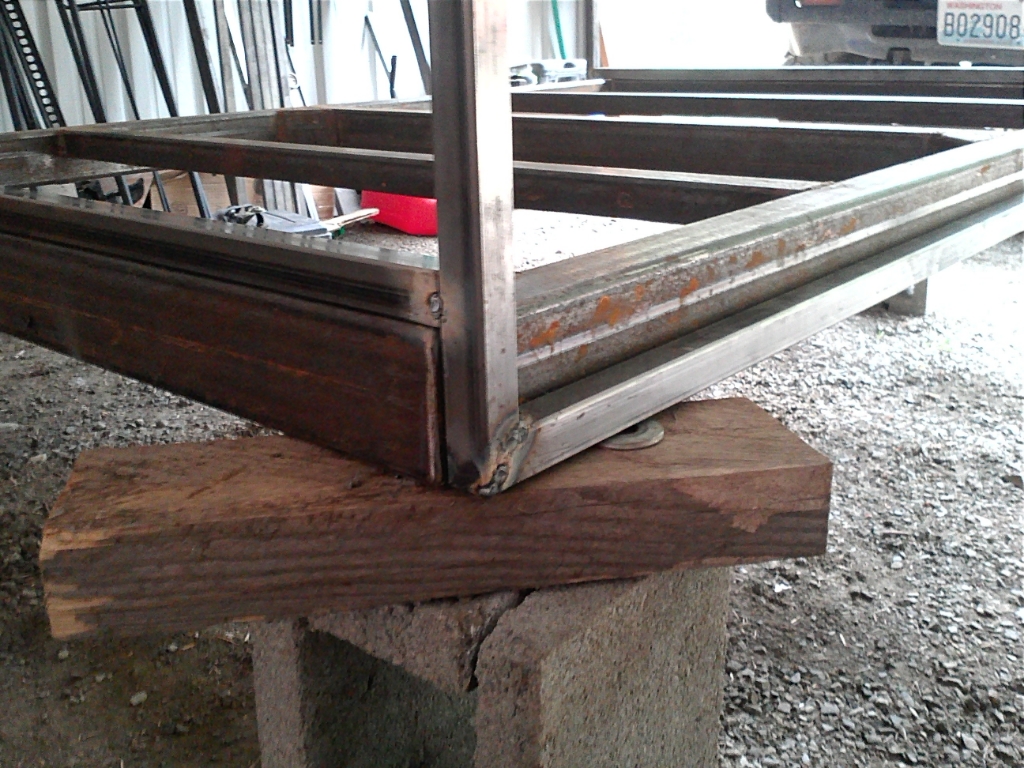

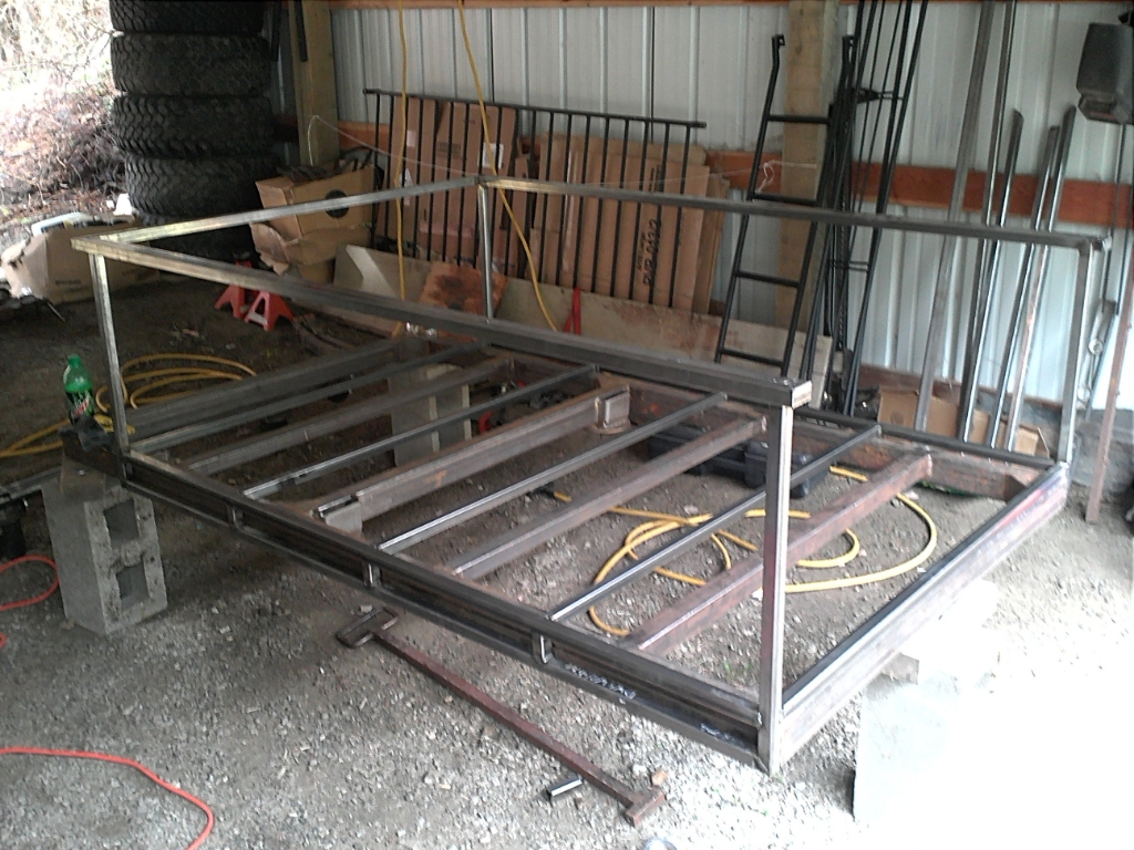

I got a little more work done today. I got the floor crossmembers welded in and the bedsides finished, I ran out of welding wire so I'll have to finish welding it up tomorrow, I also still need to build the tailgate frame.

^^^ I decided I wanted a 1" overhang on the bedsides and had some 1" tube left so I doubled it up to make it 2" wide, I eventually want a hinged tonneau cover with gas struts and figured this would give me more area/options for weather stripping, (and I just think it looks better). As a side note the trailer body frame work is sitting on the trailer frame backwards (it started raining and I was in a hurry) when I turn it around the body cross members will align with the trailer frame cross members and will help support the the floor and give me places to bolt it down.

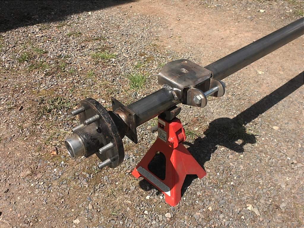

I have done a little work to the trailer. I got the tabs for my links welded to the axel. I also went ahead and bought some Firestone Ride-Rite helper spring Airbags (P# 6781) for it to replace the coil springs I was going to originally use. (The air bags are rated at 4800 lbs at a max of 100 psi) Now I need to change the coil spring brackets and fab up some new ones for the air bags.
^^^ I was still able to use the bracket that was intended for the coil springs that I had already welded to the axel I just had to enlarge the hole a little to bolt the air bag to it.

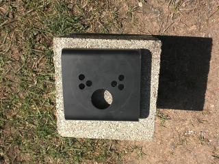

I wasn't able to re-use the upper coil spring brackets for the air bags so I will cut down and modify the upper air bag bracket and weld this to the frame.
