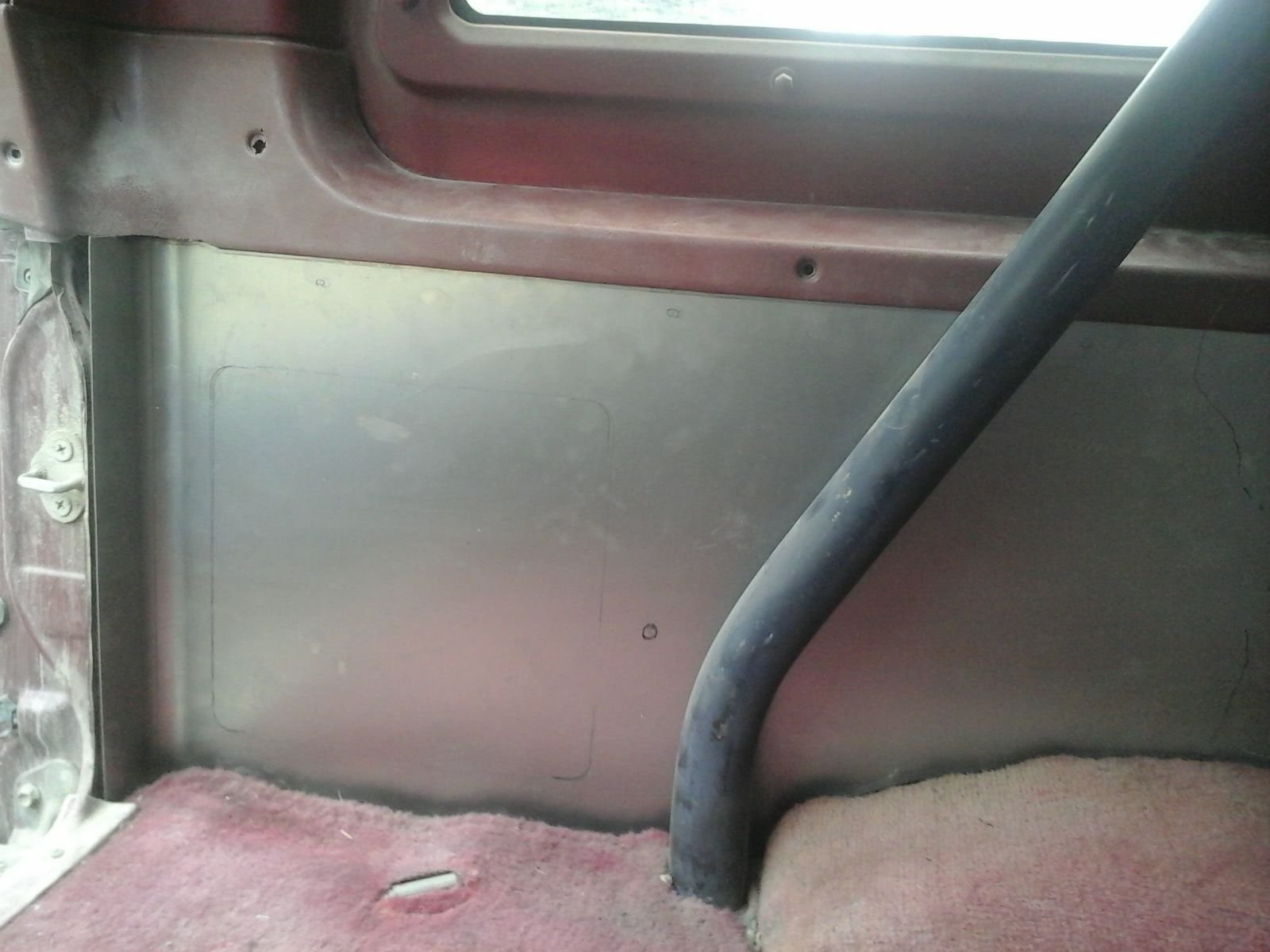

Hey buddy you're welcome to stay anytime, ha,ha. The built in sub enclosure would be cool! I wanted to use aluminum for the panels too, but thought it would be a good idea to get some practice in using the beadroller on some less expensive materials first. The 4x5' sheet of 18 gauge was around $43, I haven't priced aluminum yet, but have a feeling it's going to expensive.
Here's a couple pics of where I'm at with my driverside cargo panel, I still have work to do on it, and need to cut out for the door. I'm thinking of doing the tailgate cover to match, and will also be building a new locking center console/armrest/cupholder too.

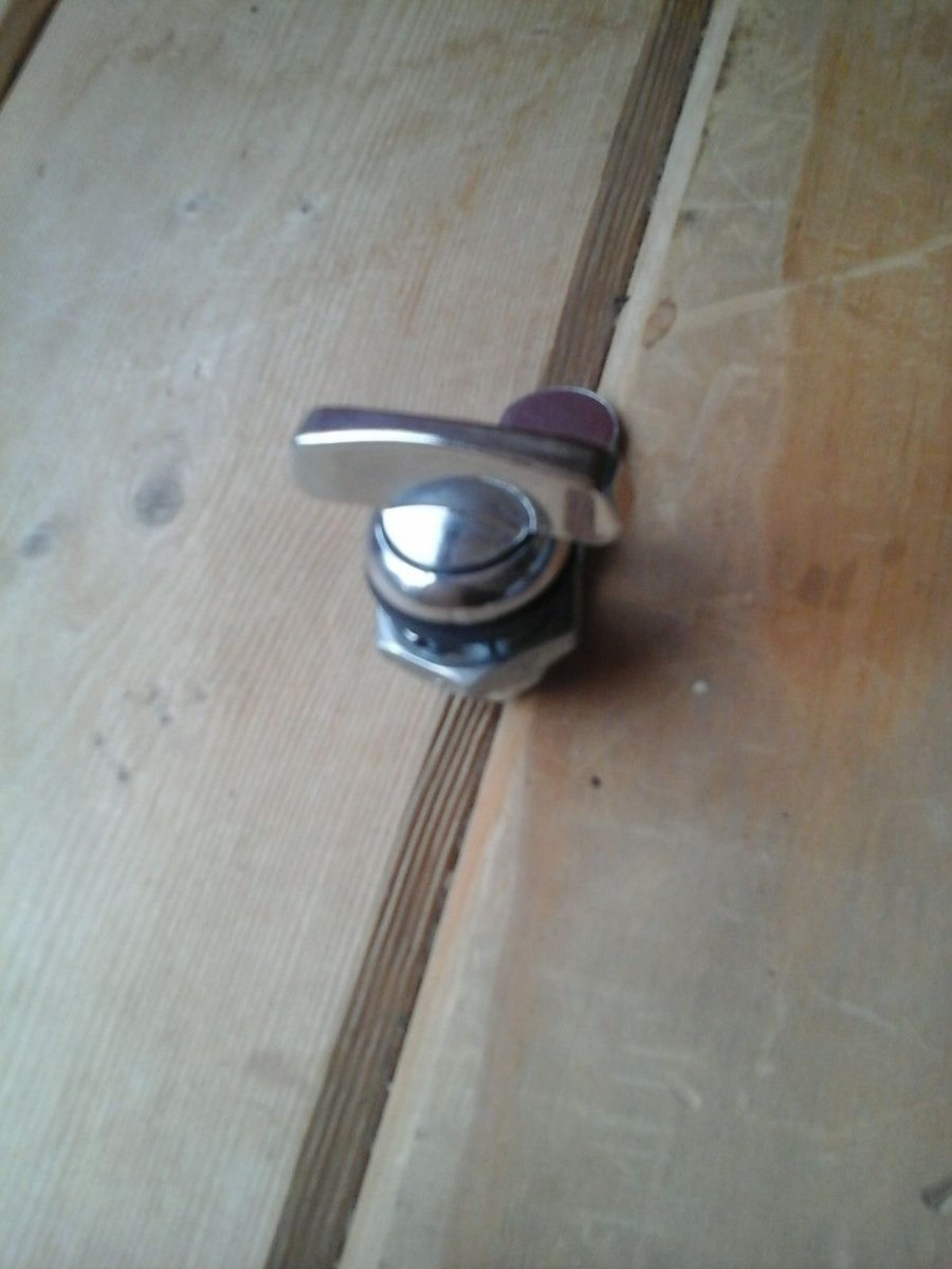

Looking good. And armored to boot. Are you going to use the factory latches for the cargo doors or something aftermarket?

Looks aewsome man, I need to do the same, but I'll be rubbing the rear of mine soon for long travel and bypass shocks to fit through. So that project will have to wait.

Hey Ed! The shears will really come in handy. And I love the Brake setup you have there with the press.
Great work so far on the replacement panels. If you need anything plasma cut, do not hesitate to ask.... I can cut and ship whatever parts you want.

Thanks Tony. I'm not going to reuse the factory latches for the cargo doors, I only have one factory door, so instead I found these on amazon:

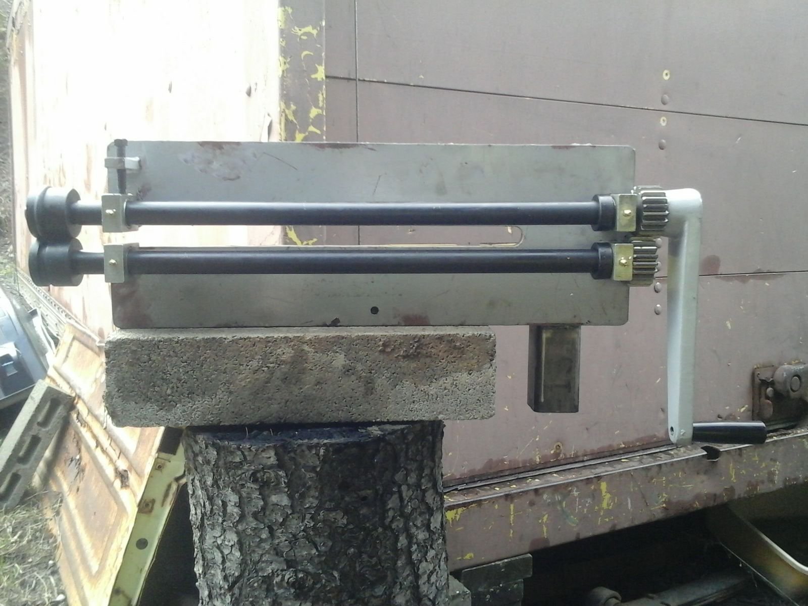

I only had a couple of hours today, so I worked on my beadroller a little bit. From what I've come across in my research when I was looking to buy an affordable beadroller is that the lesser expensive ones tend to flex when rolling a bead. This is because they started making the frame from 3/8" thick steel plate, some of the older harbor freight and Woodward Fab units used to be made of 1/2" thick plate. This causes some distortion in the bead on the panel and less than desirable results, because the male and female dies aren't staying in consistent alignment. An easy fix is welding some additional plate or in my case square tubing to stiffen up the beadroller frame. I had some 2"x2" x 1/4" wall square tubing laying around, so that's what I used, kind of overkill, this sucker is real heavy, but should work alot better.
^^^These pics show it upside down, that 4" stub I left sticking out will be where I mount it to a stand.
^^^Right side up and re-assembled. I have a couple more mods to do before I break it back down to paint...if the weather ever warms up enough for me to paint :/

Heavy is right. That little Woodward Fab shear I have is heavy. Your gonna need to fabricate a forklift to move your tools around. Great modification by the way. Have you thought anymore about doing the floorpans?
