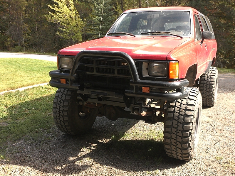

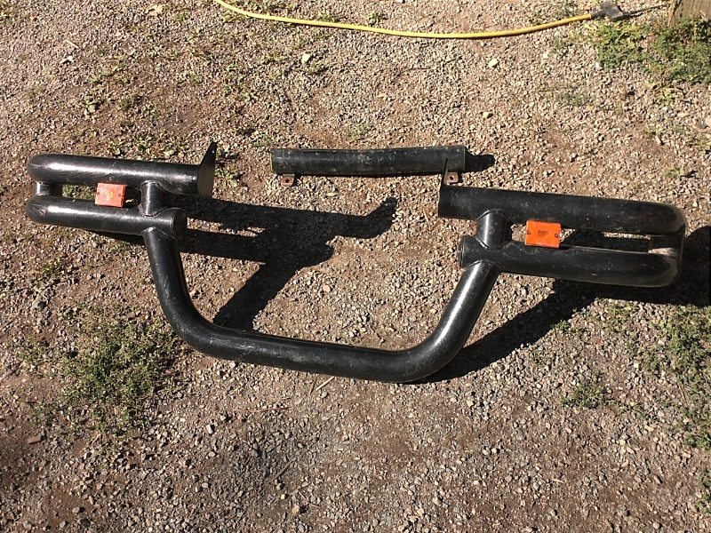

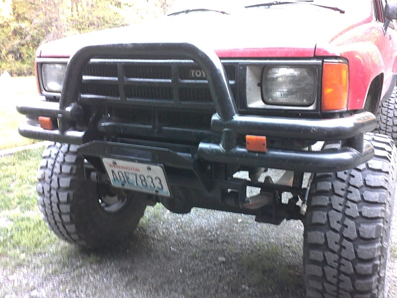

^^^ cut out the bottom tube, it was kind of a pain because the bumper has a bend in it, made it hard to get the angle cut just right...no turning back now!

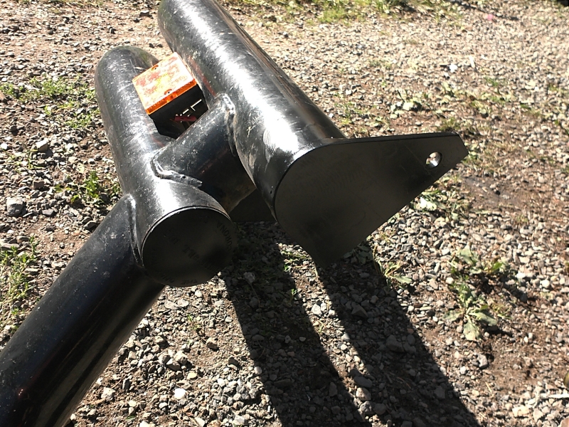

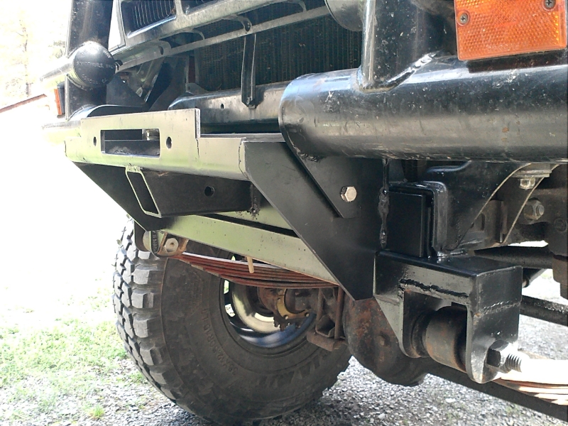

^^^made a bracket that caps off the cut bottom tube and also mounts the bumper to the winch plate.
^^^When I cut the bumper, I was about an 1/4" off on this side, hence the gap, I'll try to fix it today.
^^^I think it will look better once a winch is mounted and occupying the giant open space, lol. Today I just need to remove the winch plate and finish up some welds, going to use my 240V stick welder for all the finial welding. I also have all the parts cut out to make a license plate holder that will slide into the front receiver tube.

Looks great ED!! I really like the way that turned out!!

Looks tough ED!!great job!!

Thanks Mark, I'm pretty happy with how it turned out too!
Thanks Chris!

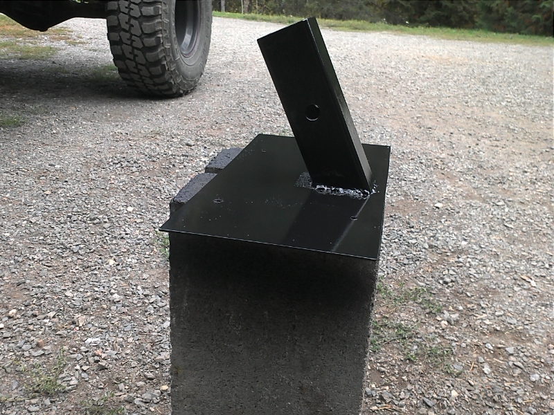

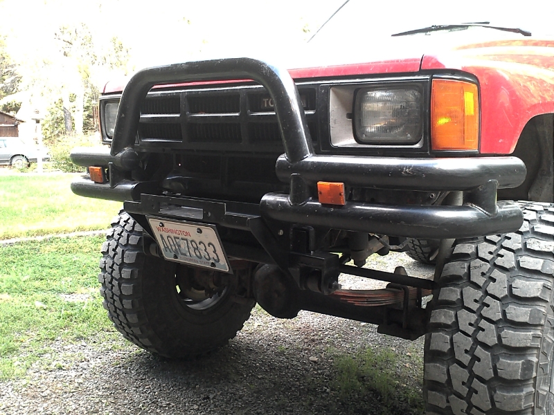

I didn't get to finish welding up the winch mount, but I did get the license plate holder done.
^^^I was to lazy to roll out my heavy duty extension cord to plug my welder into, so my welds look like crap, but are plenty strong enough to hold a license plate.
^^^I wanted to give it more of a skid plate look, but I barely had enough 14gauge left to just mount the plate. Good enough, I'll probably smash it on the first obstacle I come to anyway, lol.

Man I love that idea for the plate!! Looks awesome.

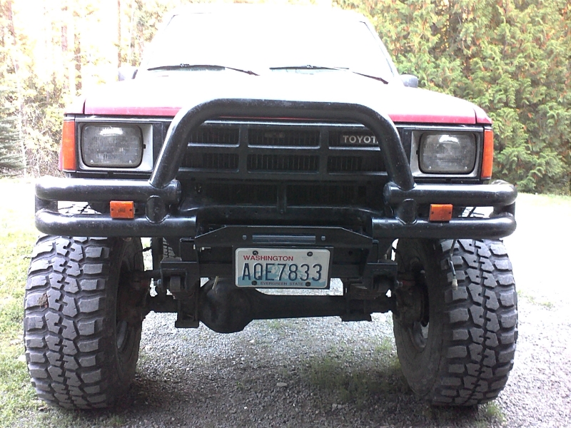

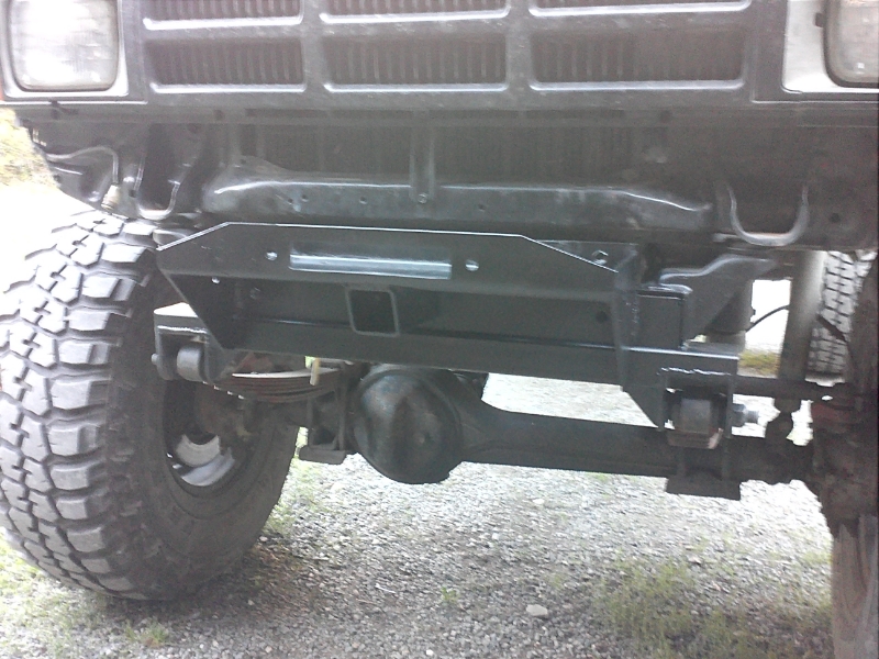

Today I finished up all the final welding on the winch plate, some of the welds look a little rough, I haven't stick welded in awhile, but they got good penetration, I think it will hold up fine. I didn't get the winch mounted and wired up like I wanted, I might wait until I get the metal to build the frame reinforcement plate, otherwise I'd just have to pull it back off anyway. Right now I'm just using 1/4" spacers to simulate the thickness of the reinforcement plate so everything bolts up correctly.
I also made some little triangle pieces for the front of the winch plate just to give it a little better appearance, I think it gives it a little cleaner look.

The triangle pieces definitely helped it out. Looks good.

Thats awesome! Nice idea on the bumper!
