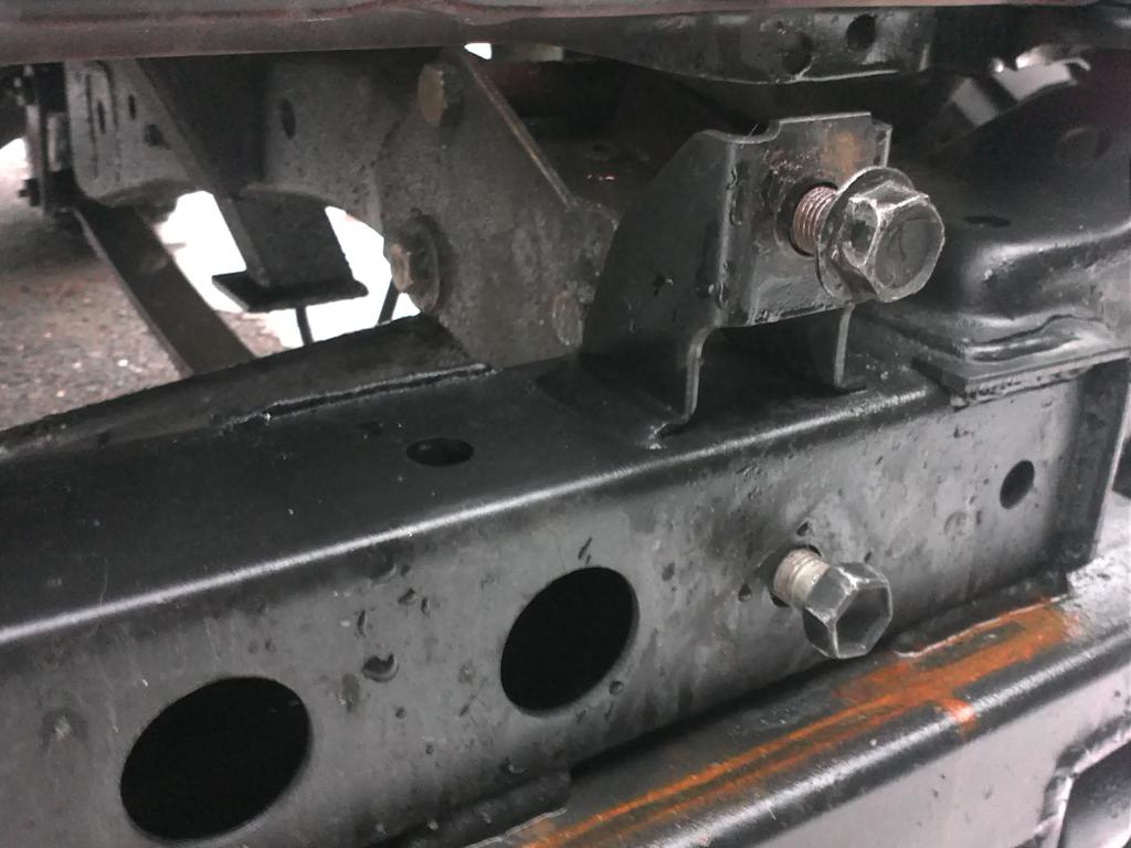

Tear down
I did a little research to find out what year motor I have, something I should have done back when I first did the engine swap. According to the stamps on the block I have a 78' Fairlane/Torino 302. So now I have a beter idea of what timing chain set I need to order. I pulled off the winch, winch mount and bumper. I also started stripping down the front grill area. I'm planning on installing my new CFR aluminum radiator (finally) since I had to pull the old radiator out to get access to the timing cover.

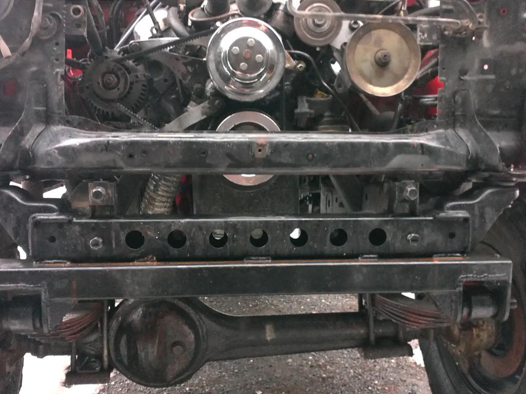

^I got the radiator and electric fans pulled out. I also pulled out the hood latch mechanism, since I will be rebuilding the core support around my new radiator, I wont be able to retain the hood latch. I'm just going to order some hood pins.

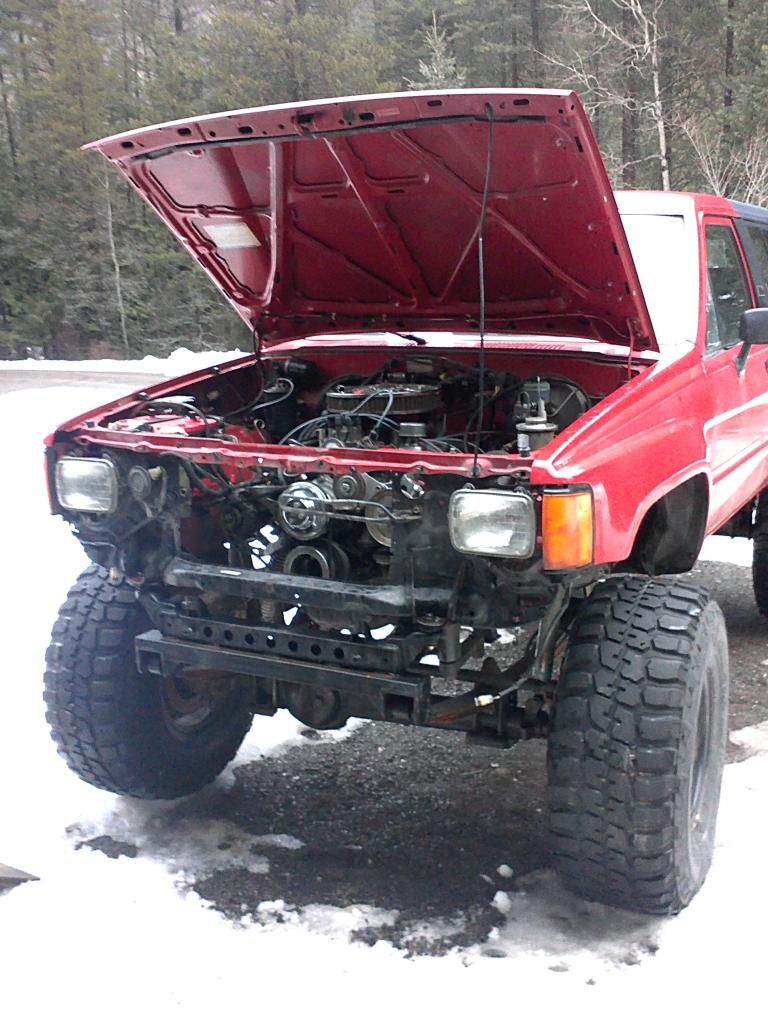

^My new radiator is going to get pushed forward to make room for the fan shroud and new 14" electric fan. It's literally going to be sitting on top of the crossmember. I'm going to have to remove the little brackets (where the top bolt is in) so I'm going to have to rethink how I'm going to mount my winch.

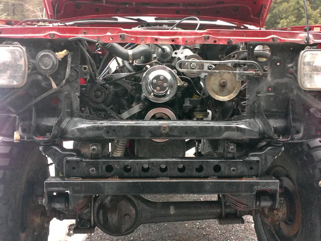

^the core support crossmember that is directly above the frame crossmember is going to get cut out. I will build a new one around my radiator and tie it back into each side of the original core support. I unplugged all the wiring and pulled it back over to the passenger side so I can start cutting the core support.

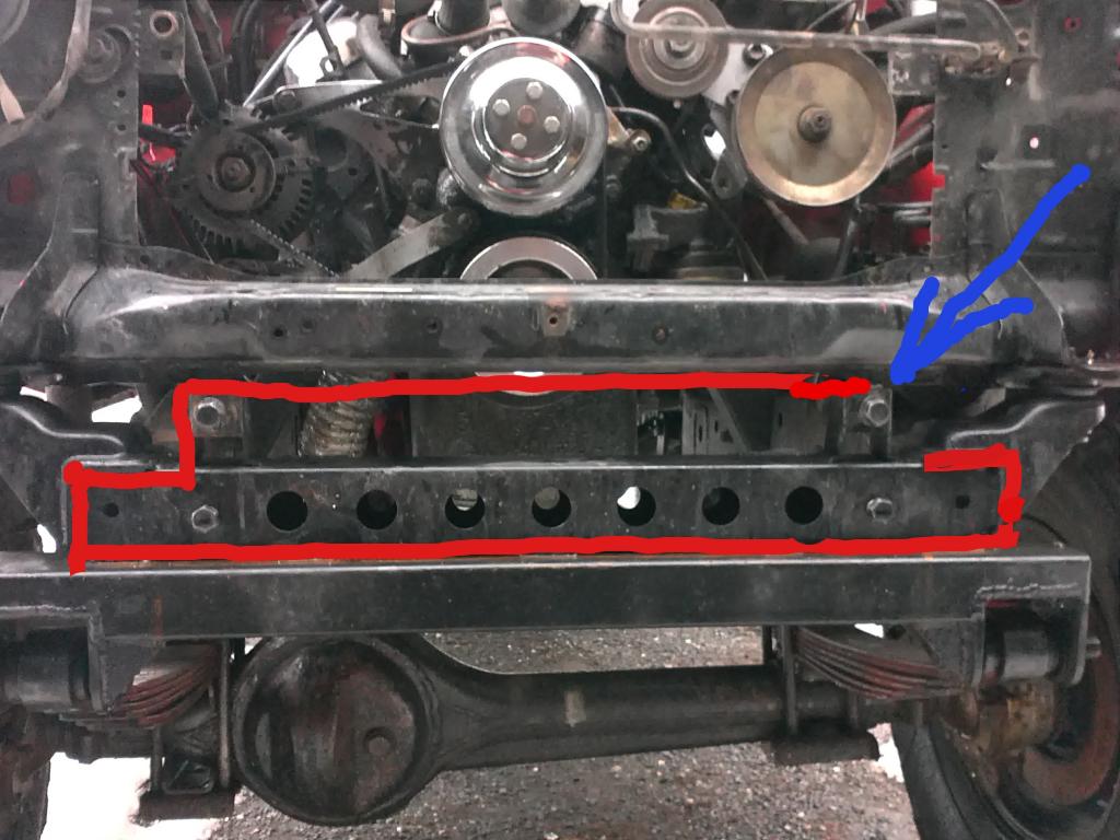

Here's an idea for remounting your winch. Im not sure if it would work real well but its a thought.
Where the arrow is would be inline with the rest. Tryin to make it easier to see.
Prolly there will be an easier option tho
Looking forward to seeing it back together with a shiny new radiator!
Thanks for the input, the only problem is I'm going to lose the upper mounting location, where those tabs are because my radiator will be occupying that space.
^The red outline is how my old winch plate bolted up, blue arrow is pointing to the mounting bracket I will remove on both sides to make room for the radiator. I think once I get the new radiator mocked into place I will be better able to see where else I could reinforce my winch plate to kept it strong.
