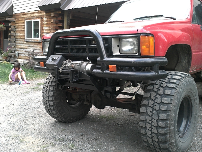

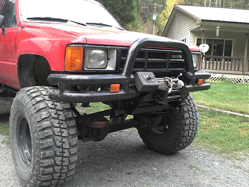

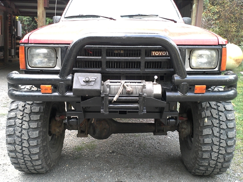

I finally got the winch mounted (temporarily) still need to make the frame reinforcement plate.

^^^The winch end cap was hitting the bracket that I made to bolt the smittybuilt bumper to the winch, so I had to drill new holes and move the winch to the right about an inch. Also the roller fairlead sits a about 1/4" too low, I can't slide my license plate back into the receiver tube, I'll probably have to drill some new holes in the fairlead and raise it up. It seems like something unforeseen always pops up!

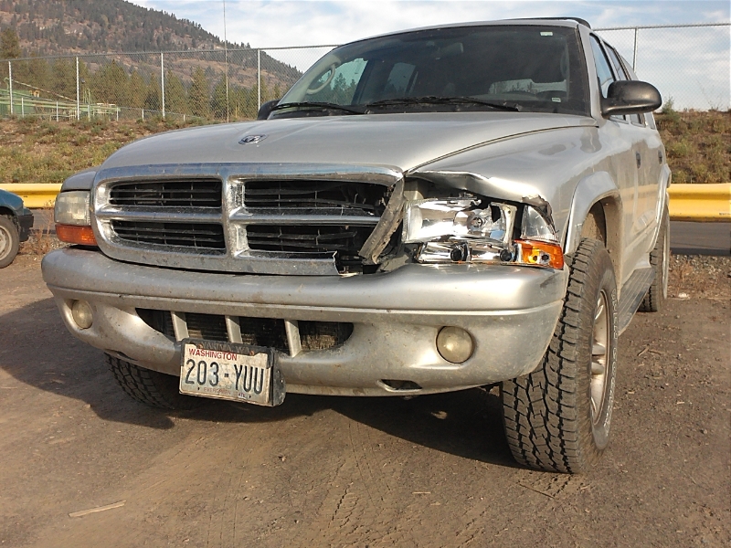

Well I hit my first deer on the way to work this morning. I've dodged quite a few of them in the 2 years we've lived here, guess my luck ran out! I was driving my wife's Durango, I think if I would have been driving my 4runner it probably wouldn't have done any damage, especially with the new winch plate out front! Here's a pic of the carnage:
It busted the headlight, turn signal assembly, grill, bent the fender in, cracked the line to the AC and leaked all the coolant out, and the lights that illuminate the instrument cluster quite working. I don't plan on turning in a claim to the insurance company, our deductible is $500 and I know I can fix it for less than that!
