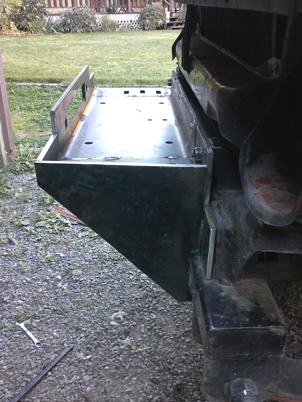

I got a little more done. I tacked welded the receiver in place, I also got the I triangle gussets cut out, still need to do a little grinding to make them fit.

Didn't you me mention building the crossmember reinforcement peice too? If so, you triangle gussets won't fit quite right around your spring hanger anymore.
Other than that, it looks really good
Good eye Bump! I'm glad you mentioned that! I did think of that, its hard to tell from the above pics, but I used some 1/4" pieces of scrap and used them for spacers behind the winch plate when I bolted it up to account for the thickness of the future cross member reinforcement plate. I started cutting out the reinforcement plate, I just need to get some more skinny wheels for my grinder.

I thought it looked spaced out at the crossmember, but it doesnt seem to be at the top bolt holes. maybe my eyes are playing tricks on me lol

Nope, your eyes are dead on once again! I was trying to square it up because I noticed the winch plate seemed to be angled downward. I had to pull the top spacers out to get it squared up. So I went back and checked the squarness between where I tacked the winch plate to the backing plate, and that's where I messed up. I took for granted that the 90°ish bend in the winch plate was square, and didn't double check it.
So my plan is to finish cutting out the reinforcement plate and get that tacked into place so I have a nice square flat surface to go off of, and I won't have to use the spacers anymore. Then I will go back and cut the tack welds on the bottom of the winch plate and around the received tube and get that all squared up before tacking it all back together. It shouldn't take to long, I probably won't get to work on it till wednesday.

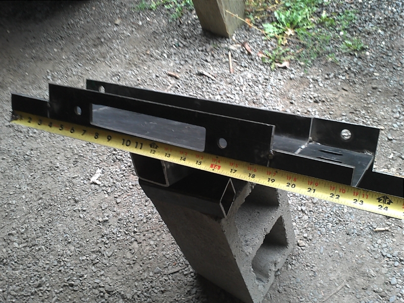

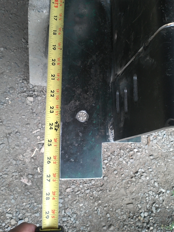

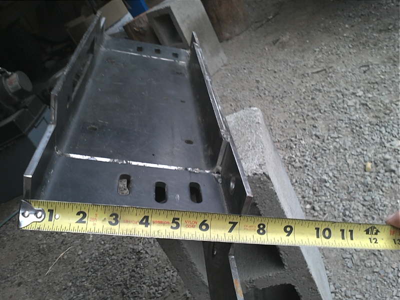

Here's a few pics with measurements, not sure if this is what you wanted, I can post more if you need something more specific.

That's perfect ED! I am going to try and cut a piece I metal out large enough for me to have bent by the metal shop.
I think the cutting the smittybuilt will look cool and definitely be more cost effective until you figure out how you want to change it up later on.
