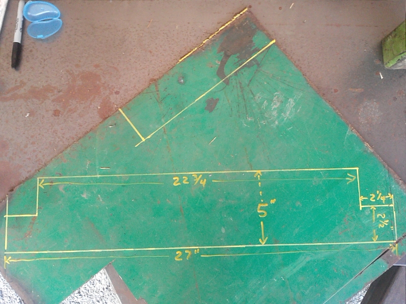

Here's a pic with the dimensions of the main plate of the winch mount. When I make the winch mount frame reinforcement plate I will probably make it the same measurements as this. I got some of it cut out today, didn't take me long to burn through the skinny wheels that I had. Need to pic up some more tonight. I'll post up some more pics with the measurements of the hole locations, probably tomorrow.

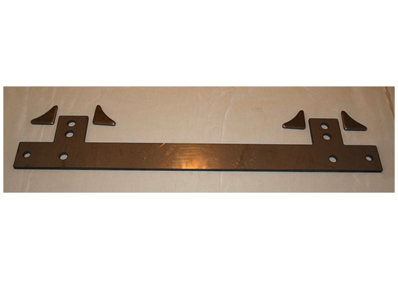

***EDIT: THE PIC BELOW IS OF TG's FRAME REINFORCMENT PLATE, NOT OF WHAT I BULT, JUST POSTED IT FOR REFERENCE PURPOSES, LOL. (Sorry for any confusion)

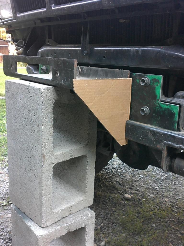

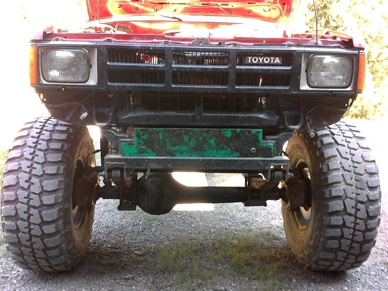

^^^ I got the plate cut out the rest of the way, and got some holes drilled. I can post the measurements of the location of the holes if anyone needs them, but mine weren't centered perfect, so you might want to measure for yourself, lol.

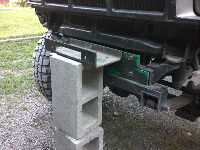

^^^ here's a pic of what's left of the "home brew" base that the winch bolts to, it came off my smitty bumper that was on my 85' parts truck. For some reason I can't remember, I cut & shortened it, must of needed the metal for another project, it looks a little funny, I fix that later.
^^^cardboard template...

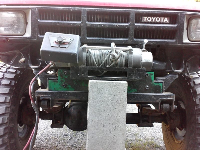

Winch mocked into place, no clearance issues with the grill. The winch I have is an old Warn M5000... it'll have to do till I get a better one.
