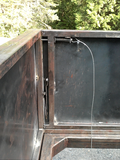

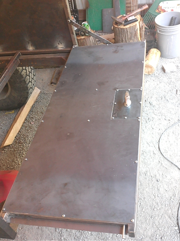

I went out and was starring at my hood latch trying to come up with some ideas. I was thinking I could use the factory hood pull lever and cable, and use that to engage my own home brewed latch, maybe something like I built on my trailer tailgate:

I like that. Maybe have two of them at each end of the hood just like the tailgate. Going into the fender support on either side, with a center pull cable to your factory handle inside.

Hey Mark, that's exactly what I was thinking! I think it would be easy to re-route the factory pull cable from the driverside fenderwell up to the hood (possibly inside the hood) and use that to actuate two spring loaded latches like you were saying one on each side of the hood. It looks like there's plenty of room where the fender bolts to the core support to add a small bracket for the latches to hook into.
