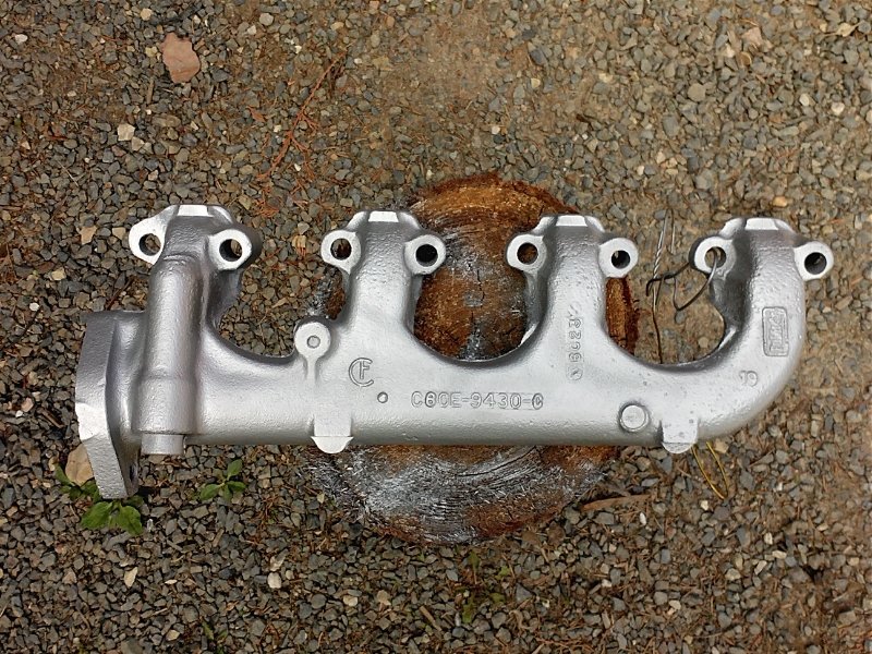

The manifold looks great! I think the silver is a good choice for a color.

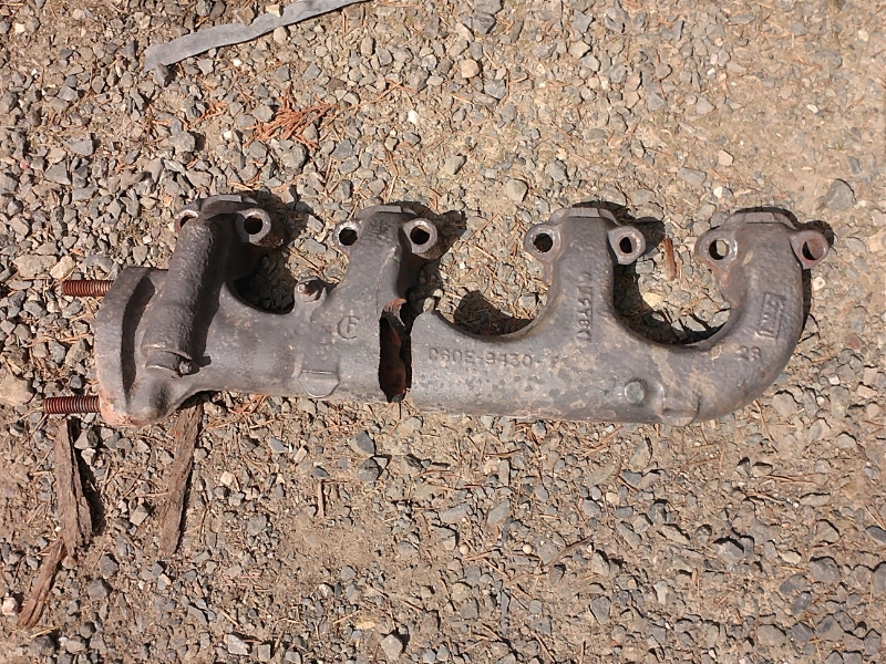

I see some one else has experienced Fords cracked exhaust manifolds as well. Still the small block Fords are some great little motors.

Yeah those stock exhaust manifolds fit nice, but this is the second one that's cracked in half on me (already replaced the driverside) hopefully this one will last awhile, also the VHT silver paint I used on the manifold burned off on the way to work yesterday, It's rated at 550* might be because I didn't bake it in the oven at 200* for an hourper the directions, but it also said the the engine operating temp would do the same thing... oh well live and learn.

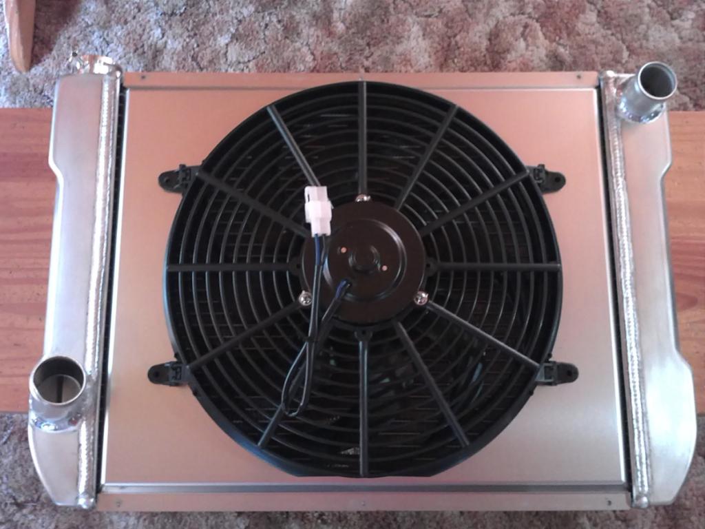

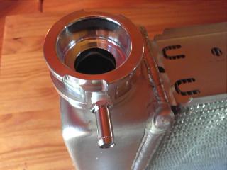

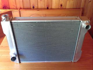

Here's some pics of the new aluminum rad, shroud, and 14" electric fan. The radiator dimensions are 24"W x 16-1/2"H x 3"D. It's 2 inches wider than stock, I went shorter to keep it above the frame rails. Two things I overlooked. 1.) the radiator didn't come with a readiator cap, so I need to order one, $20... 2.) there are no mounting holes or tabs on the radiator to mount it, so I need to order a universal radiator mounting bracket, $50...I'll have to wait, I'm out of funds, I'll probably put my old rear leaf springs up on CL along with my Toyota V6 radiator and some other odds and ends, hopefully raise the funds I need, anyway here's some pics:

That radiator looks really nice. It should cool that motor down really well. If I remember correctly you said you are gonna cut the core support and rebuild it, right? If so, you may want to just build a mounting bracket for the radiator yourself. It may save you some money and you'll also know it will fit. Just a thought. Whatever you end up doing, it's gonna look good no doubt.

Thanks Tim, yeah I think this rad/fan setup should work out, at least I really hope it does!!! I've thought about building my own radiator mounting bracket, I'm just not sure if I can make it look descent, and also I don't want to worry about causing damage to the radiator, so I might just go ahead and buy CFR's universal mount. Here"s a pic of their universal mounting bracket, you can click on the image to enlarge it.

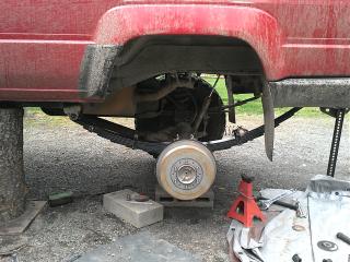

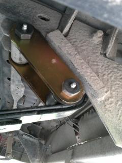

OK, so I started working installing the AllPro 6" lift today. Here's what it looked like before, ( just as a recap, I was using 2" blocks that were on the 4 runner when bought it, I added the Zuk mod using jeep TJ front coil springs gained me another 3" of lift, served me well for almost 2 years! Still sat a little low in the rear.

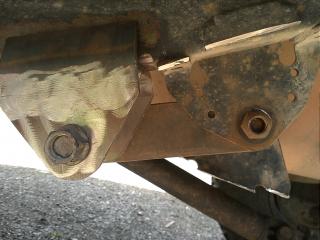

After measuring the difference between the spring eye to the center pin on the front half of both springs, the allpro springs were aprox 7" longer (27-1/2 " compared to stock being 20-1/2") just to double check I called allpro, and they said most people move the spring hanger 6" forward (measuring eye to eye)......
I had one of my old 5-1/2" shackles handy, so I figured a half inch wouldn't make that much difference, so I put some bolts thru the older hanger and one thru the new one and used that as a spacer to move the new hanger 5-1/2" forward and clamped and tacked the new one in place, here's the new spring installed.
Here is the shackle/spacer
I'm taking a diner break, got some more pics to post up shortly!

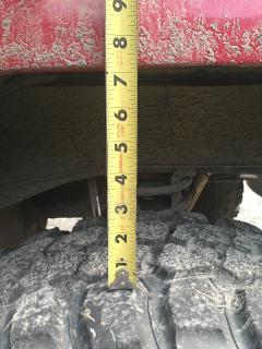

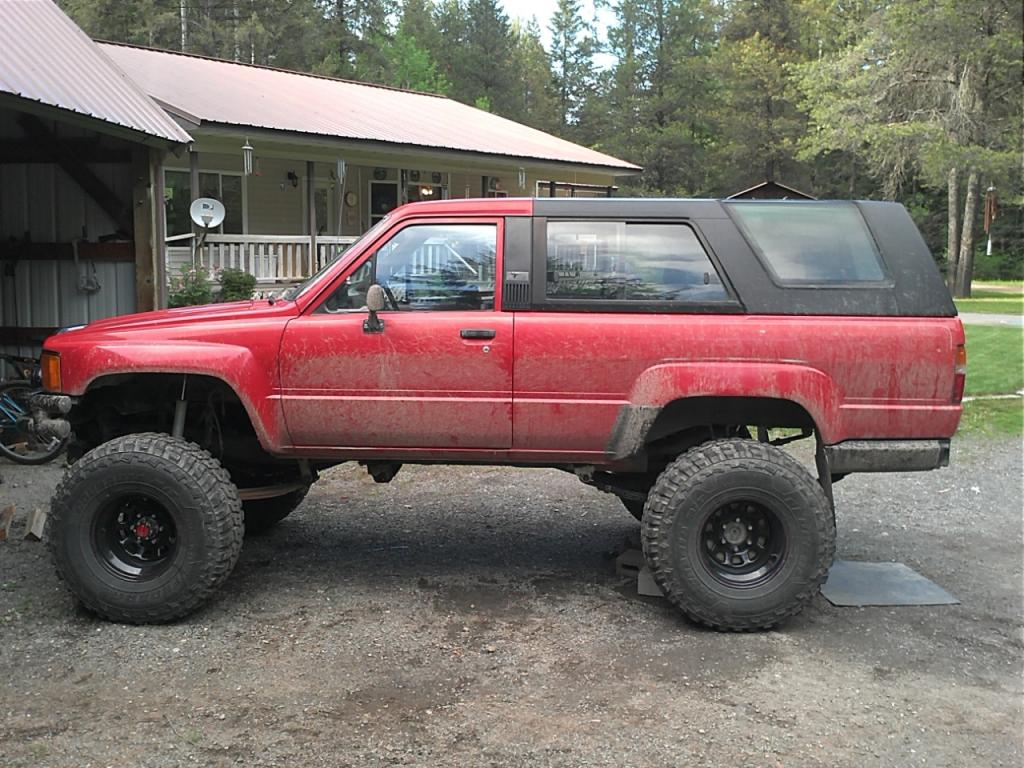

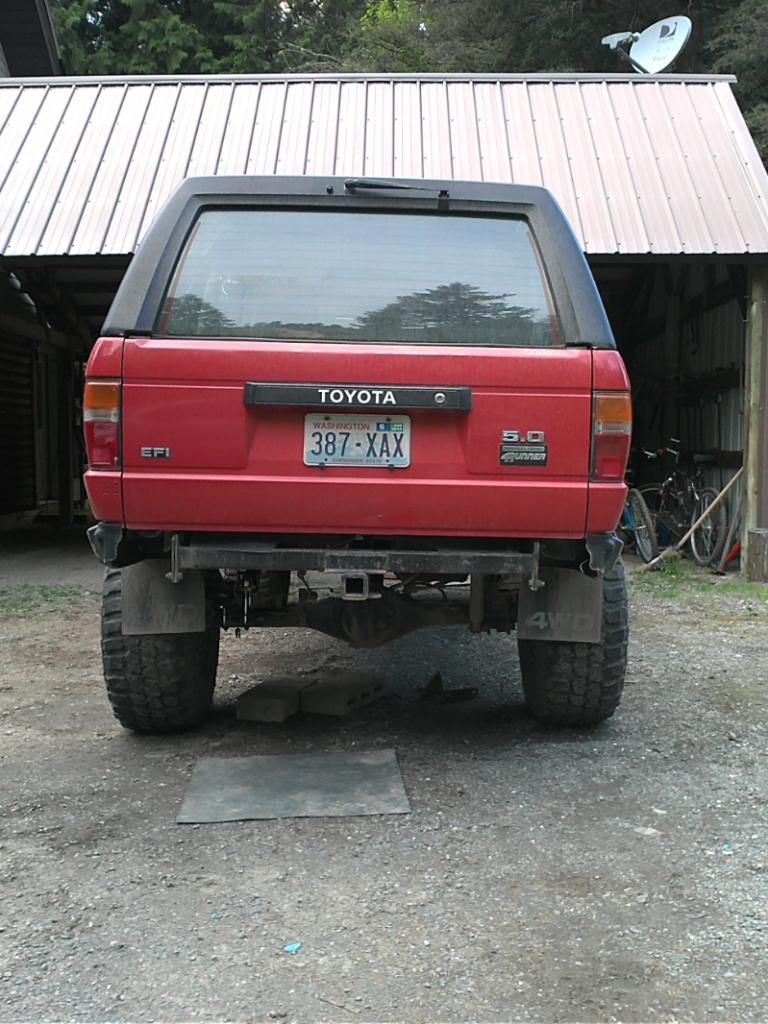

So I only got most of the driverside done, looks like I gained about 1-1/2" of lift (I had 7" of clearance between the fender and tire before, after I have 8-1/2") still need to mount my shock tabs to the axel. Also, I haven't received my missing shackle mount bushing tubes or my 3 hole spring perches from AllPro yet :/ so I went ahead bolted the springs to the factory old shackle mount to see how my shackle angle would be, and if I would have to move the mount. I definitely need to cut the old mount off, and relocate the new one back a few inches. I also need to take the receiver hitch off probably have to modify it, you can see where the shackle is up against it in the pic.
SO I meant to mark the frame and use a plumb bob to mark the center of the axel tube so I could keep track of how much the axel moved if any, but I forgot to do that, you can definitely tell the axel moved back, lengthening the overall wheelbase. Not sure if I like it. When my 3 hole axel spring perches arrive, I could use the rear hole and move the axel forward an inch. What do you guys think, should I leave it ,or change it? I'm open to suggestions! Here's a before and after pic:
ΔΔΔBEFORE
ΔΔΔAFTER...the front still looks a little higher in the pic, but is raised up because it's leaning from the passenger rear sitting lower.
ΔΔΔBEFORE

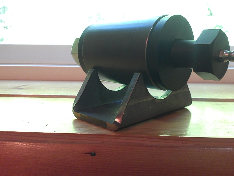

I have some DOM bushing tubes that I bought from SHOCKER for my trailer project. The bushings are bigger, but the hole is the same size and my greaseable shackle bolts fit, I'm thinking of grinding the shackle perches to fit these bushing tubes so I can go ahead and get the shackle angle setup correctly.
