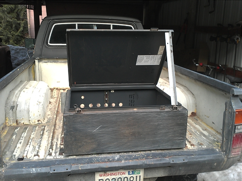

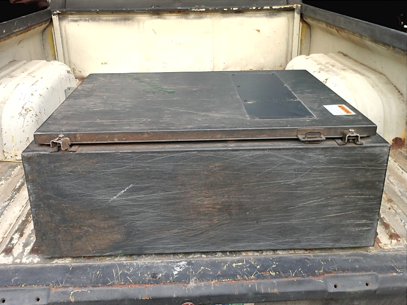

I scored this electrical control panel that they were throwing away at work. They did a lot of up grading of equipment a few months ago and were going to throw it in the scrap bin, my boss said I could have it. At first I was thinking of using it for lockable storage in my 4runner, but since it is weather proof, and still has good weather stripping around the door I'm thinking I may use it on my trailer project and mount it on the tongue, I can store tools, tow straps etc. The way it's sitting on my truck it measures 30" wide by 24" tall by 10" deep. I just need to clean it up and plug the holes where the conduit came into it. The brownish color on the outside is just dirt, I thought it was rust at first. It's got a real durable finish on it, I'll probably respray over the outside, maybe that hammered finish, grey or black, the inside is like new, I'll just leave it.

That's a nice score on the box. So many possibilities for it.

Nice box!.... Boy is that open to some terrible re-interpretation. Haha

Thanks man! I get all excited over free stuff, lol. I was planning on building a storage box for my trailer tongue, this will save me a lot of time and money!

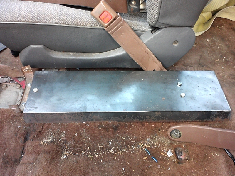

Storage Console Update...
Originally Posted by rustEDyota83
^^^got it tacked together today
^^^made the lid for it.
^^^tomorrow I will make the brackets to attached the base to the floor in the stock mounting locations.
^^^here it is mocked into place, it's about 3" taller than the factory console, feels a lot more comfortable for an armrest. The factory storage console inside dimensions of the storage compartment were aprox: 10-1/2"Long x 4"Wide x 5-1/4" Deep. The one I'm building measures 14"L x 5-1/2" W x 8-1/4"D...I could have made it longer, but am wanting to build a cupholder in front, that is still in the design stages, lol.
UPDATE 4/1/14... JUST THOUGHT I'D REVIVE THIS PROJECT FROM THE DEAD, LOL. I GOT A LITTLE DONE YESTERDAY, PLAN TO WORK ON IT SOME MORE TODAY.
^^^here is the base of the console, got it mocked into place. The 2 rear bolts are bolted into the factory mounting holes. I didn't have metric bolts long enough, so I tapped the holes to except a standard course thread 1/4" dia bolts. The front single bolt I drilled through the console base and the floor of the 4 runner, I was able to reach through the hole in the trans tunnel for the shifter and thread a nut on the under side. I'm moving the plastic part of the shifter boot console forward aprox 1" due to the transmission swap I did. When I swapped trans from the W56 to the G52 I had to cut a little of the trans tunnel out to allow the shifter to come through the floor, the shifter is a few inches further forward than the stock position, so it was hitting on the plastic housing. In the above pic, the small bracket in front of the console base is moved forward about 1" also, I just used a couple self tapping screws. Now that the base is located were I want, I can go ahead and start welding the enclosure to the base.
