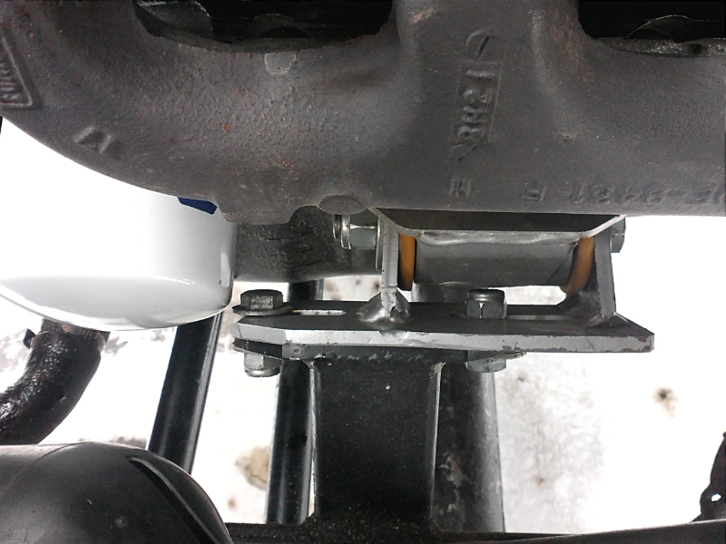

Well for awhile now I've had a small oil leak. I have a remote mounted oil filter on my engine because of the clearance issues with the steering shaft. Well one of the remote oil lines running to the filter was leaking from where the hose was crimped to the fitting. So I'd check and have to add oil every couple weeks. So I was due for an oil change and after doing some research I found a shorter oil filter for the 302 that would clear the steering shaft. So after removing the remote filter setup I ran into a snag, my NWOR (Northwest Off road) motor mounts were interfering with the filter preventing it from threading on! So about the only thing I could do was cut and remove some of the end of the motor mount, I hated to do it, but I wanted to eliminate the remote filter setup.
^^^ I used a bottle jack between the top of the axel and the upper part of the motor mount (that has the bushings in it) to keep the engine from lowering down on that side, and was able to remove the lower part of the mount that needed trimmed back.
Size:  309.7 KB^^^I have about a 1/4" of clearance now between the oil filter and the engine mount.

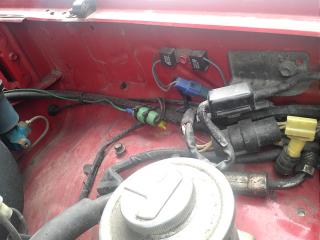

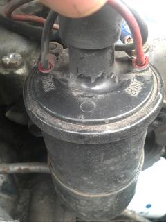

Hey Tim, I'll get some pics posted up shortly, my cell phone is to dead to take any pics right now, but I'll try to answer your questions.
I wish I had more info on my motor ( build specs and components used) but since I just bought a donor truck (85' Toyota pickup) that already had the 302 in it, and the PO didn't have very much info for me I'm kinda at a loss.
I do know I have an electronic distributor, it doesn't have points, but I don't know what brand it is. Pretty sure its a ford coil, not a Toyota one.
On the wiring, on the distributor there is a black wire and a red one. On my coil one side is marked "DIST" and one side is marked "BAT"..... the black wire coming from the distributor goes to the screw on the coil marked DIST and the red wire coming from the distributor goes to the screw on the coil marked "BAT"
Size:  13.2 KB Name:  002_zps2787c66b.jpg
There's one other wire from the battery side of the coil to hook up and your done. The red wire coming off the battery side of the coil and running up towards the valve cover ( in the pic above) it goes to the plug on the driver side fender well in the next 2 pics.( green wire) the reason it changes from a red wire to a green wire is because I ran it into the cab and hid a kill switch, I thought changing the color might help confuse a would be the thief, but now since I moved out of the city and way out in the country, I don't even use the kill switch anymore.

Ed, this is really helpful info. I tried with the original Toyota coil with no luck. I tried again with a newer Ford coil (off a 90's Mustang I think) but I had it wired wrong. Work and school is killing me right now so I will have to wait until later this week or next week to try it.
Just one thing: where does the one other wire (heading towards the valve cover to the green connector) go? Does it connect to the key? Is that the same connector used in the original Toyota wiring? No pictures needed since you have a hidden kill switch...
Thanks!
-Tim

Yeah the green connector is the original Toyota wiring and runs to the ignition switch.
