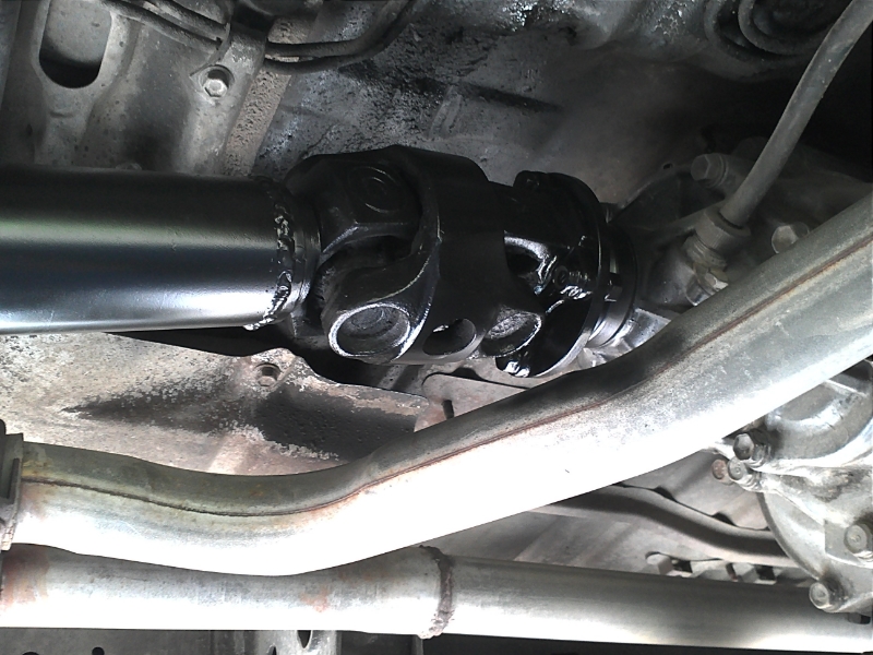

Originally Posted by rustED
Well, I got my front driveline done. Basically just took the rear driveline from my 85 parts truck, measured out how long to make it, cut it to length. Then took my stock IFS front driveline cut the double cardan joint out, tapped it into the shortened 85' rear driveline and welded it back together. At least now it feels like I have a 4WD, lol. Here some pics.
^^^ grinding thru the weld to remove DC joint, don't cut too deep! Lol.
^^^new driveline about 4-3/8" longer than old one
^^^ DC joint tapped into place inside new driveline and welded up
^^^ driveline installed, just needs paint
I found the post, guess I extended the front 4-3/8".... I never balanced it and have used it for the past 2 winters in 4 HI without any vibrations!

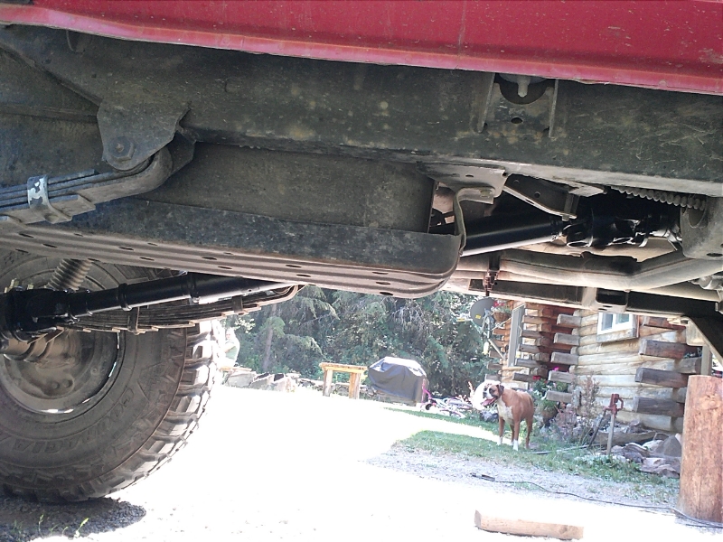

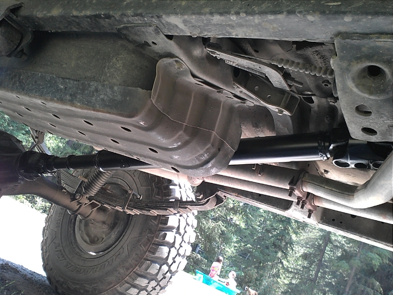

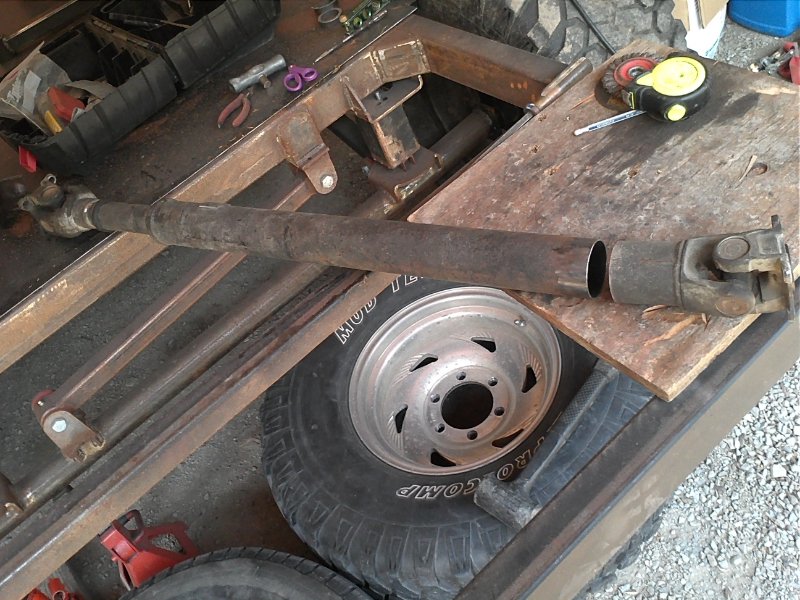

Ok, just to recap, lol, awhile back I swapped in AllPro Offroads 6" rear lift. When I did this I cut off the old leafspring perches and rotated the diff to point at the rear output flange of the T-case. I'm just now finally adding the Double Cardan joint to the rear driveline.
As most of you probably already know the bolt pattern on the front t-case flange and the rear t-case output flange are different, so if you are going to put the DC joint on the rear driveline you either have to get a spare front flange and swap it to the rear, or TG sells a Triple Drilled Flange that has multiple bolt patterns on it that will work. I had a heck of a time breaking loose the nut on the T-case that holds the output flange on for the rear driveline. It took a 2' long cheater bar to finally break it loose, but I got the spare front output flange swapped to the rear.
^^^I cut 6-3/4" off the end of the driveline.

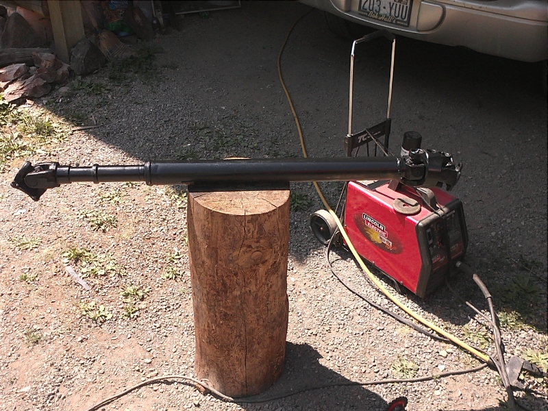

^^^I got the DC joint welded in and the driveline painted.

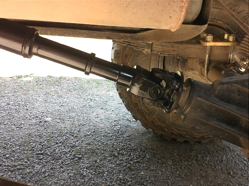

I'm pretty happy with the angle, the rear diff points directly at the output flange of the t-case.
I took it for a test drive, got up to around 70 mph, so far no vibes, I'll update how it's doing after putting more miles on it, hopefully I won't need to get it balanced!
