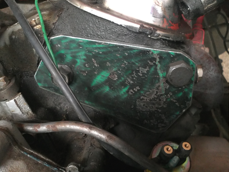

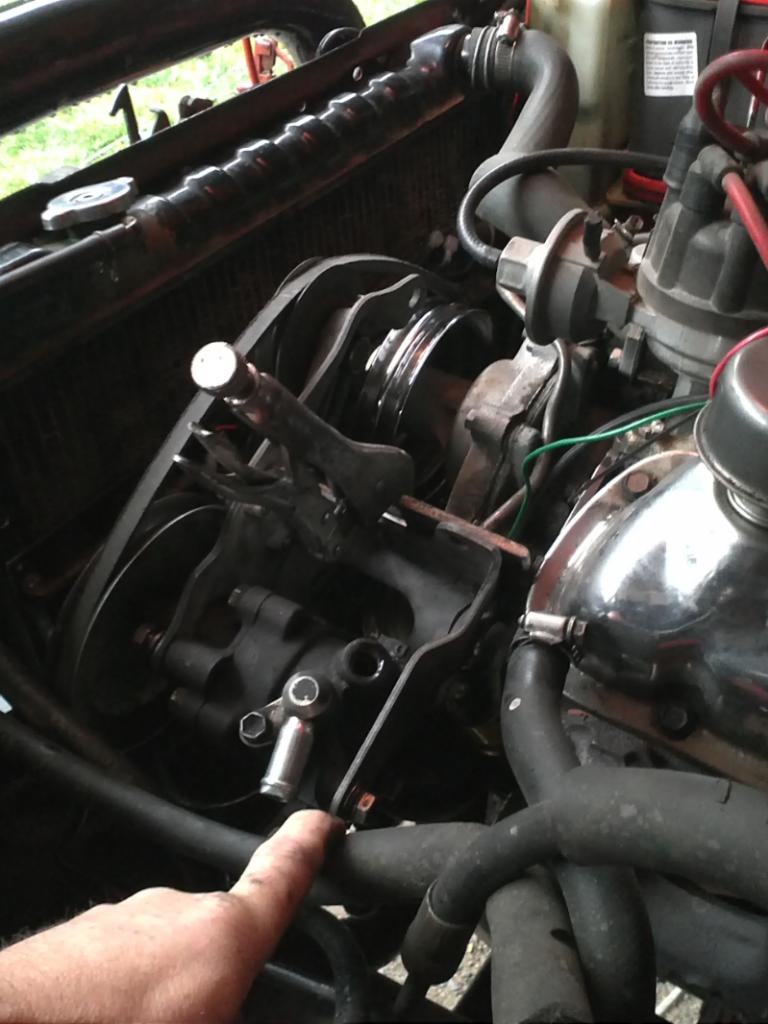

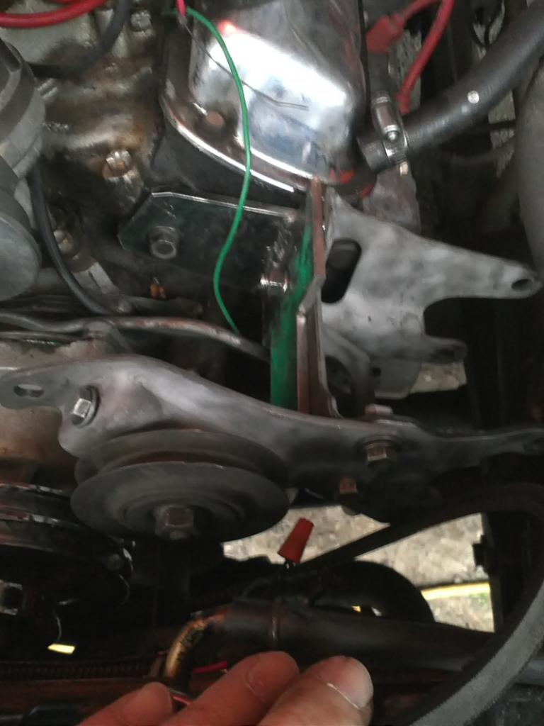

I fabbed up a bracket to mount to the driver side head so I can mount the power steering pump. I still need to drill a few more holes, I'm also going g to add a gusset to my bracket to make it more rigid.
Don't judge my hacked wiring job in the one pic, when I pulled the radiator and electric fans last week I was in a hurry to get it reinstalled because I had to work that night and it was getting late, I used a wire nut on the ground wire, lol, I'll fix it the right way when I get some time!
