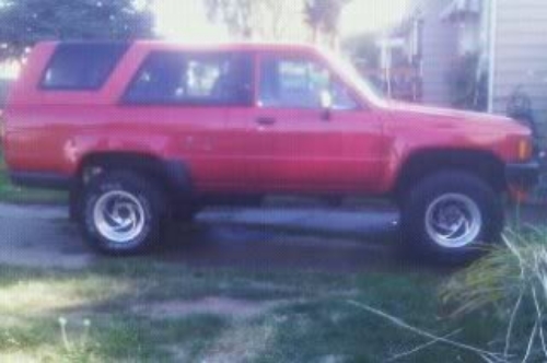

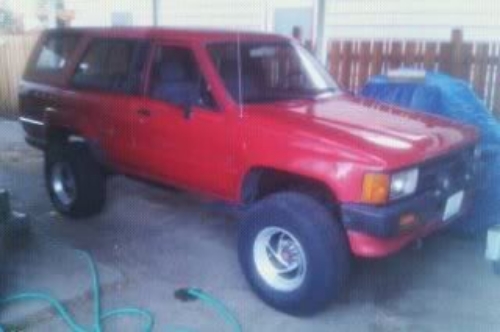

^^^I was looking at some old pics, here's a couple of my 4runner when I first bought it.

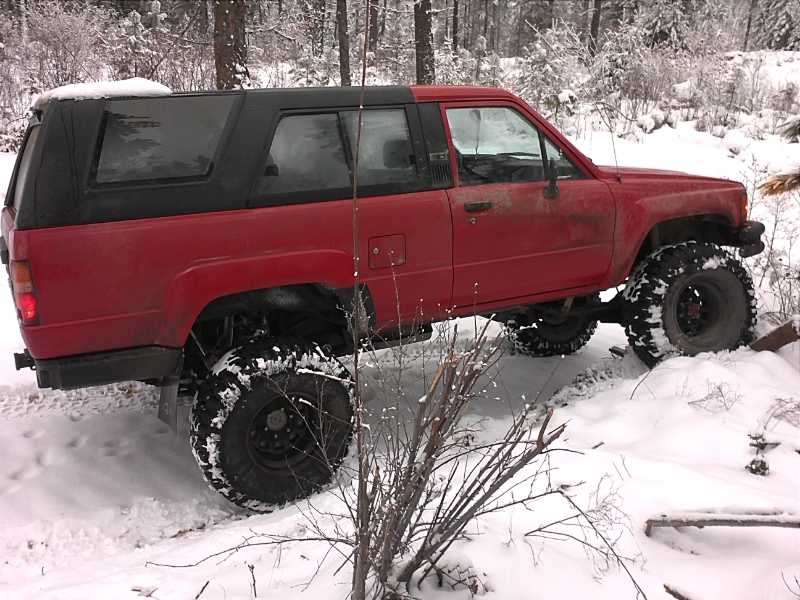

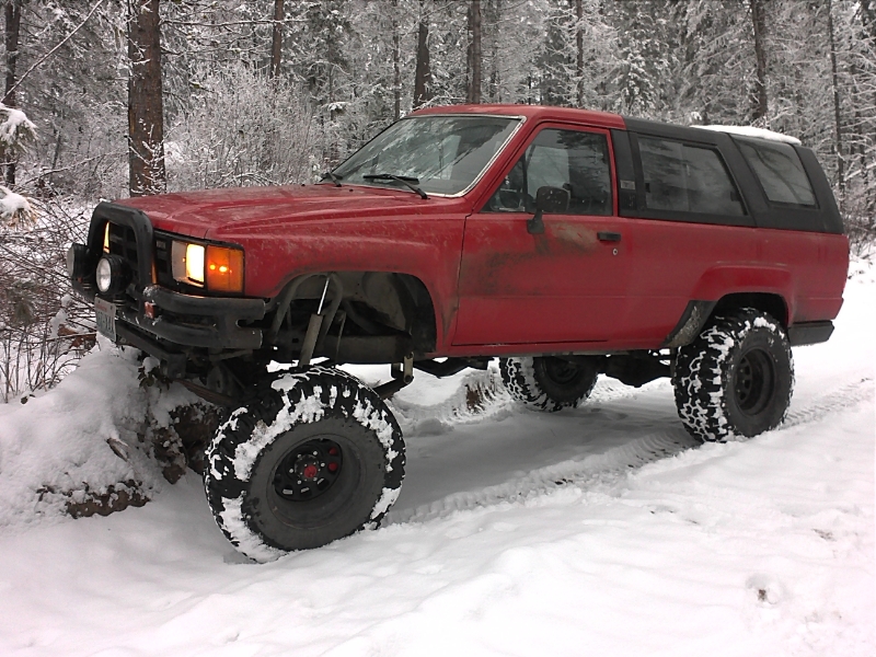

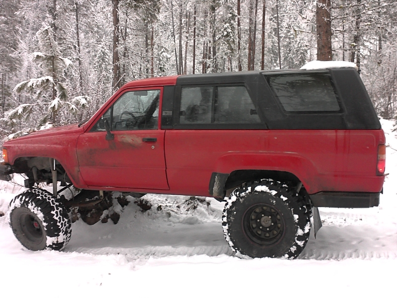

^^^here's a few poser pics I took after work tonight, I can't wait to redo the rear suspension, I'm really happy with the front, right now the rear travel is lacking, not to bad though for stock rear springs, longer shackles, Zuk mod (using Jeep TJ front coils, gained about 3" of lift) and 2" lift blocks that were in there when I bought the 4runner...hopefully I can redo the rear suspension this summer, probably go with TG 5" lift.

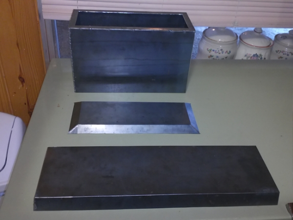

I also got a little more done on my center console project.

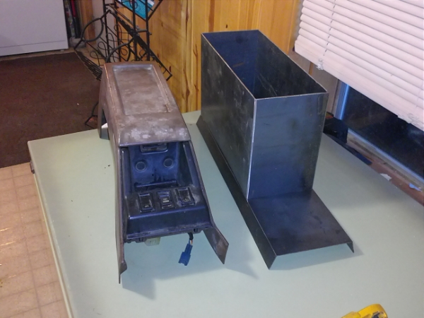

^^^Here is a mock up pick of the storage console, still needs to be welded up.
^^^here it is compared to the stock storage console, I made it taller so it should make for a more comfortable armrest, it should have twice the space, the empty flat area in the front is where my cup holders will go, I'm still in the design stage on those.

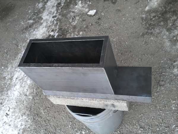

Center Storage Console
^^^got it tacked together today

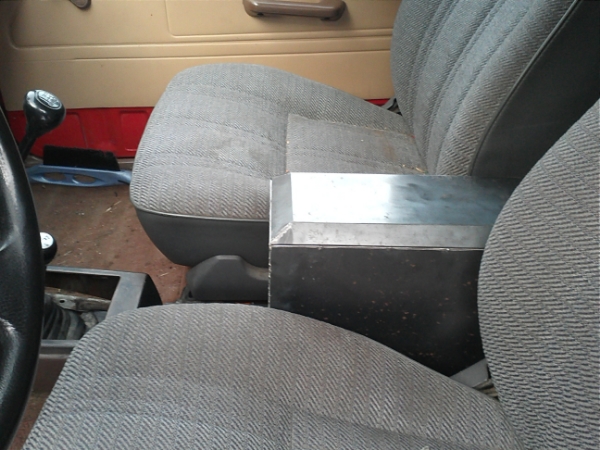

^^^here it is mocked into place, it's about 3" taller than the factory console, feels a lot more comfortable for an armrest. The factory storage console inside dimensions of the storage compartment were aprox: 10-1/2"Long x 4"Wide x 5-1/4" Deep. The one I'm building measures 14"L x 5-1/2" W x 8-1/4"D...I could have made it longer, but am wanting to build a cupholder in front, that is still in the design stages, lol.
