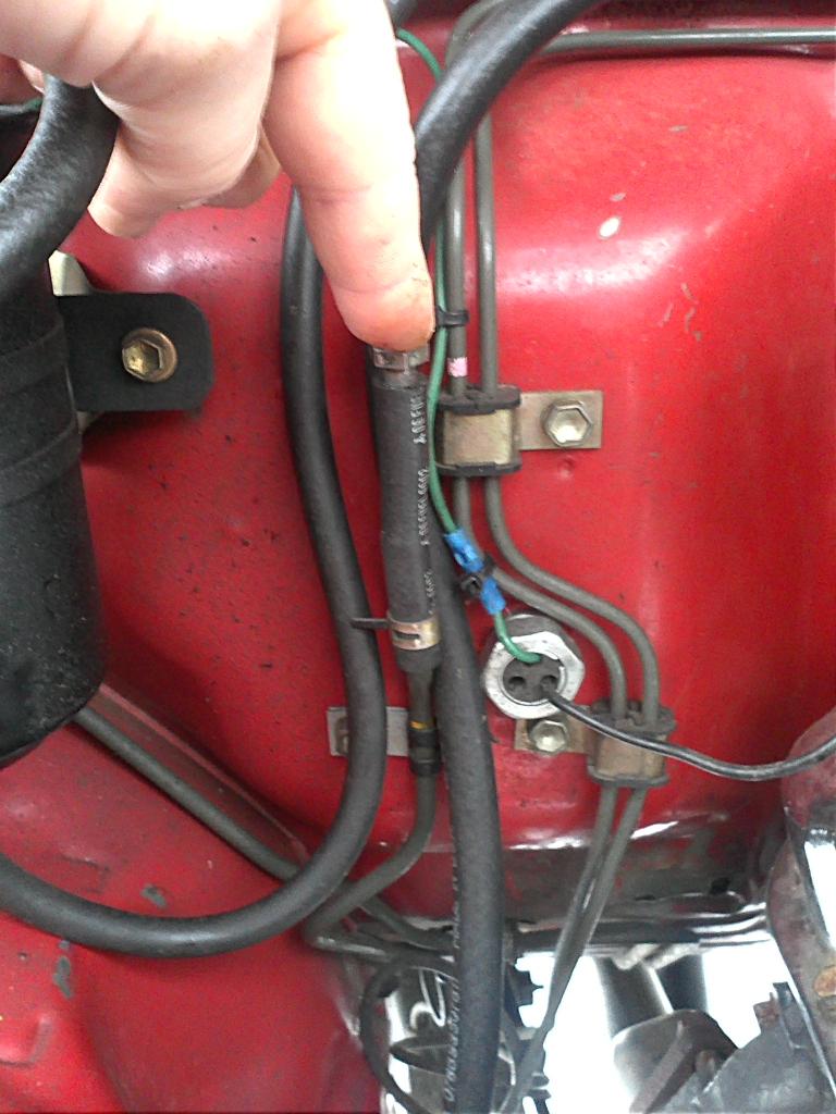

Hi Falx, I took a few pics, hopefully these will help you out.
^^^ This is the fuel return line that I plugged off. It's the closest one to the charcoal canister. If you decide to run a mechanical fuel pump you'll need to plug this line, otherwise the pump won't draw in fuel.

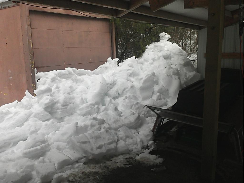

^^^I thought I'd throw a random pic up...This is the avalanche I woke up to this morning, lol. This is the second timeI've had to dig out my storage shed in the background, last time it was twice as high, lol.

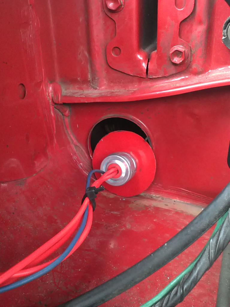

^^^ Here's what I came up with for running my wires through the firewall. That big hole used to have a rubber gromet that the EFI wiring harness ran through. I wished I would have kept the gromet, but let it go when I sold all my fuel injection componets on CL. So not wanting mice and other critters coming in I made a metal cover and painted it to match. Then I used an electrical cord grip to run my wires through. I just need to silcone and seel the cover in place.

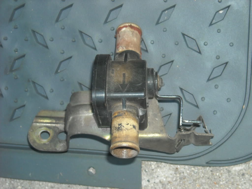

Hi Mark. I don't know a whole lot on the heater controls and such, I thought I read somewhere that a rear heater was an option on the 4runners, is this correct? That would be a mod that would really interest me, my heater works really well, but not enough to keep the kidoes warm in the back on these cold winter days, lol.
