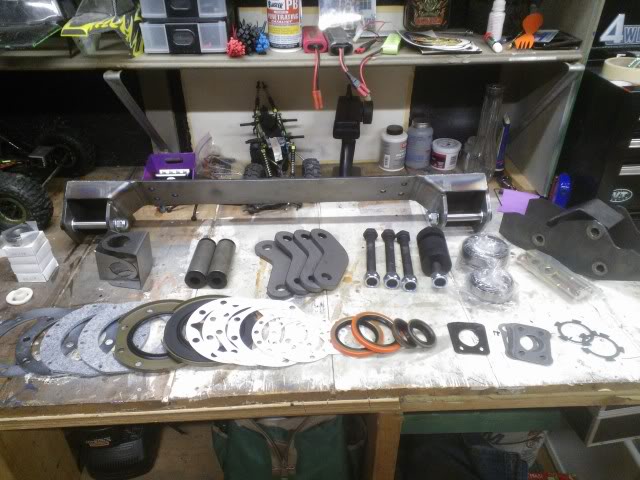

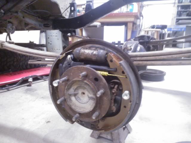

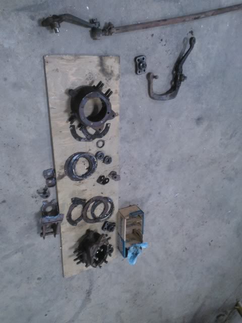

While I was in the rear axle, It got new breaks and Marlin axle seals.
Cut the perch and break bracket off my homemade SST and threw some paint on it.

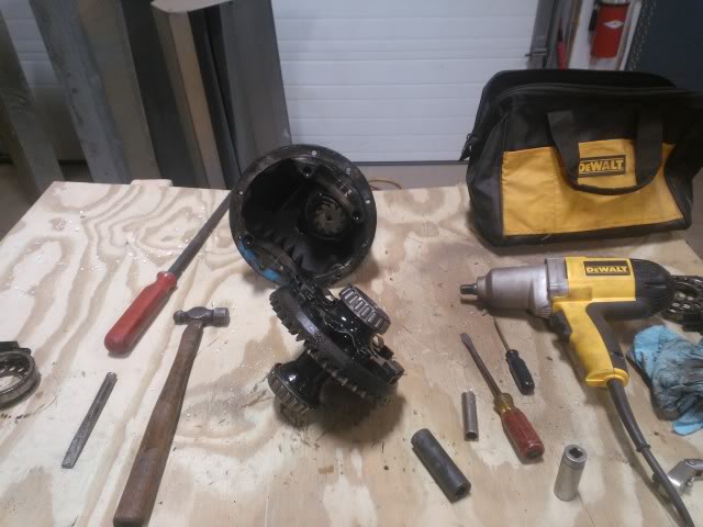

The spool is coming out of the 4.30 third and going into a 4.10 v6 3rd
These were the original bearings from 92, and definitely need to be replaced.
And my Sky high clearance hanger and shackles, Marlin axle rebuild kit, and steering box plate came in.. Good good things are gonna happen soon...

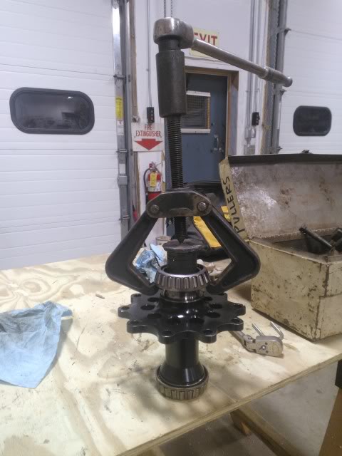

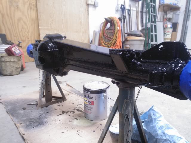

Got the non essential brackets cut off and ground smooth and ran the knuckles through the parts washer to get the 28 years of grease off.

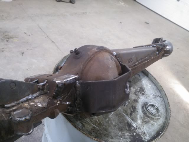

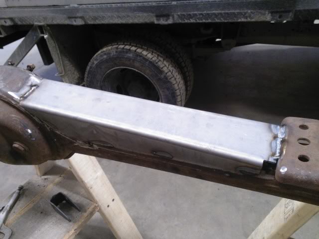

They bend where you don truss them, so mine will be fully trussed. As for bumps, Im just using some TG ones that I have lying around. And with a 125" wheel base, this truck is anything but short, Ill only be moving the axle as far forward as I need to to keep it from getting any longer.
I slid the truss down a bit. so it touched the spring perch. It took a while only welding 1" stitches at a time, but I wanted to make sure I did not not warp the housing.

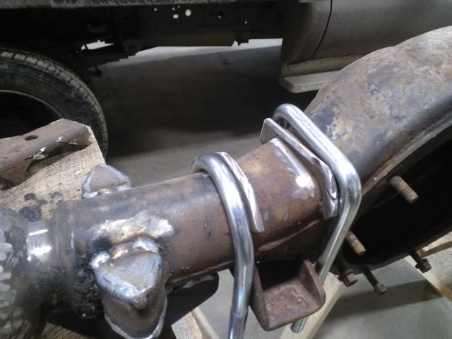

Trimmed the bottom perch so it wont hang up on things. TGs 84-85 ubolt flip kit came with 2 round and 2 square u bolts, but looks like it should have came with 3 square ones... ? What everyone else running for a u bolt in that spot right next to the diff?

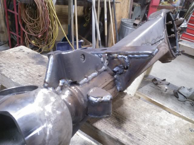

Bottom gussests, one had to be trimmed to fit over the 85s longer bottom truss.

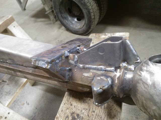

And the upper knuckle gusset. I added small pieces of plate to connect them to the spring perches. I also added a 3/8ths plate to the drivers side spring perch to bring it level to the passenger side perch. When doing this I made the plate 8" long instead of the stock 5ish to try to help with axle wrap, then boxed it in.

Using a square u-bolt next to the diff is a better fit than the round one. Looks good. You can always limit up travel with bumps.
I find that the progressive bump is easier on the axle than the hard kit ones.

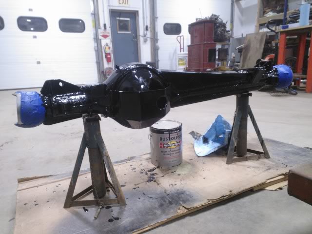

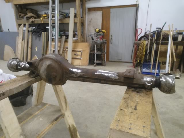

Normal slow moving project update:
Extended the other spring perch to match, got the last piece of armor on and did a quick paint job.
I have JB weld on the knuckle balls to help smooth the pitting from the rust, Still needs a little more sanding..
Im in the process of a headgasket on an 03 Camry for my new DD , and as soon as thats out of the shop ill be able to roll my truck back in.
