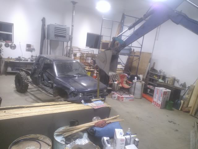

A real update!
Got the truck back in the shop with a little help from the excavator..
Then this happened...
temporary_zps90ab1fde.jpg?t=1384919351

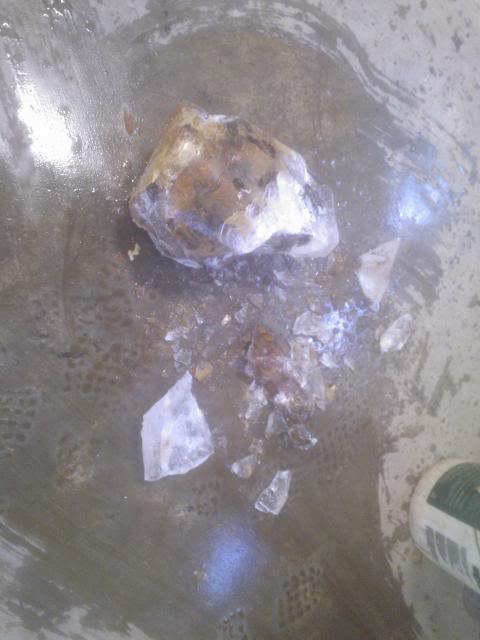

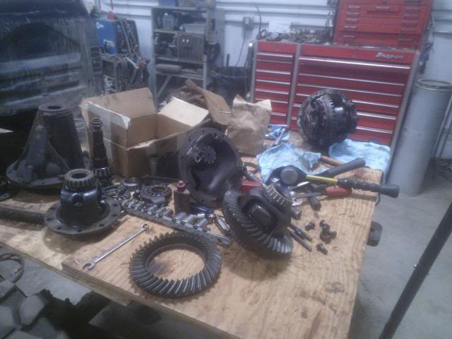

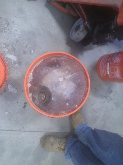

Got a bunch of diffs as parts and one of them came to me like this. The lid was sealed on but it had a small hole and filled with water.
In the bucket is a 4cly 4.10 diff with locker and a set of high steer arms.
We chipped it out then melted the ice away with a propane torch, We didnt end up using this one, It needed new bearings before, but it definitely needs a them now.
The diff work bench:
3 4cly 4.10s with lunch box lockers, 1 working, 1 with a broken center pin, 1 frozen in a bucket. 2 4cly 4.10 diffs welded, both have broken welds, 1 needs a pinion, 1 needs a ring gear. And 1 completely stock 4.10 open with a broken pinion.
Didnt really need that many, but the price was right. We replaced the center pin from broken lunch box with one from welded carrier. Now I have a working set of 4.10 diffs with lockers ready to go.

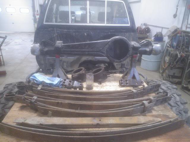

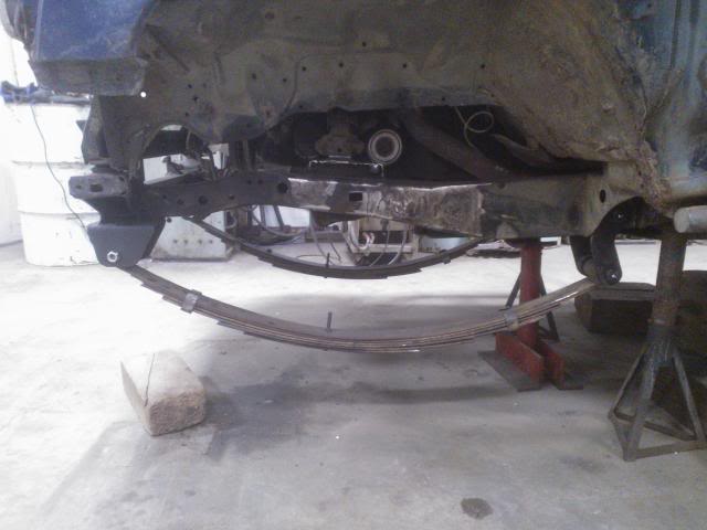

Got them in the orientation ill be running them in, but still need to cut them down. Planning on running a 7 leaf pack. 1st and 2nd are stock 88 rear leafs. 3rd and 4th will be 1st and 2nd from the 92 Downey pack. 5th is the 3rd from the 88, and 6th and 7th will be from the Downey pack. Ill get them cut and put together Monday after work.

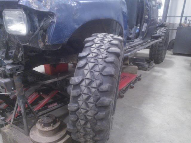

Some mock up pics.
Actual ride height will but about 3-4 inches taller. The axle isnt in the center of the wheel.

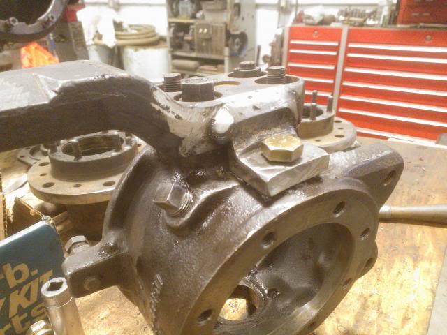

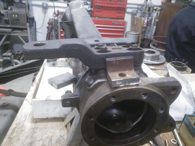

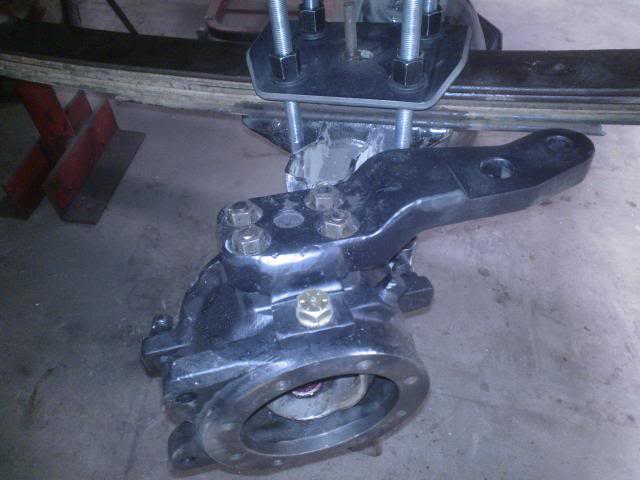

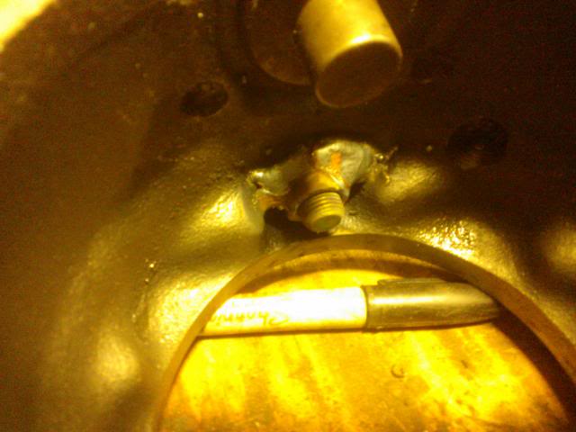

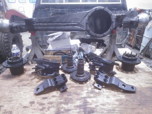

Drilled out the break holes to 1/2 " and made a 5th Stud.
Used a 1.5' X 1/2'' grade 8 bolt.
The nut is welded to the back of the knuckle. A lock washer will help the bolt not hang down so low, but there is plenty of clearance between the nut and the ball.

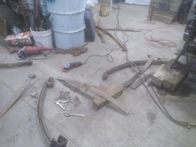

Changed the leaf pack up a bit,
1st - 88 main leaf
2nd - 88 mil Wrap
3rd - 88 3rd
4th - 92 3rd with clamps
5th - 92 main cut to 24 with flipped around and re drilled
6th - 92 mil wrap cut to 17 flipped around and re drilled

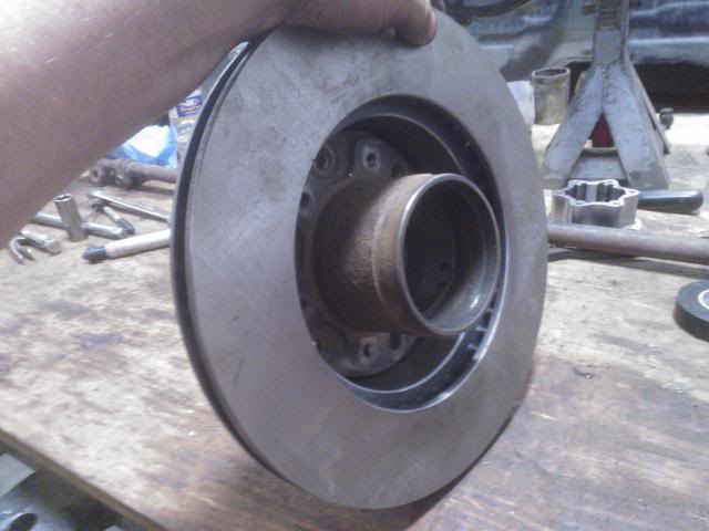

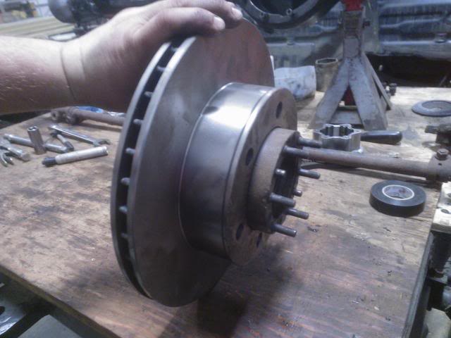

Ground down my IFS hubs to fit the 97 taco rims. If I was running a steel rim, I could probably use the stock studs, but I need to get some longer to fit the MT aluminum rims.

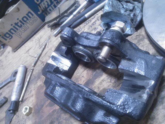

Stock V6 Calipers ground out a bit to fit the taco rim, and I drilled out the bolt holes to 1/2".

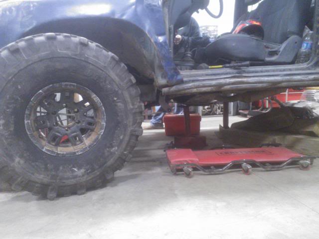

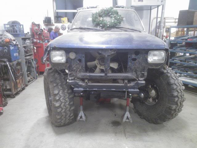

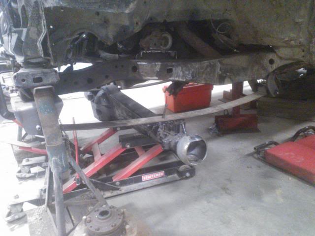

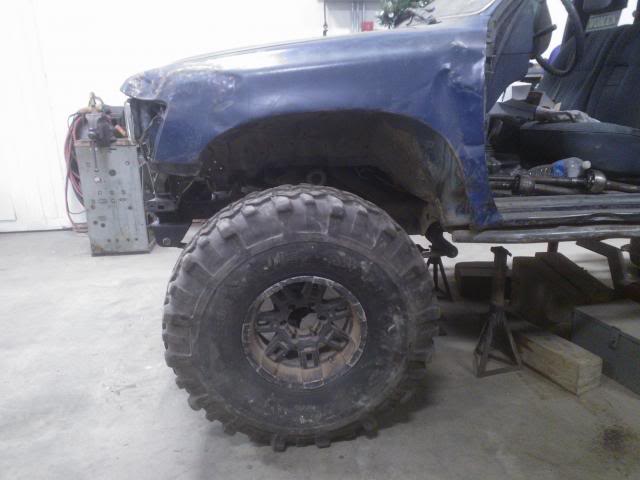

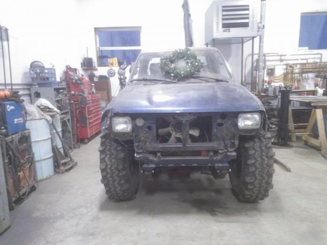

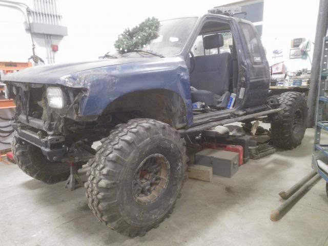

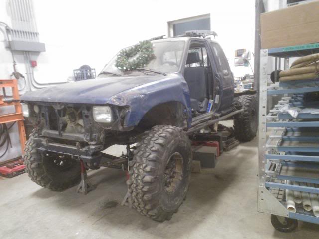

Well, probably wont be done for the 25th.. but Put the knuckles on and got the axles bolted to the leafs for some "ride height pics"
Measuring 25" to the bottom of frame just before skid plate. 21" to lowest point on the bud built, with a 126 wheel base. The tires and sas netted me about 6" of total lift.

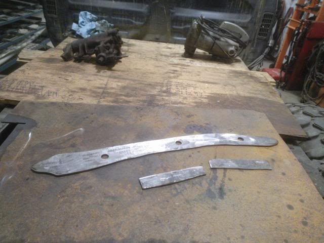

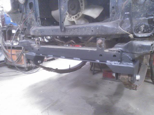

And got my motor mount plates and pass side frame plate cut. All were cut from the piece of 3/16 metal they are lying on.

My 21 year old stock pitman arm didnt want to come off.
temporary_zps0c238610.jpg?t=1388929182

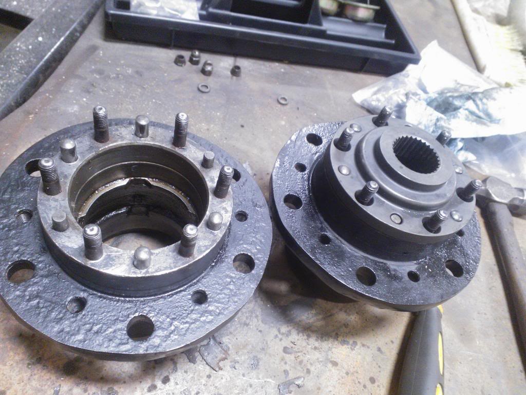

Aaaand I got my hands on some of these 30 spline bad boys and a set of creeper flanges.
temporary_zps785759fc.jpg?t=1388929219

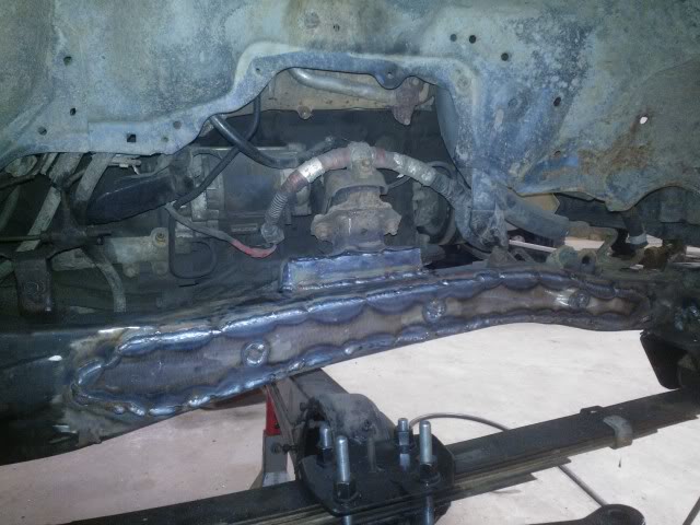

Passenger frame plate and motor mount burned in. When the shock mounts go on, they will brace to the motor mount too. I *may* have gotten a little torch happy in that area.
And drilled out the hubs for the creeper flange pins.
