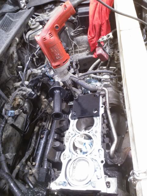

Did a headgasket on my new DD (2003 camry auto 4cyl) which involved re drilling stripped head bolt holes in the block. Now, at 227k its back on the road and running strong.

how did you get access to the toyota tool need to drill out the block?
Didnt go the Toyota route.. I bought a kit from a company called TimeSert. Its like a super duty heli coil. Came with everything from the jig to the drill bits. Even came with a sharpy to mark the drill bits with haha. Highly recommend them. The car also got other things too, such as new timing chain, as the car was still on the original one at 220k
http://www.timesert.com/html/universalheadbolt.html
Thanks for the congrats on the engagement! Were pretty excited about it too!
that is funny cuz i think that is the exact kit toyota uses it. i bet they just order theirs and sent it to us
Thats awesome. The kit was wicked easy to use and got 10k on the engine now and running strong!
