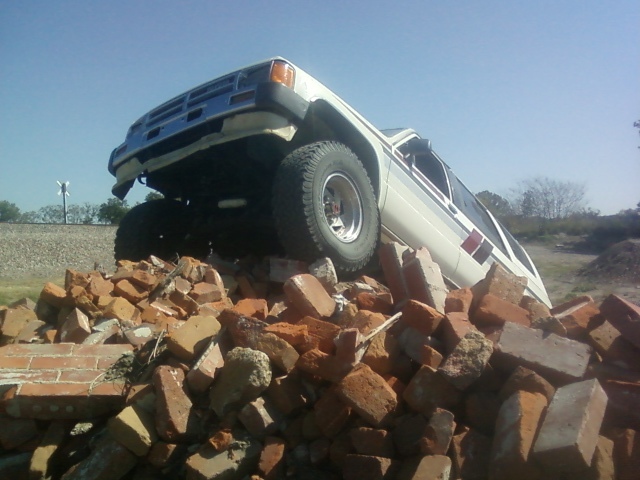

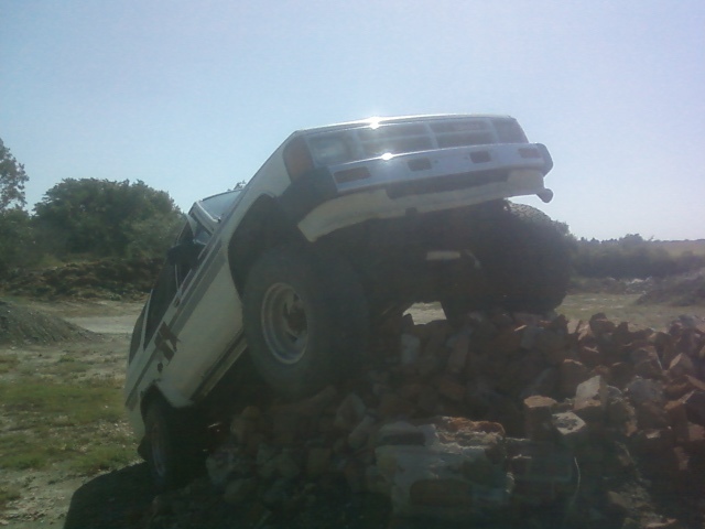

Nice!! I actually think mines ok, just needs the clutch adjusted. Its fall anyways no need for ac for awhile!! I had a great weekend cause i finally gotta wheel the runner. Took my mom out and climbed some stuff she was freakin out. Front locker is workin great. I would much rather have a 5spd over the auto but i just try and take it easy and make it last. The interior is super clean and complete so i would hate to hack out the factory auto console at this point. For a vehicle sitting in a feild for 13 yrs its doin up to par for me.
Awesome buddy. I wish I could have seen your mom freaking out when you were off roading the runner
I would just leave the auto trans till it doesn't would probably be better off road anyhow. Not worrying about drifting back when starting off on a steep angle.
I can't wait to see this thing in person!!
