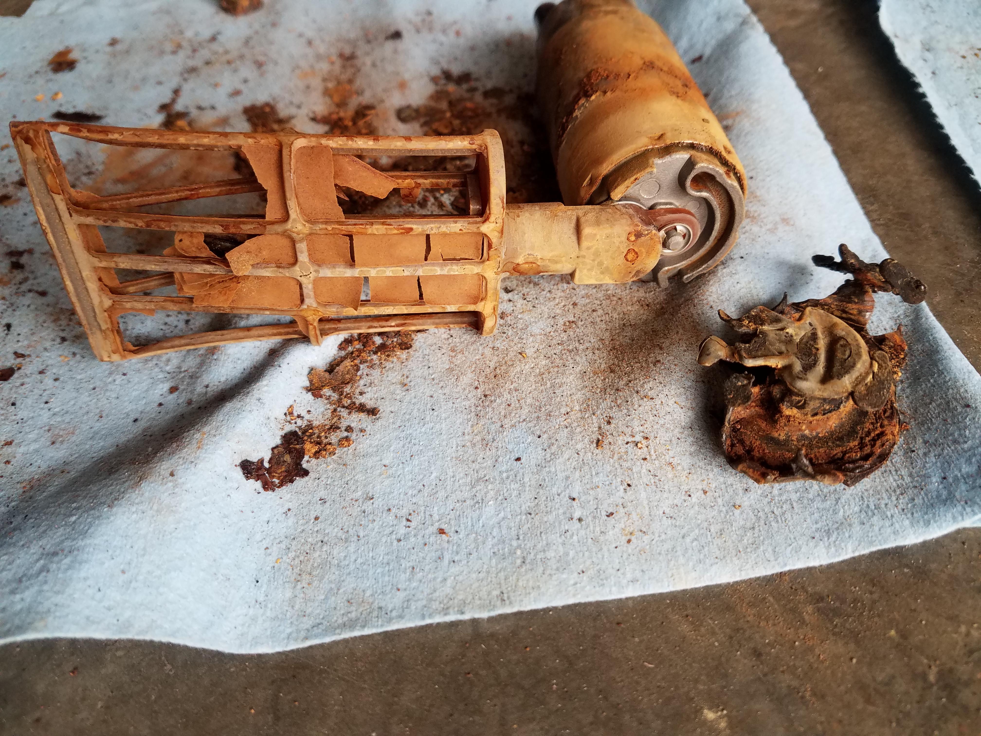

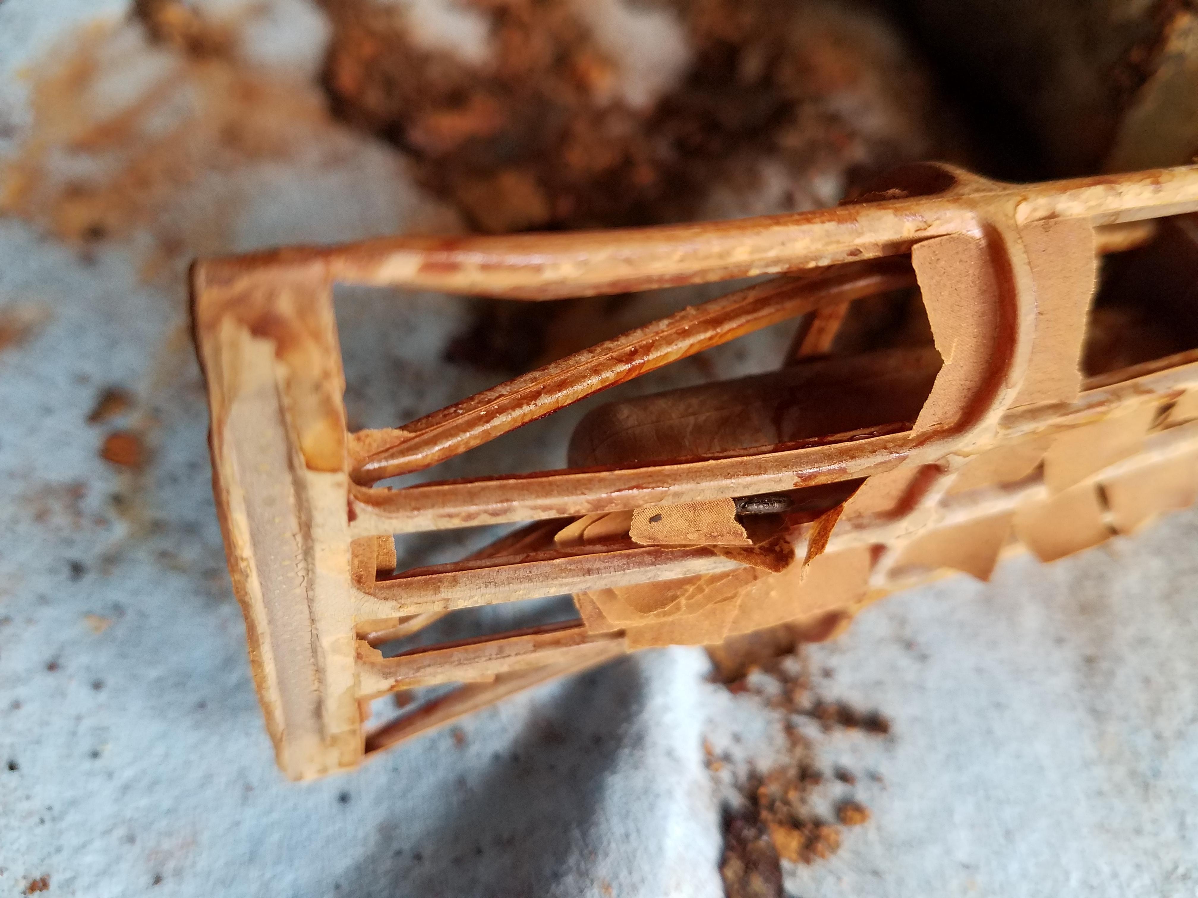

I think I figured out the fuel supply issue...
Pickup clogged with all the old bits of strainer
But back on the road, definitely more pep.

I have been seeing more and more people post fuel pumps that look like yours.
Yuck!

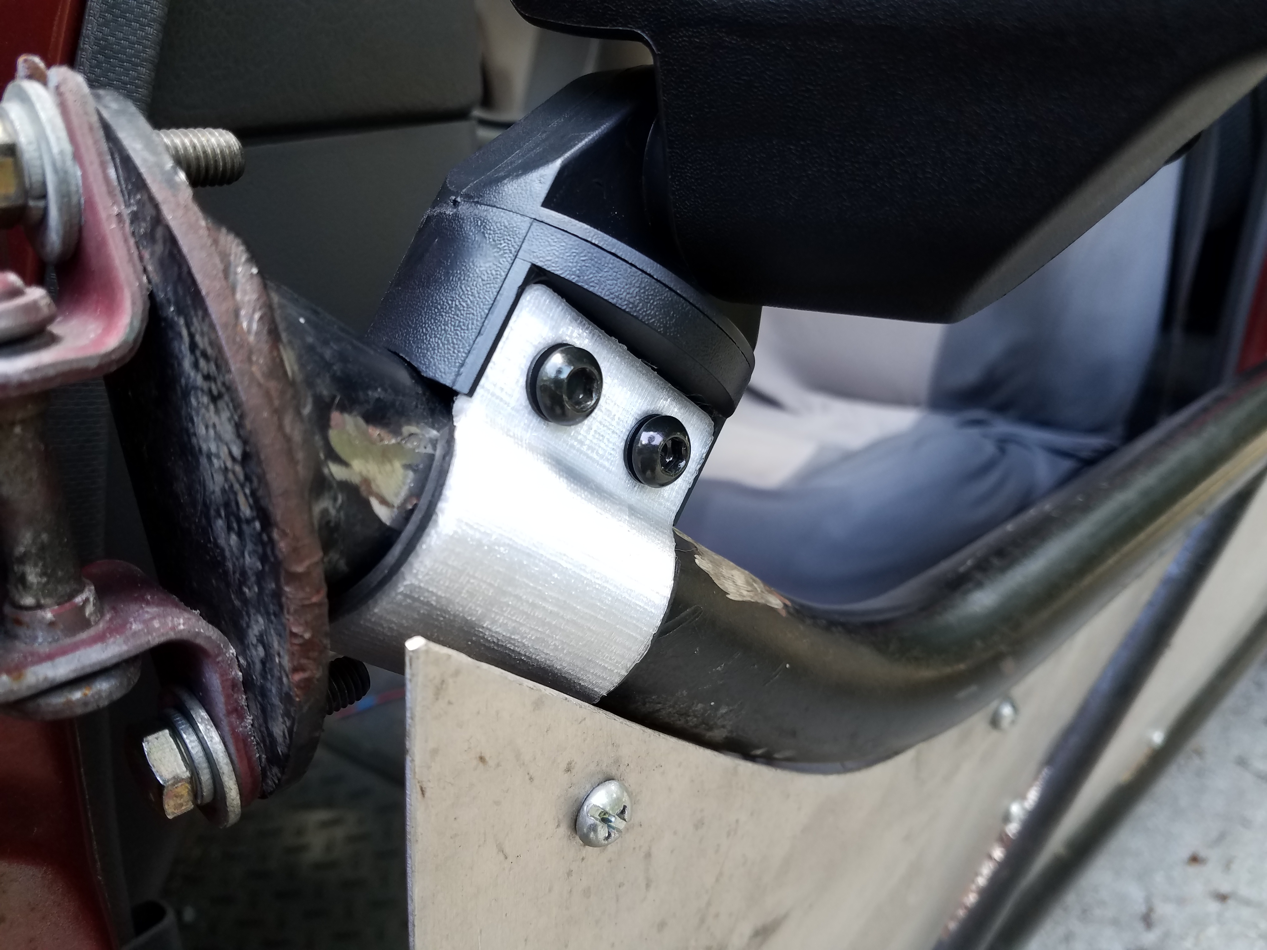

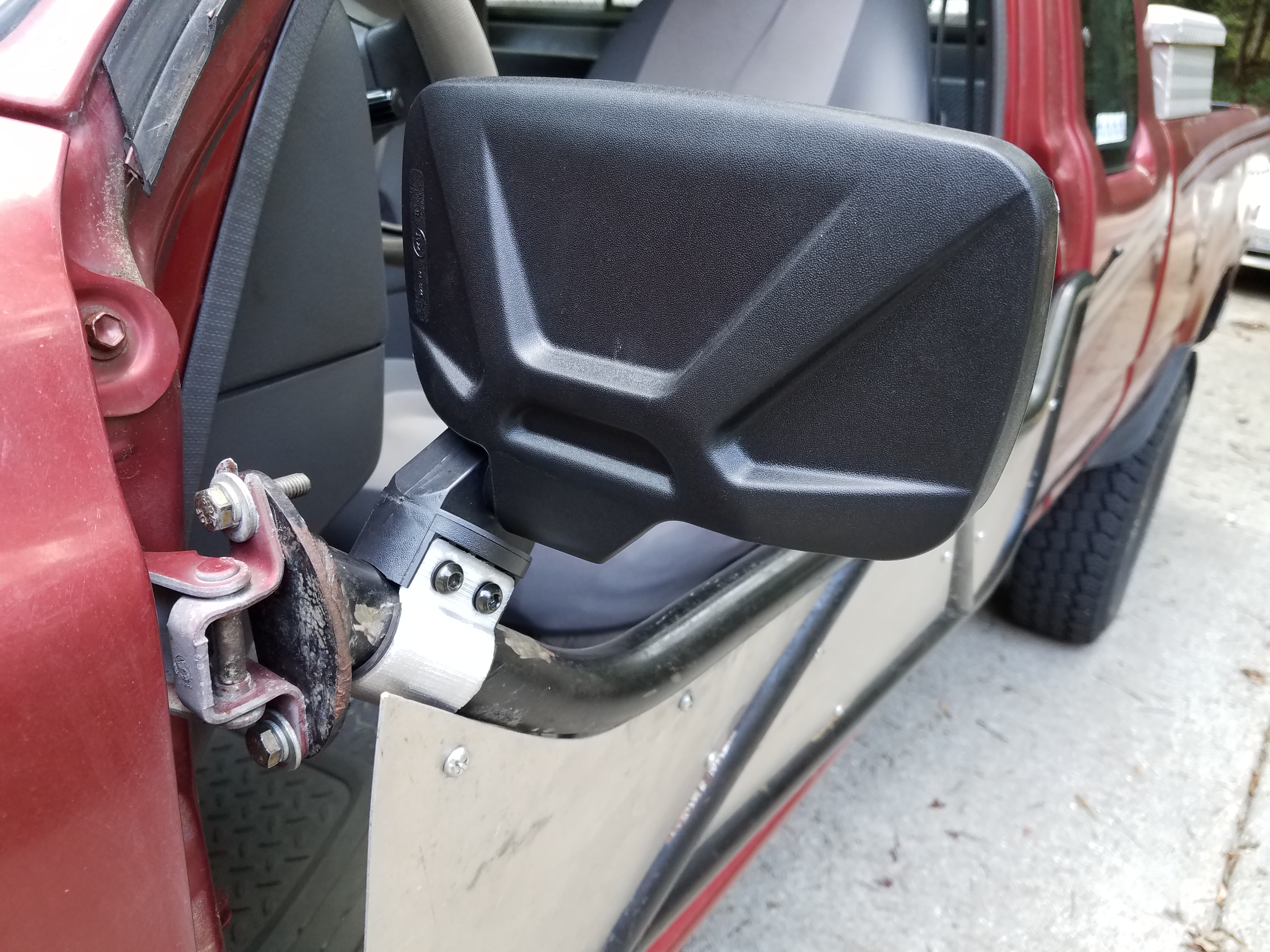

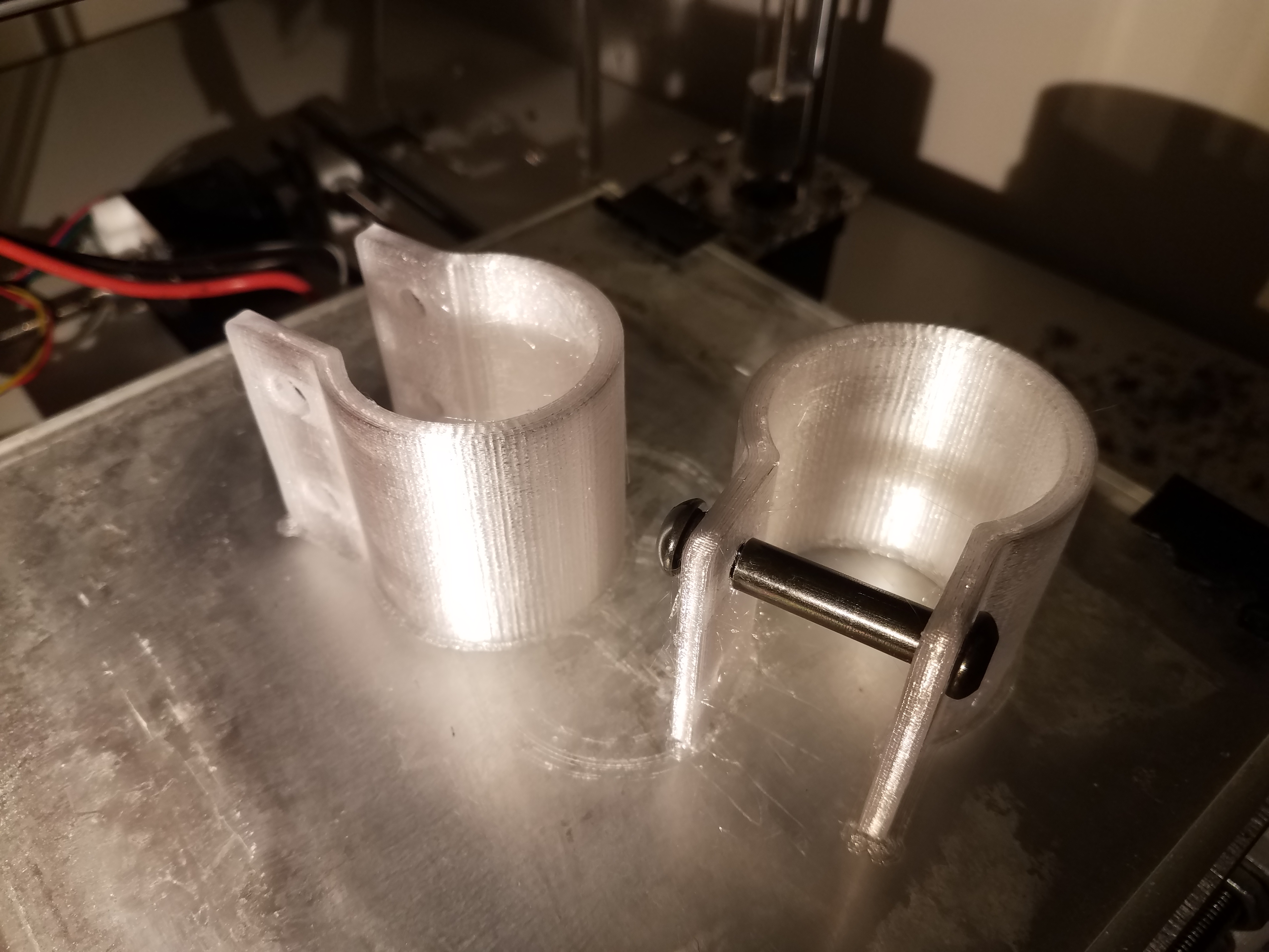

- Designed and printed tube door mirror clamps. The old mirrors broke when I moved and the new ones had clamps too large for the doors. So I made some that fit:
And that's about it. Now back to our regularly scheduled hiatus.

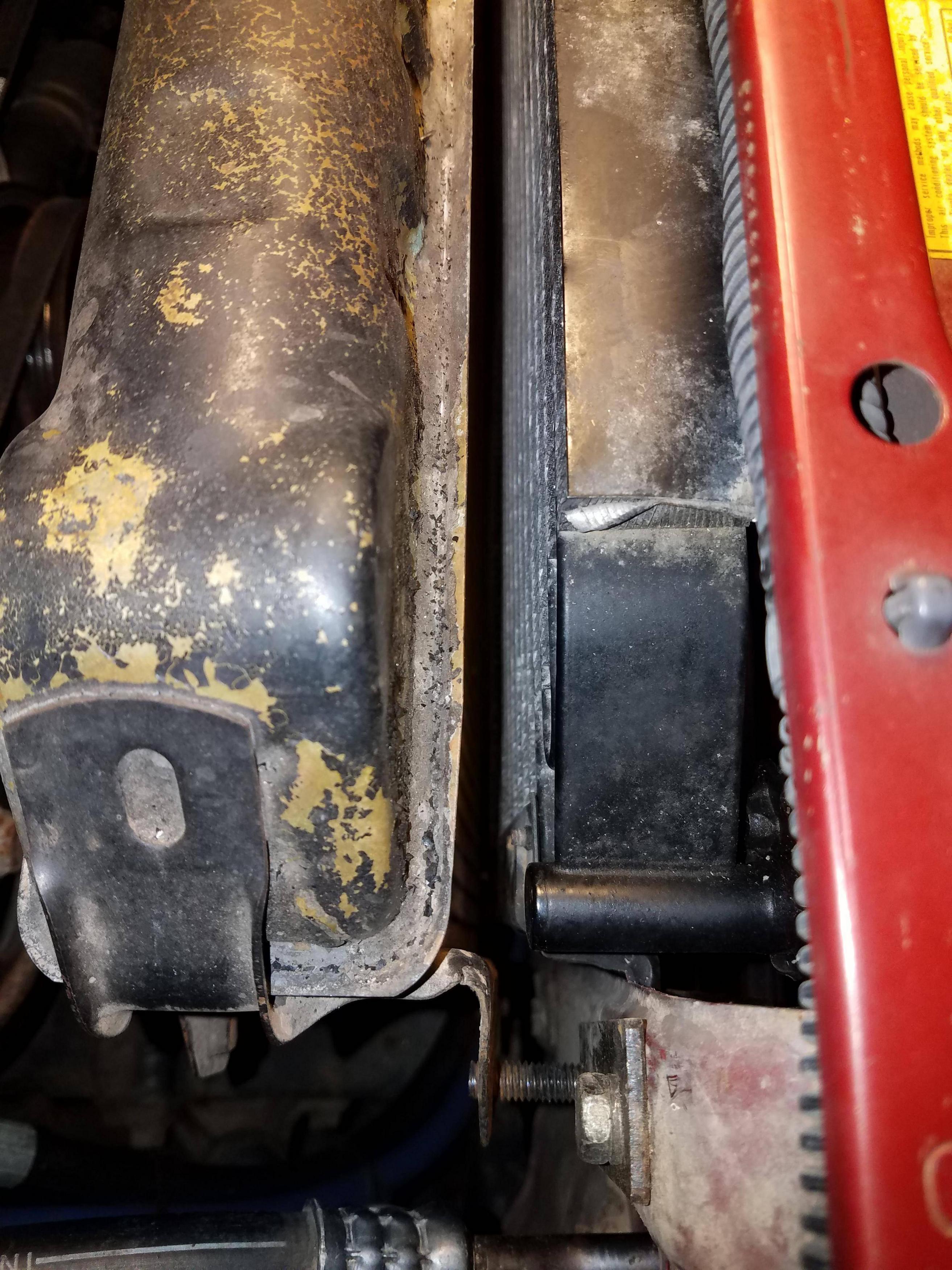

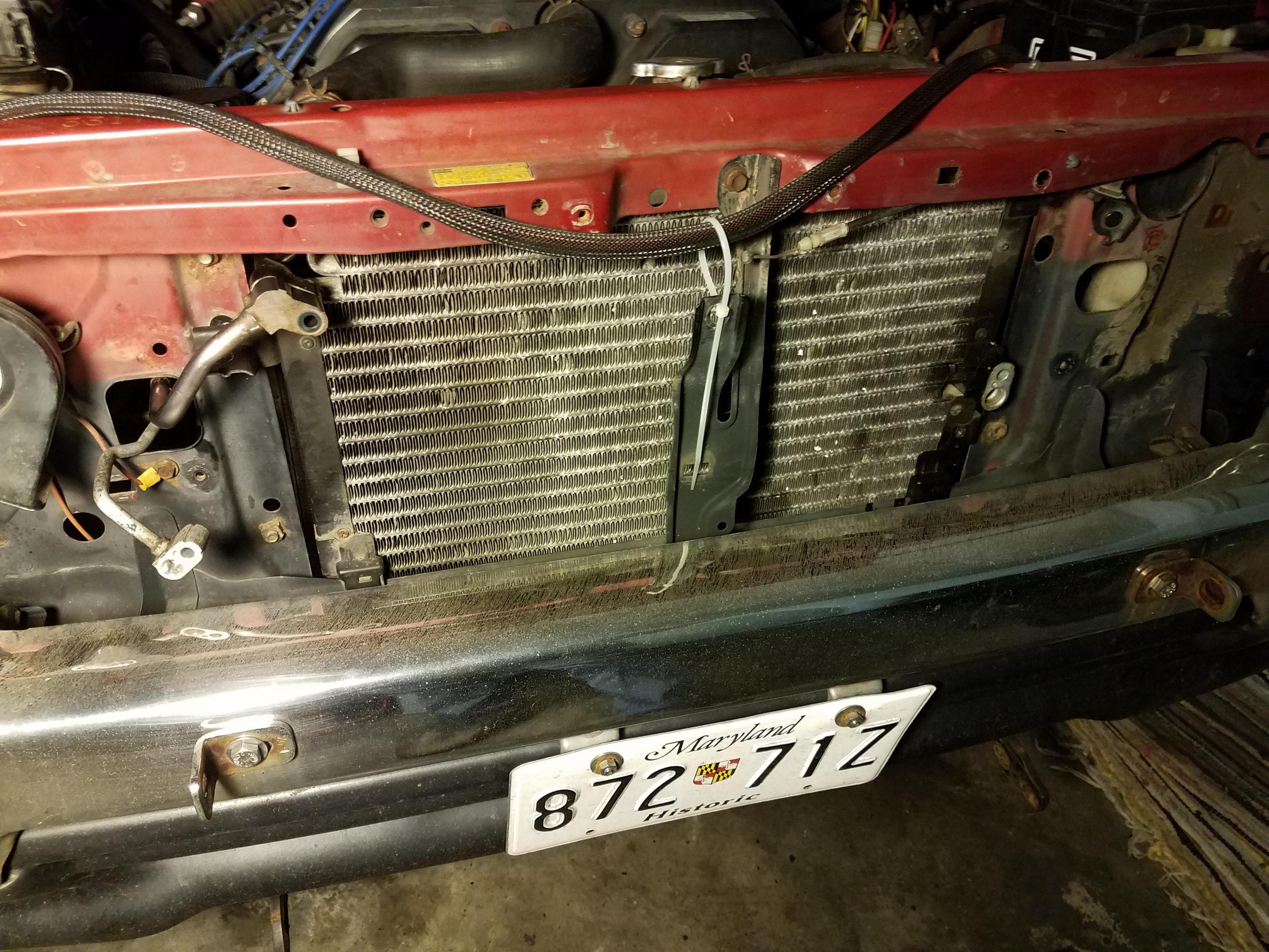

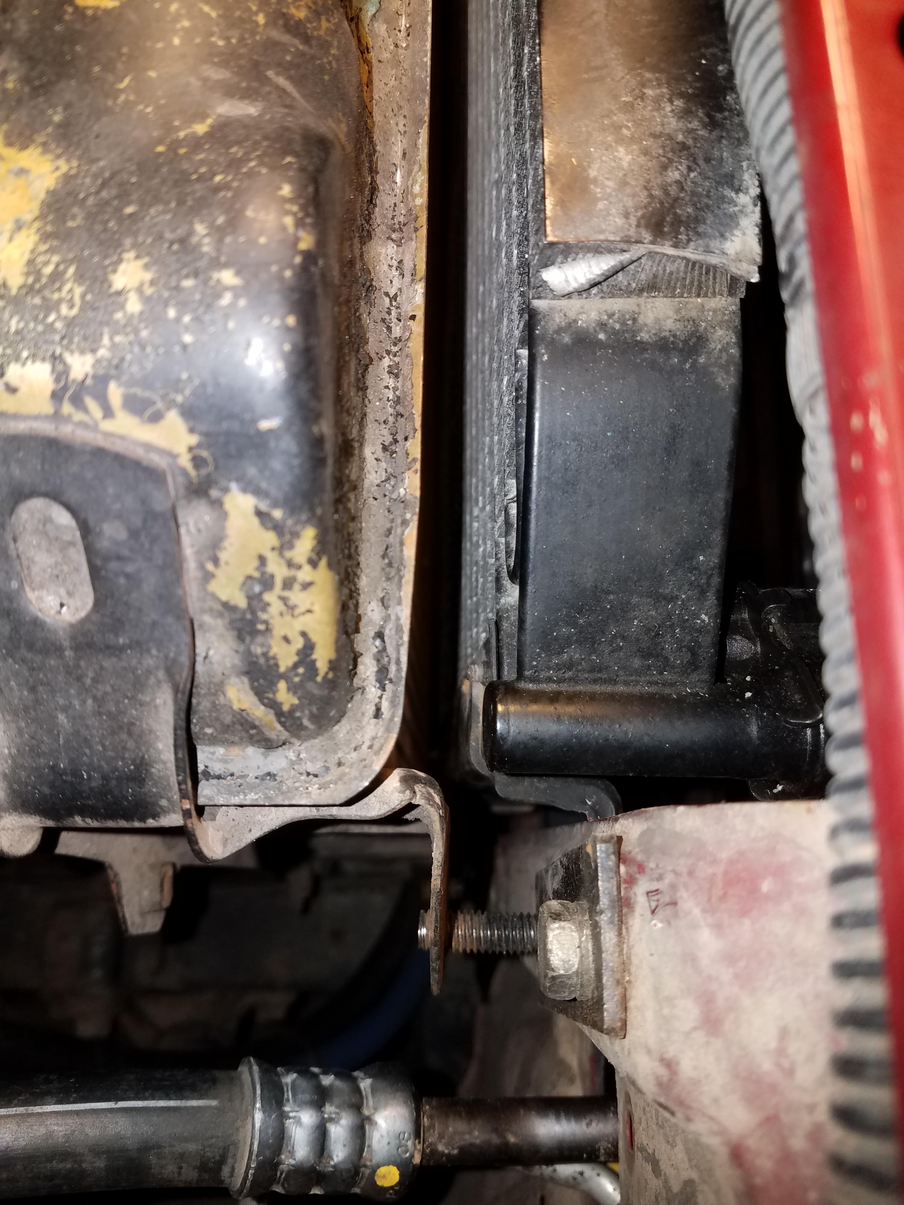

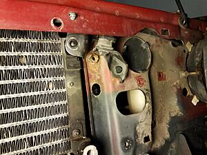

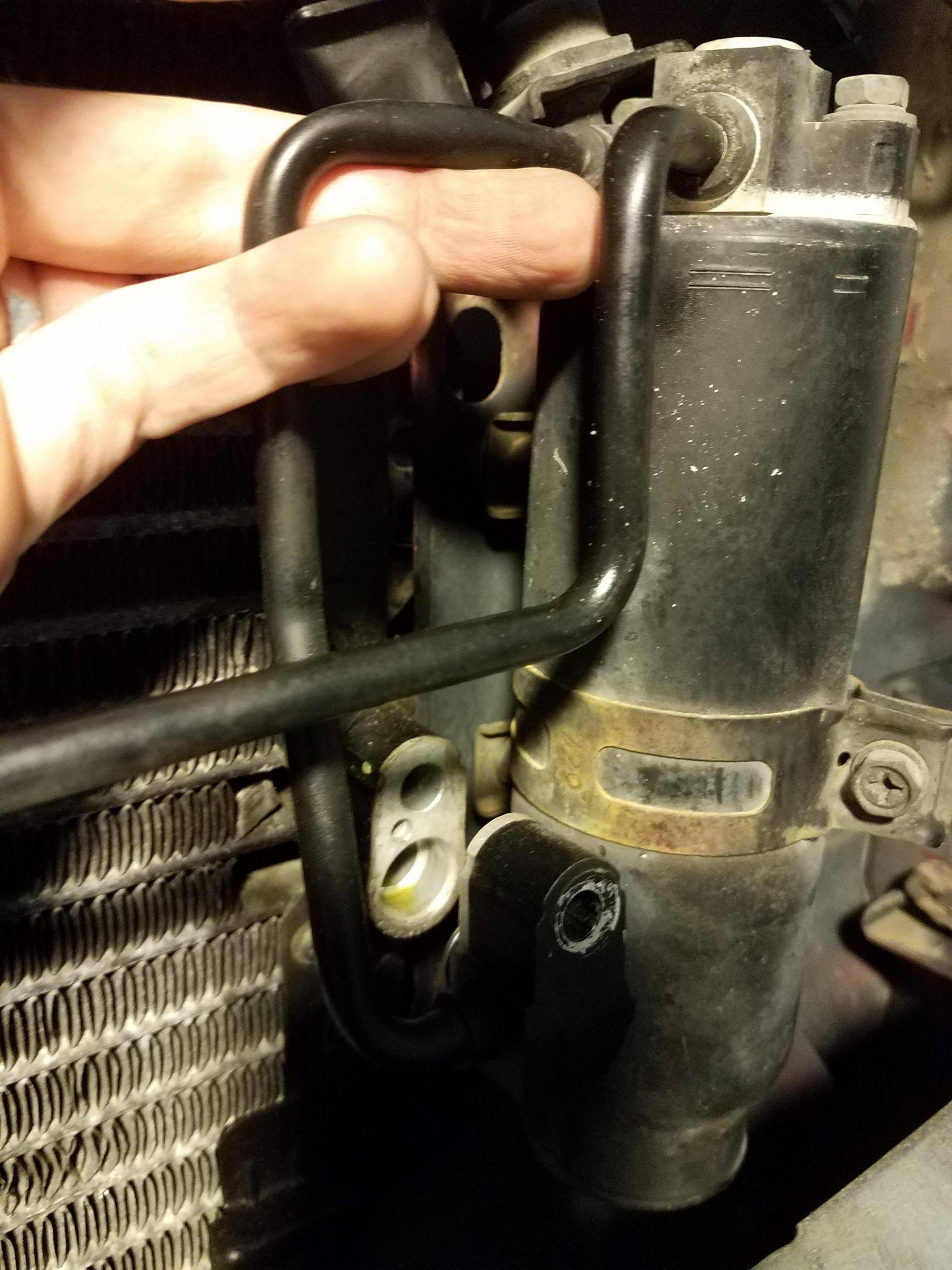

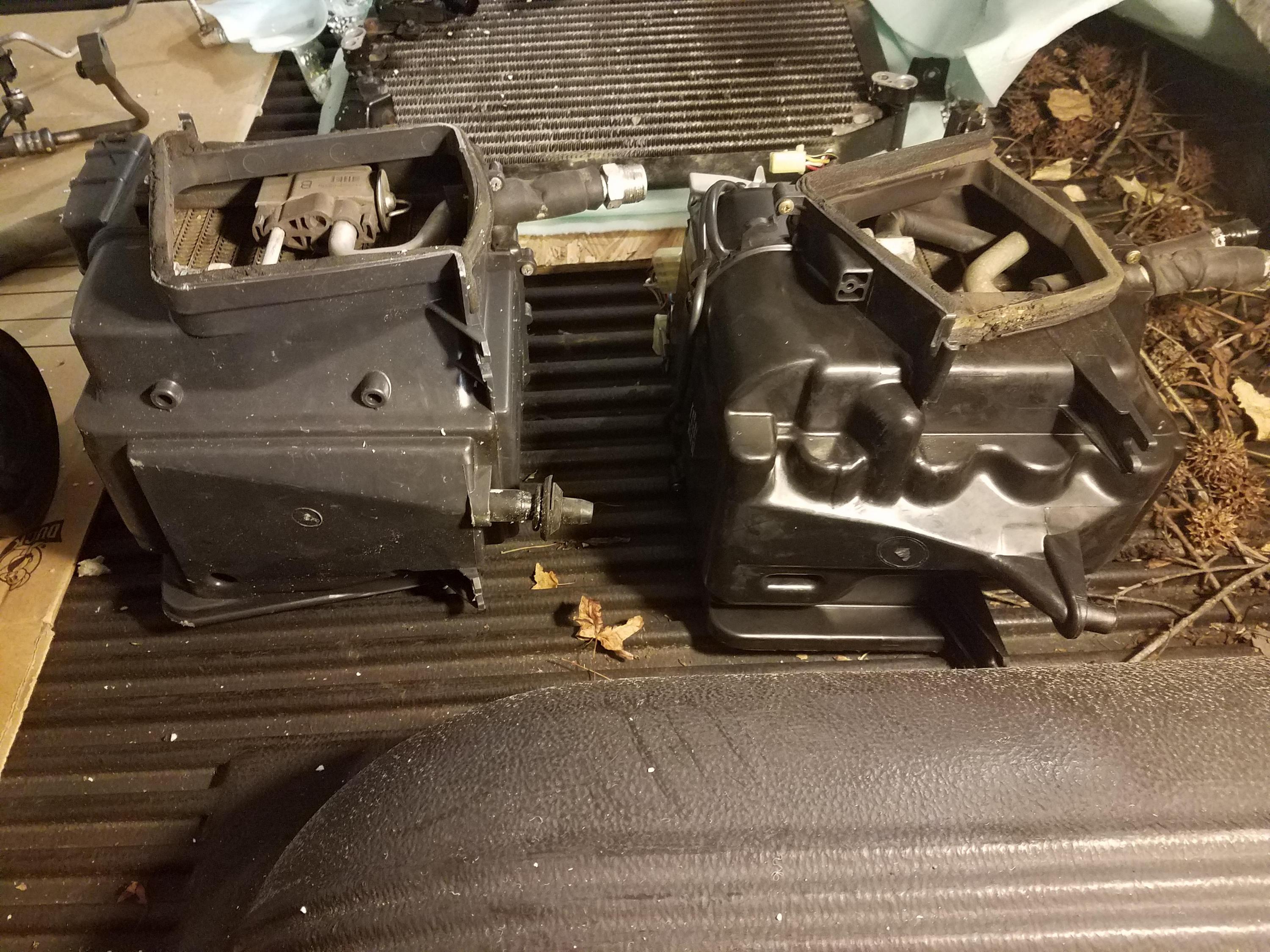

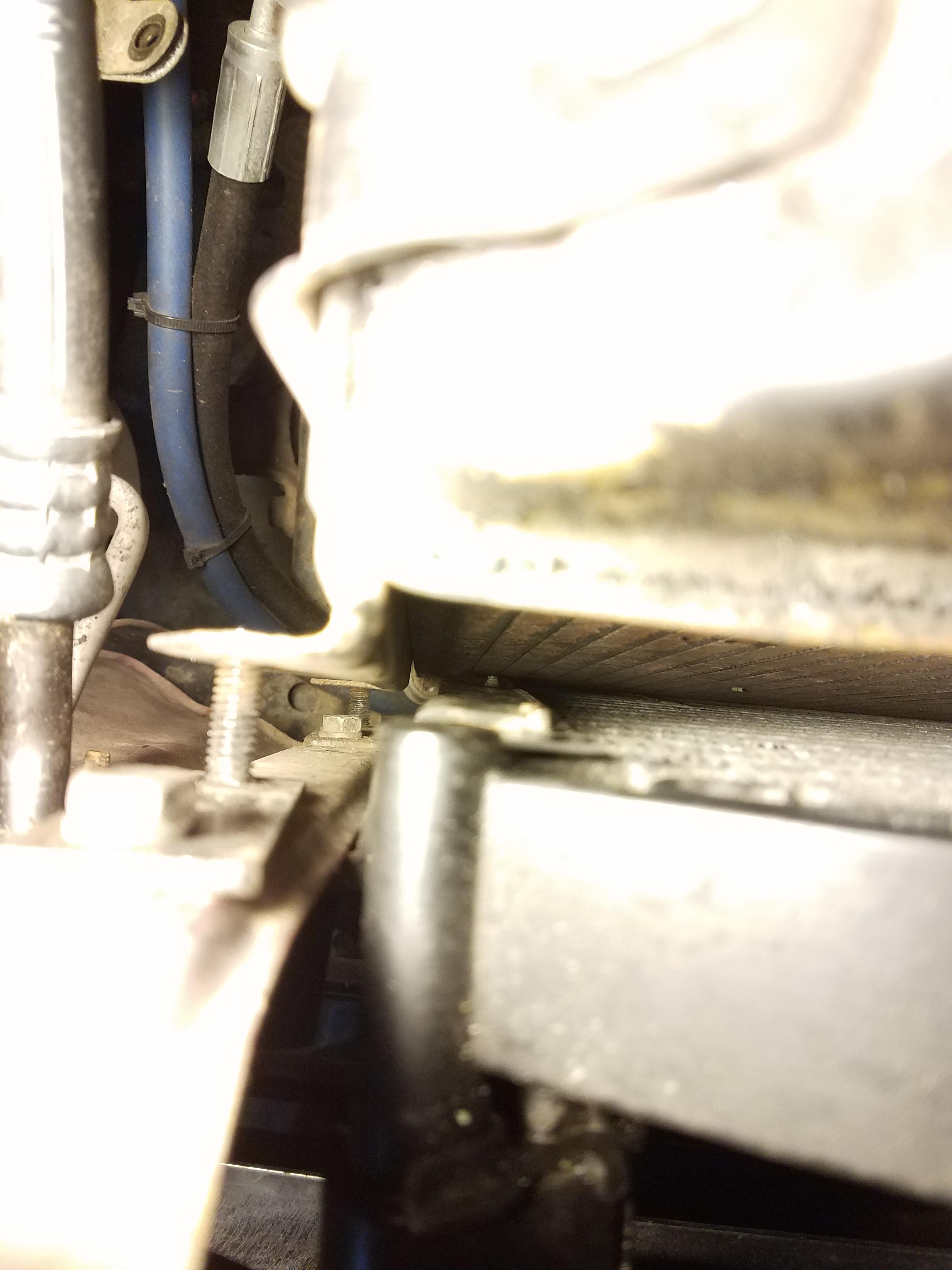

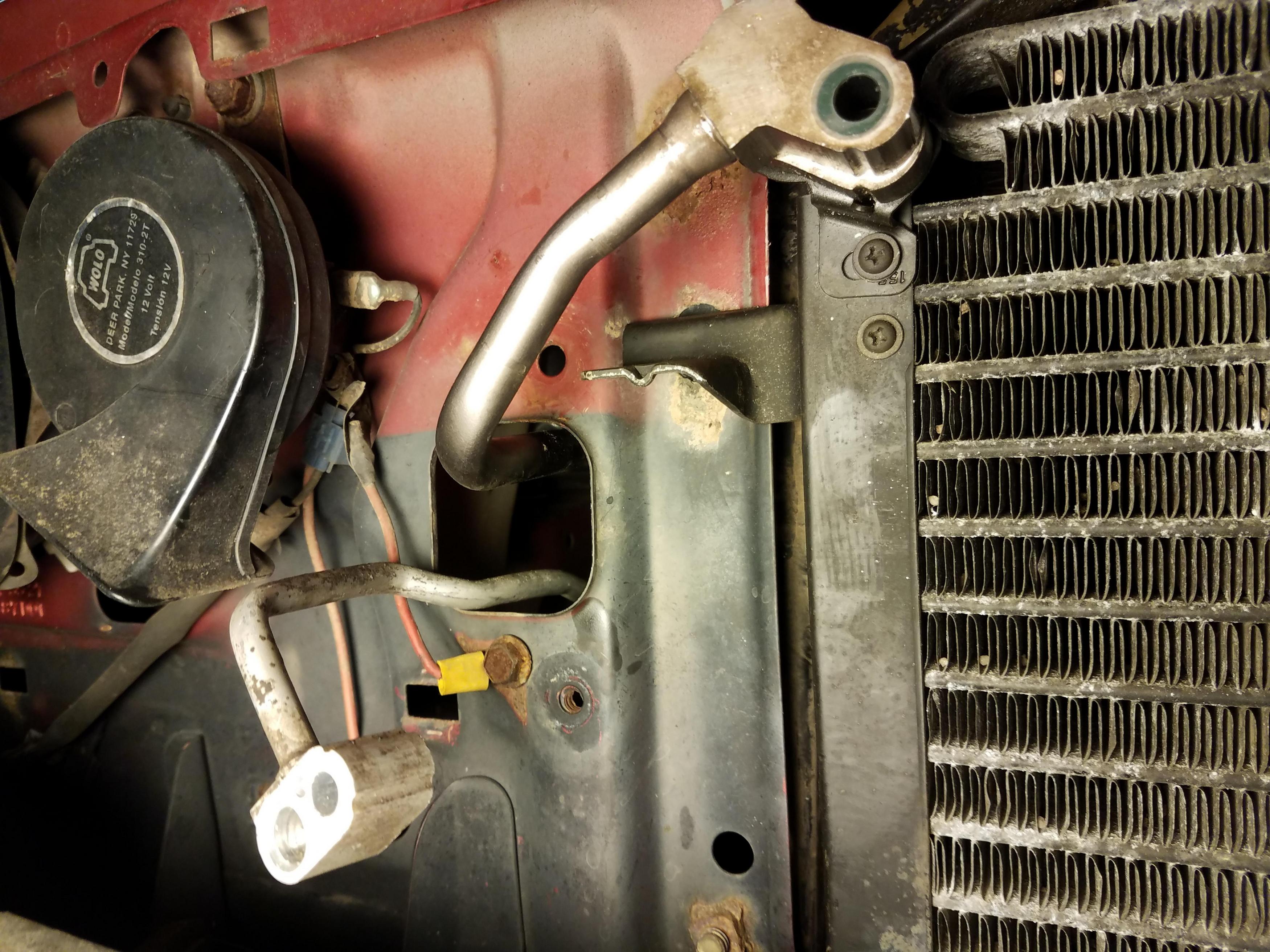

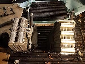

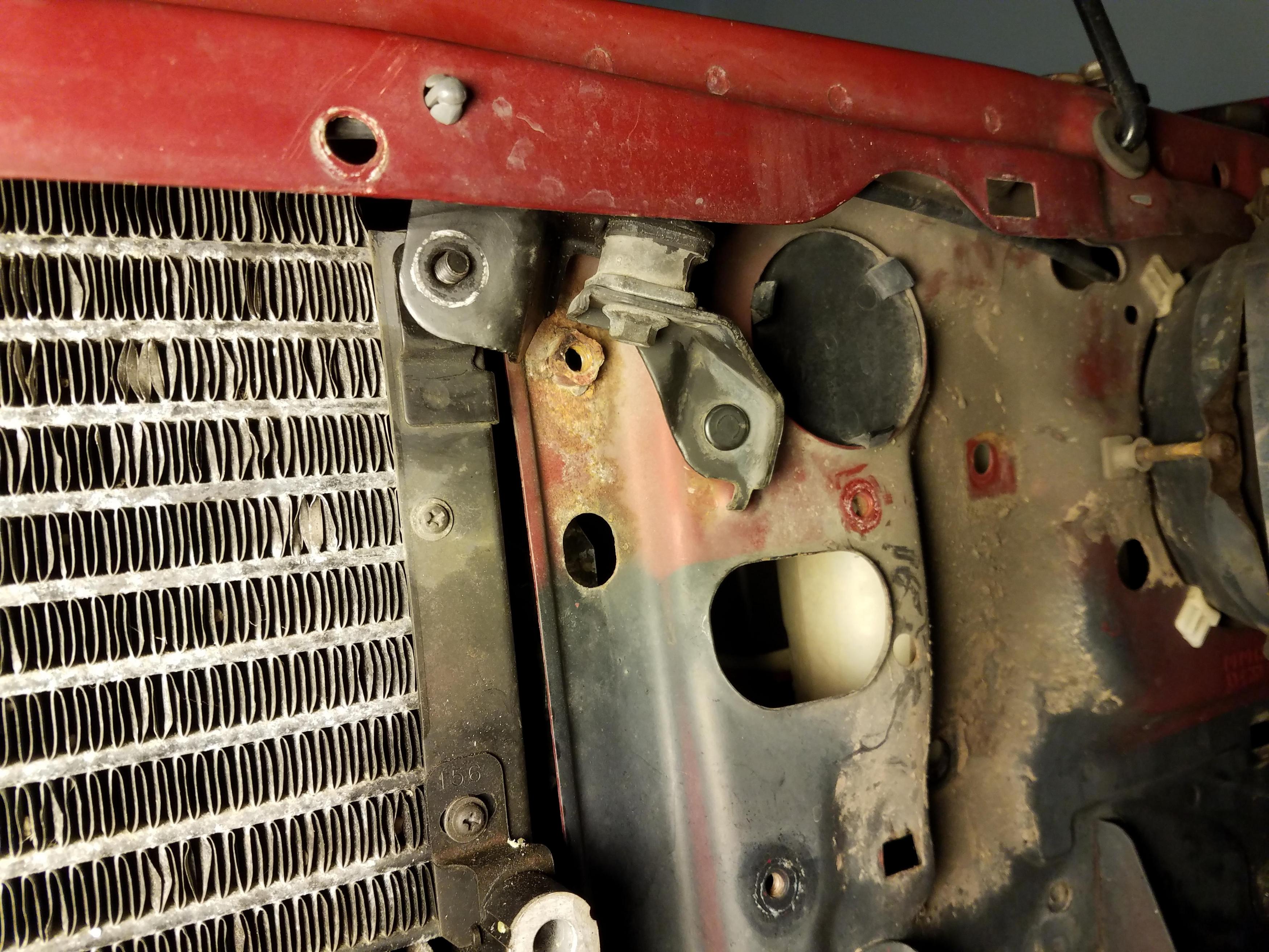

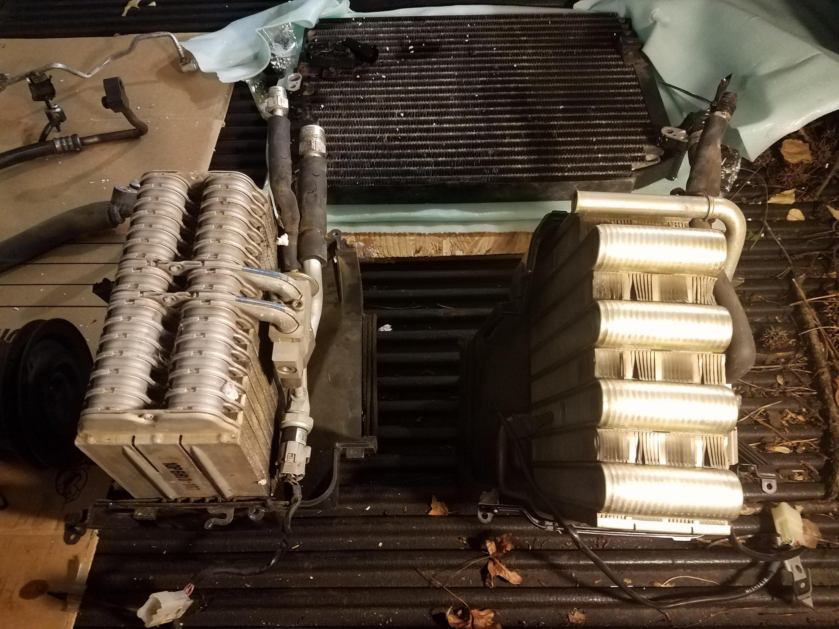

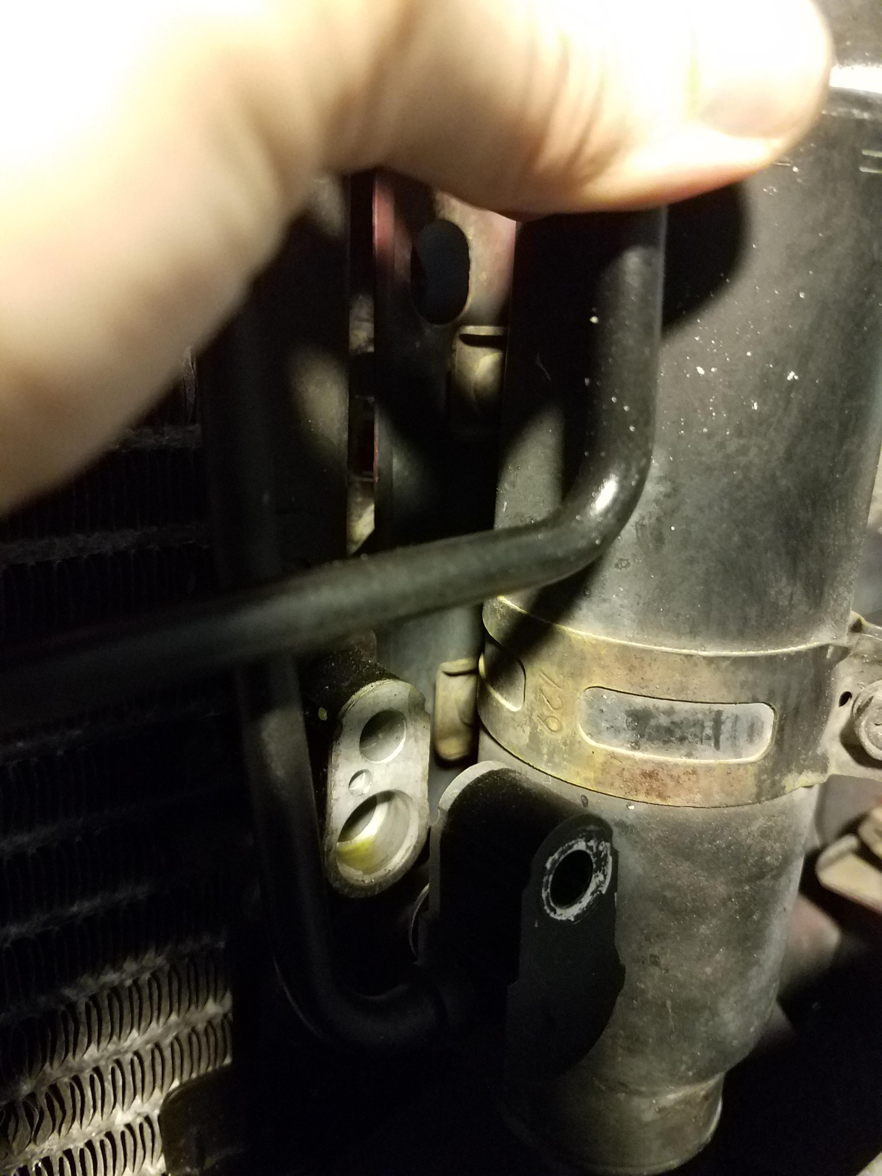

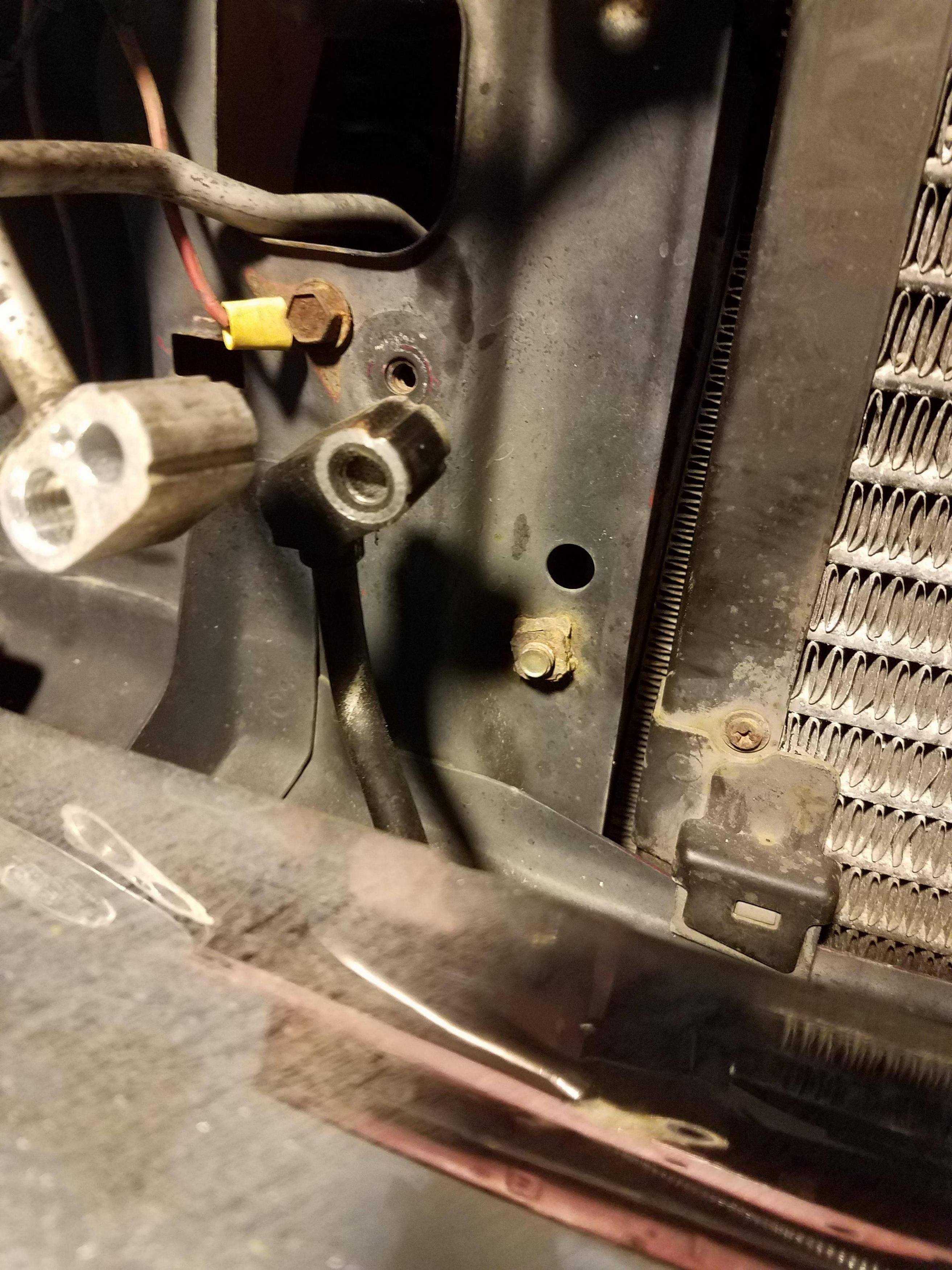

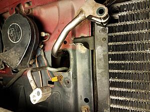

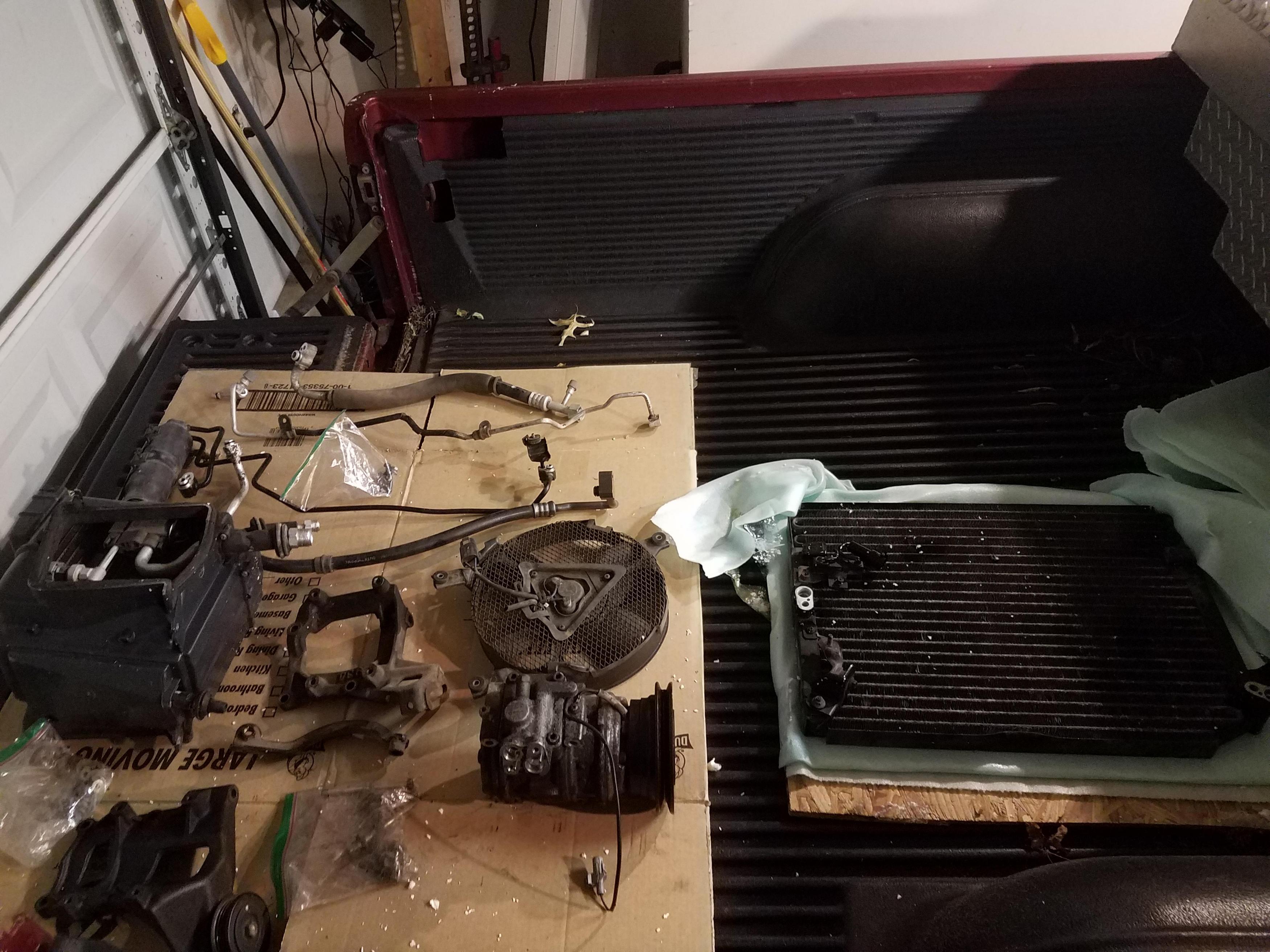

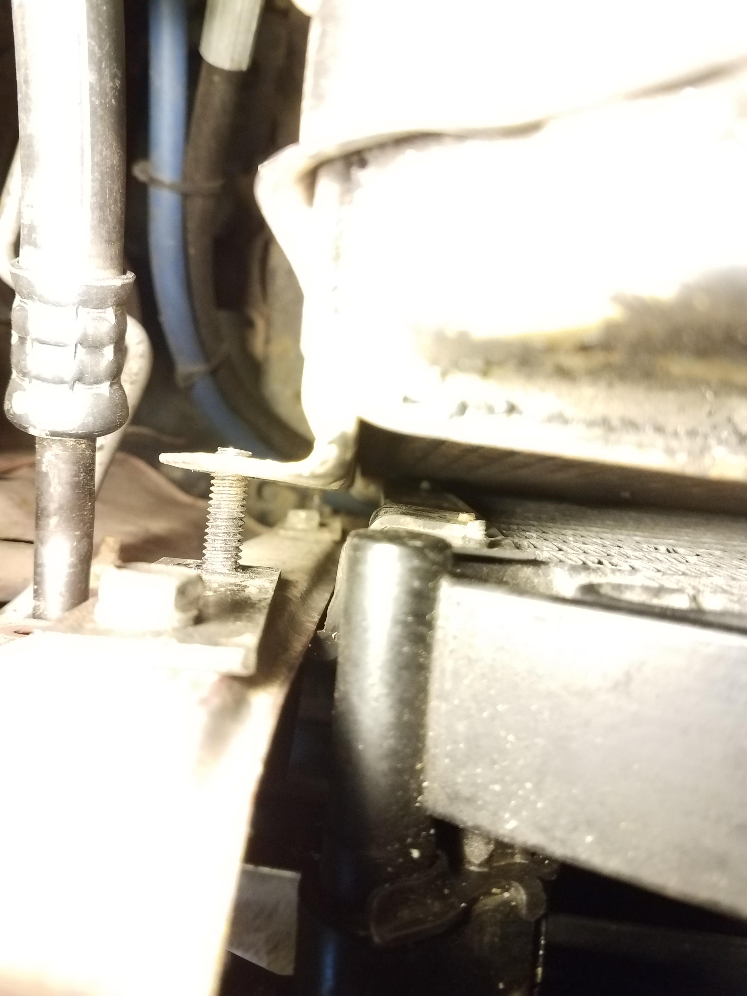

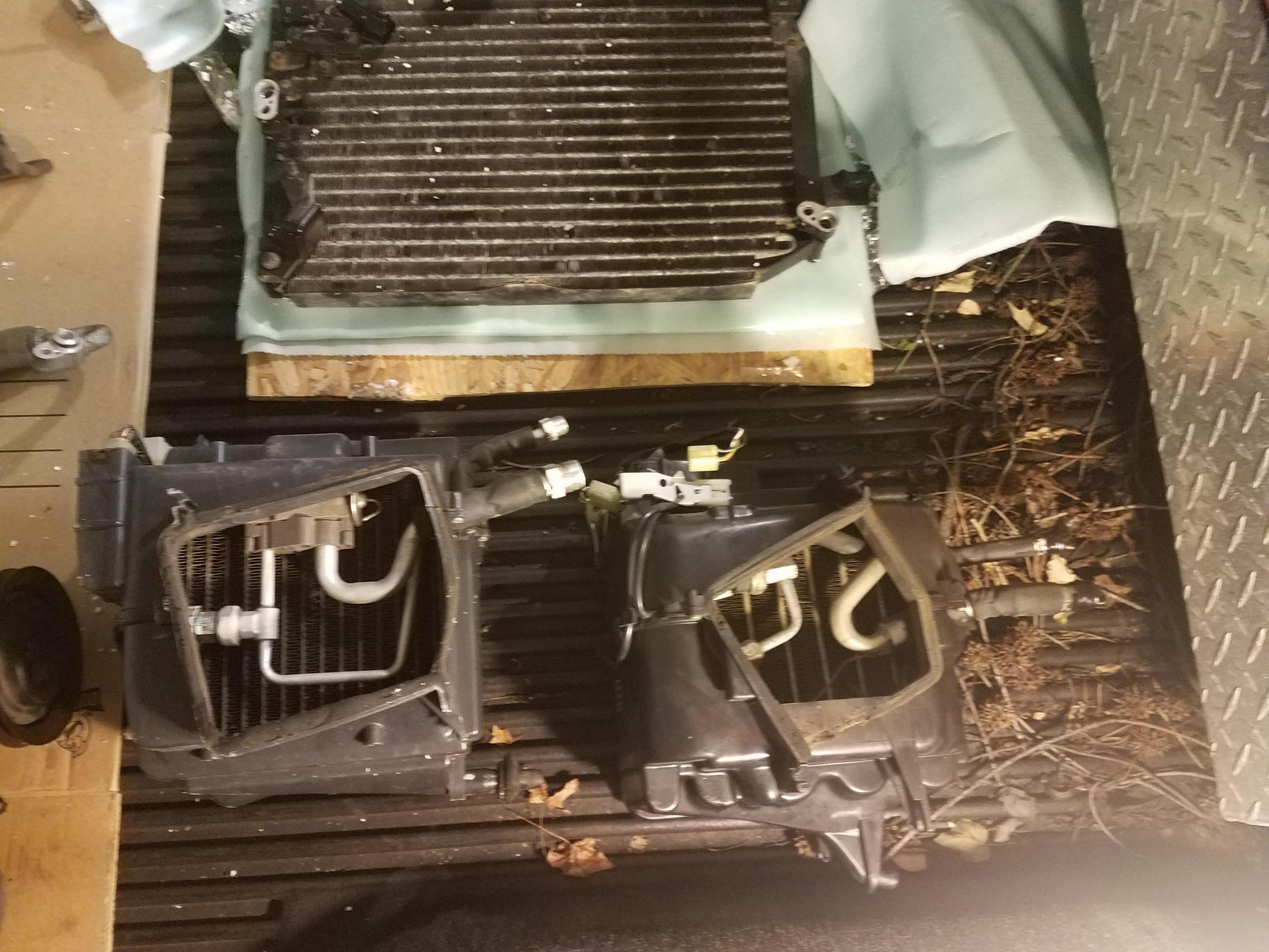

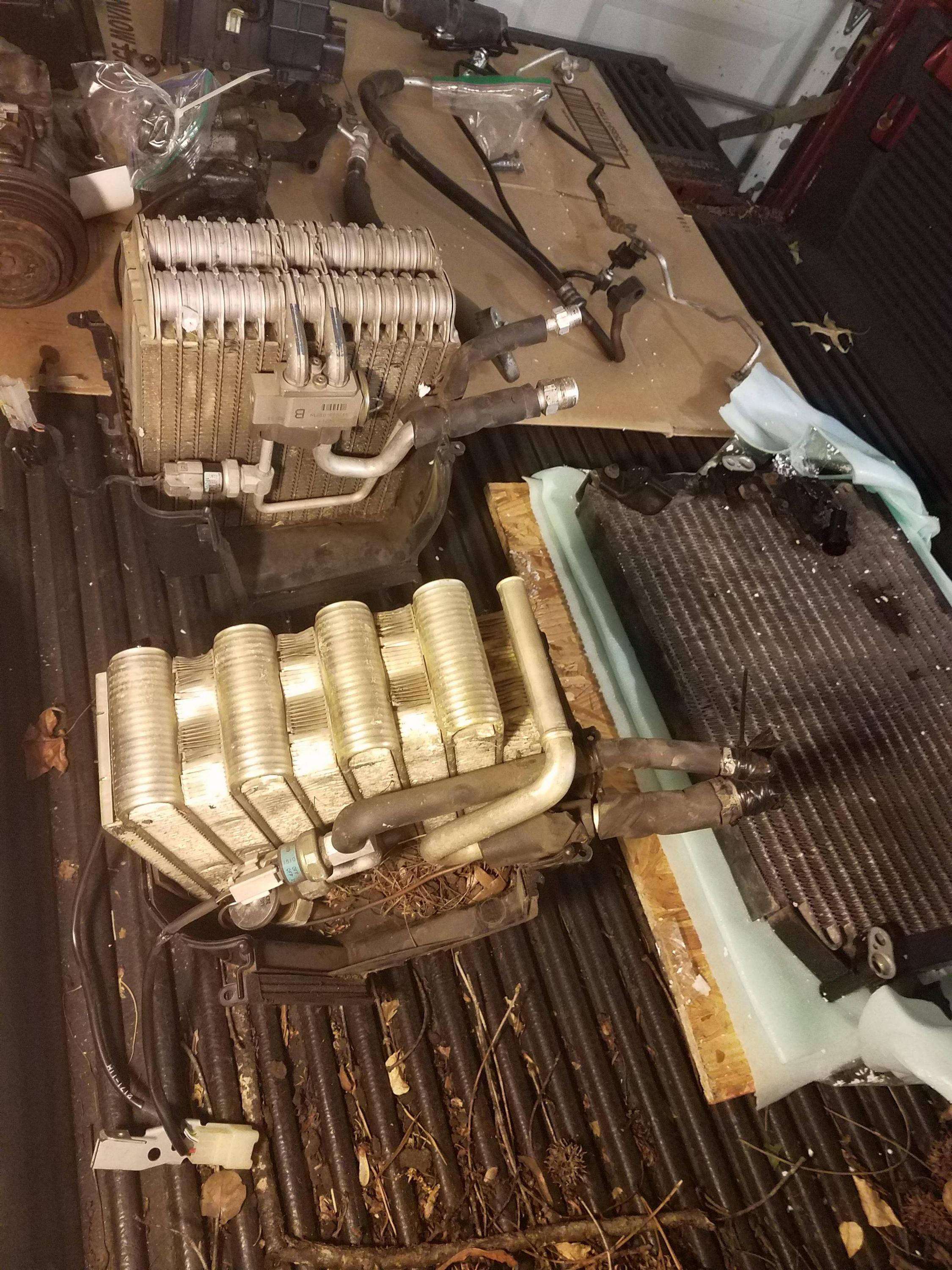

Good news and bad... Some of the stuff fits, some doesn't, and some is almost there...
What fits with no issues:
-compressor
-high-side flex line
-low-side flex line
What doesn't fit, and what I plan to do:
-evaporator: the housing is different, so I'm planning on swapping the fittings from the new one to the old one, if I can find my brazing equipment
-high-side hard line: it fits, but doesn't line up with any holes in the front core. need to cut a hole.
-drier: bracket has no holes, need to drill baby drill
-evaporator: too far back. I don't know if I should cut into the core support to move it forward, but it's hitting the radiator as it sits
-fan: pickups didn't come with fans, so there's no provision for it. I'll probably end up modifying the housing to smash it in there somewhere
Lesson: 4runners and pickups have much different AC systems, m-kay?
pictures time:
4runner on left, pickup on right

After sleeping on it, I'm going to modify the system to fit. It's a few small things, but should work fine. First, I'm going to cut the bottom of the core support in a half-inch and re-weld the lip on for the condenser to sit. If I rotate the drier bracket and make mounting points for it, I can keep it from pushing too far forward. The evaporator will be re-used, but the connectors are stripped. I'll find a way to attach the good fittings from the '95 evaporator. And for the hard line from the drier to evaporator, I might either make a new one re-using the fittings, or look for a soft line alternative. I think that covers all the major issues, but I'm sure more will arise.

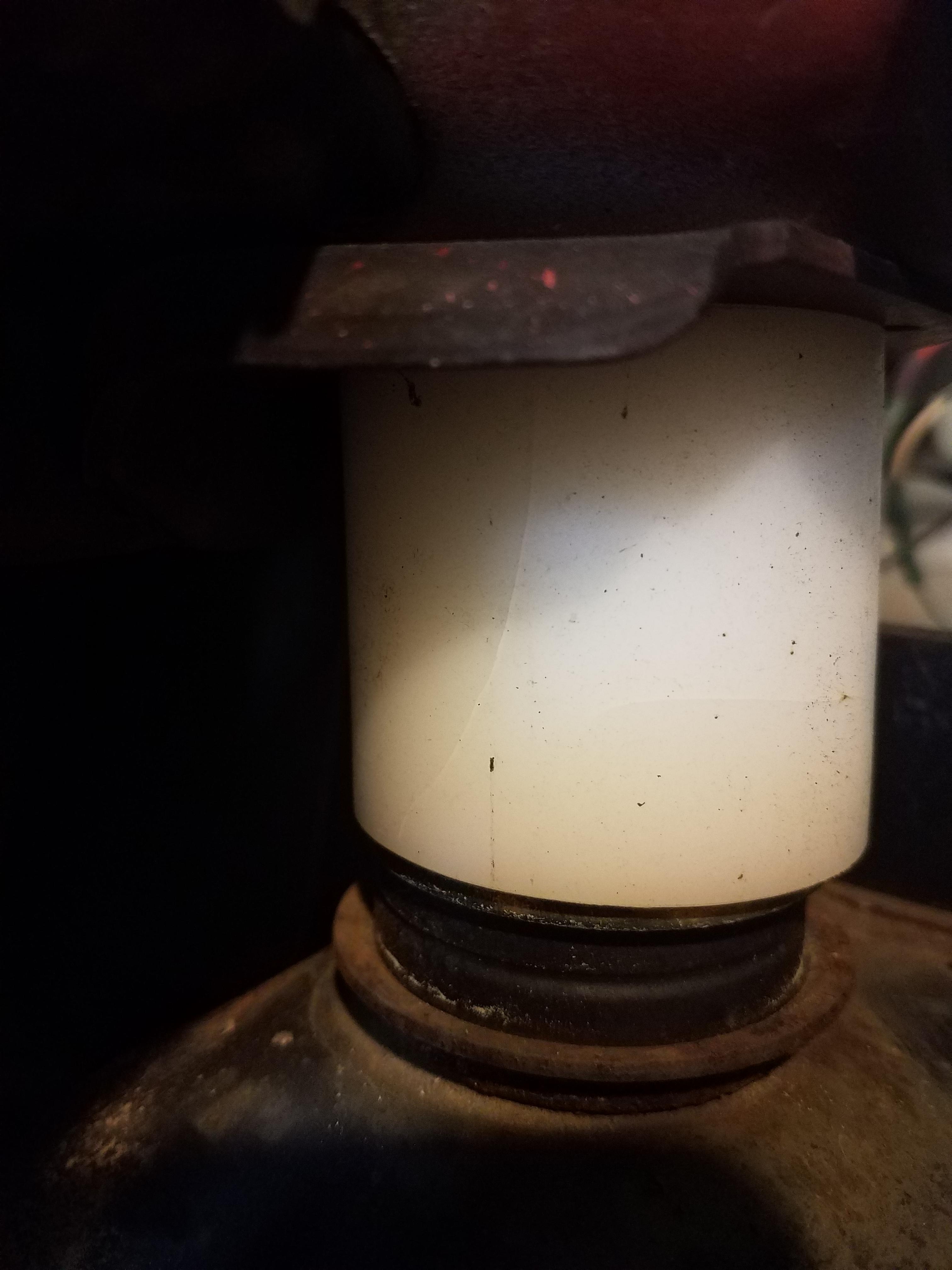

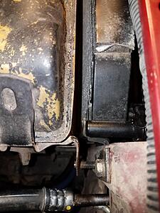

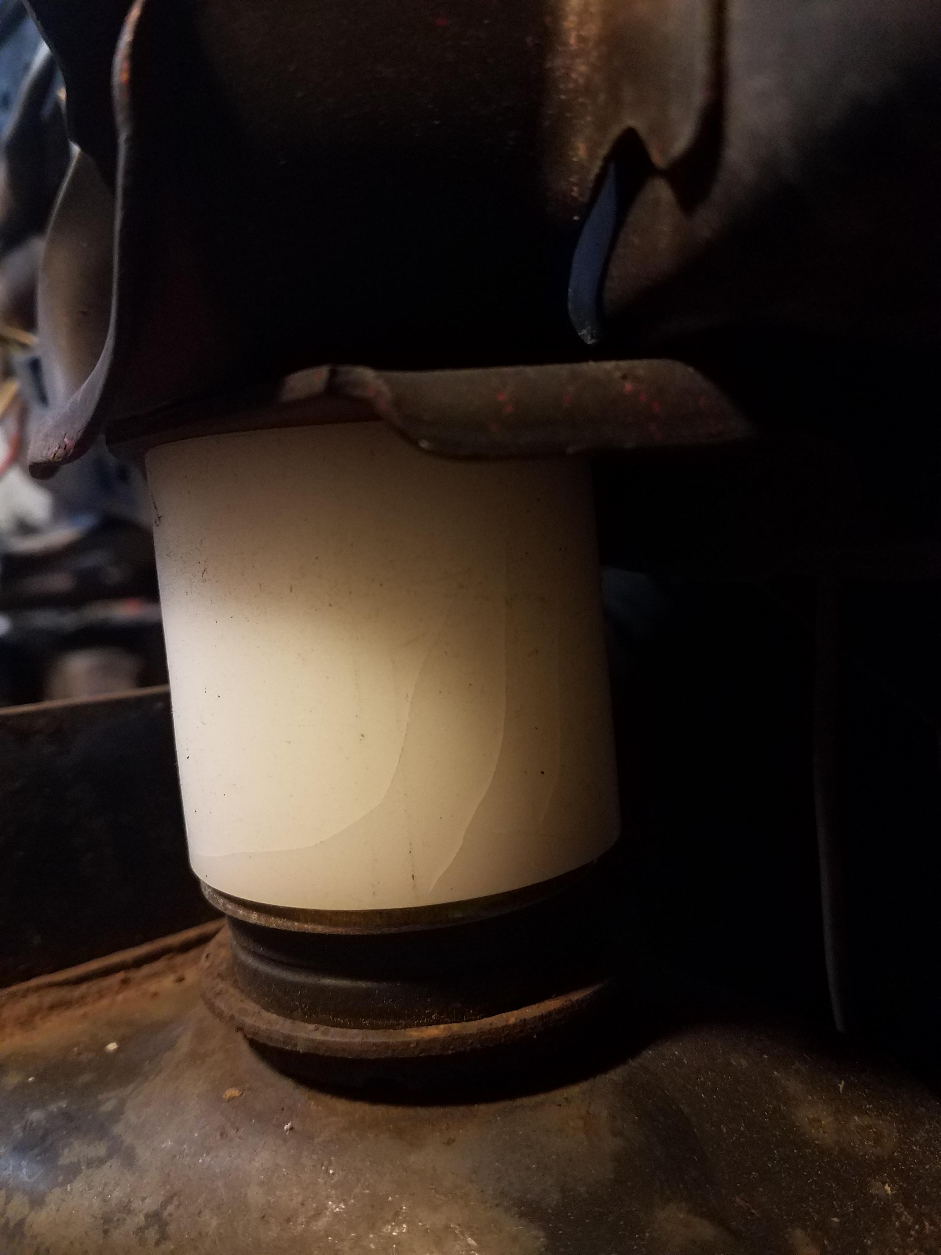

Also found this: cracking body lift. Probably not too safe? It's a 2 inch 4-Crawler kit.

How old is that body lift??? I just ordered a 1 inch body lift from 4crawler so I'm wondering how long it will last now.

I put it on when I did the swap, so about 6 years old. I want to do something different for the body lift; either move the mounts up, lower the body, or... blocks and braces? Not sure yet. His aluminum kit might be better, especially for long term.

anyhow, I notice my lift is also doing the same thing, and it’s also a 4Crawler. Probably a good idea to replace them, but as long as the bolts are good should be safe.

I'm not 100% sure the bolts are fine. I had to tighten a few of them. McMaster-Carr has SAE equivalents in grade 8, so I got a bunch of those.
